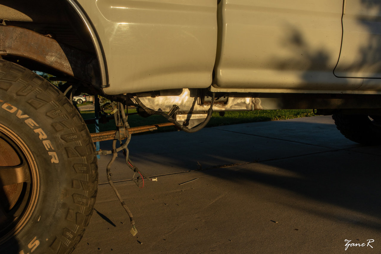

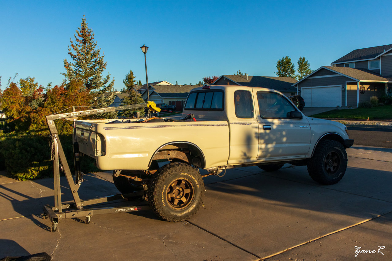

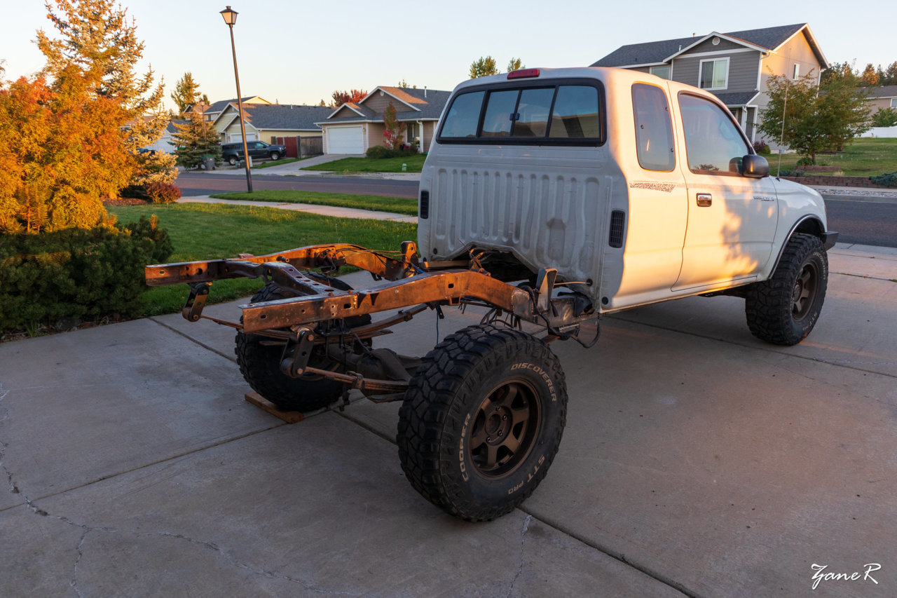

    Dan while you're around this evening, where did you locate your rear hangers for the 63s. I guessed and I'm close I think but not sure.
    Mine are right below the rear bumper bolt hole.
    Also does this look about right for the forward hanger?

    I can pull some measurements for you tomorrow, that all looks correct though. With some weight on the springs I’m at 45 degree shackle angle, yours looks like it’ll be right around that.
    I’m interested to see how the johnny joints do during medium and high speed maneuvering (or are they orbit eyes?)
