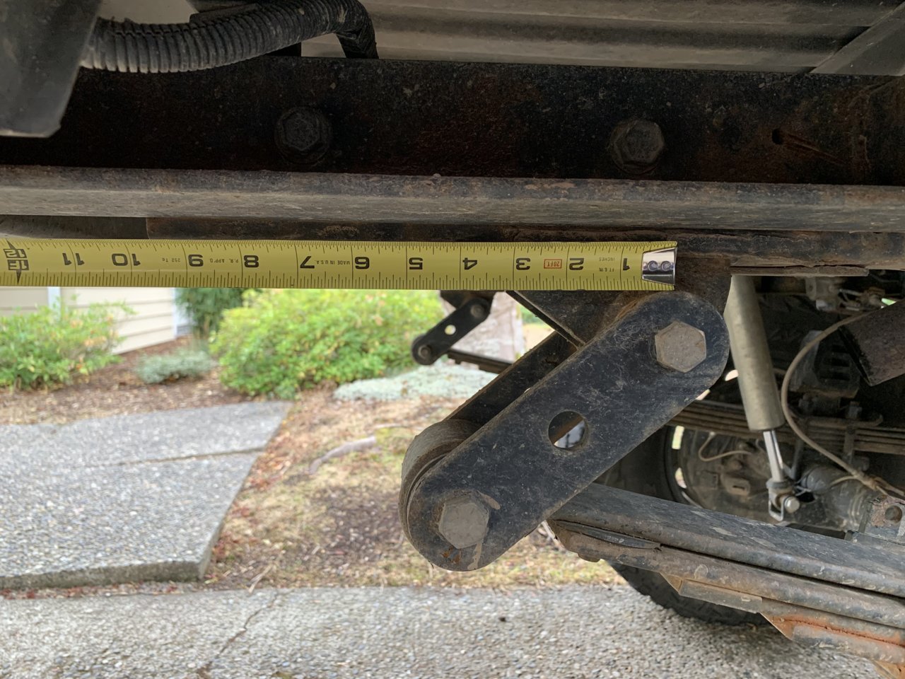

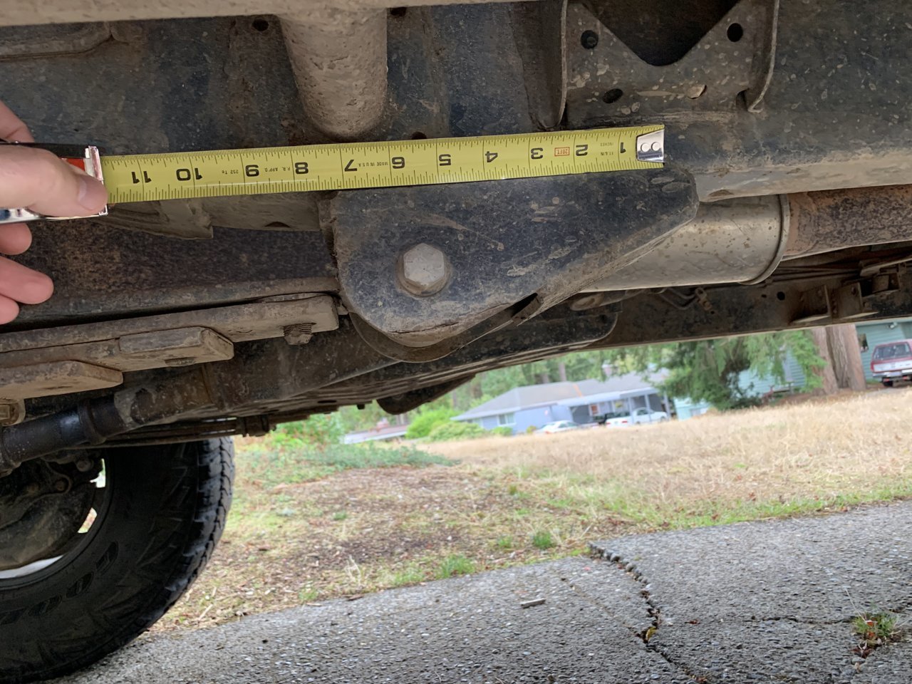

    From center of the upper shackle bolt to the end of my frame is 9.75”, from the center of the front hanger bolt to the center of the rear cab mount is 5.5”. It looks very similar to yours.

    You're the man Dan! Thanks for doing that. I wanted to be sure before I went and did something stupid... not excited about cutting into the frame to french in the mounts but I do want to do it to avoid the extra height. But making sure I have it all right is tough haha.

    I hear ya, that’s a bit of a pucker moment. I do wish I had frenched it in, and may go back and do that at some point. It’s pretty stink bug until I load it up.
