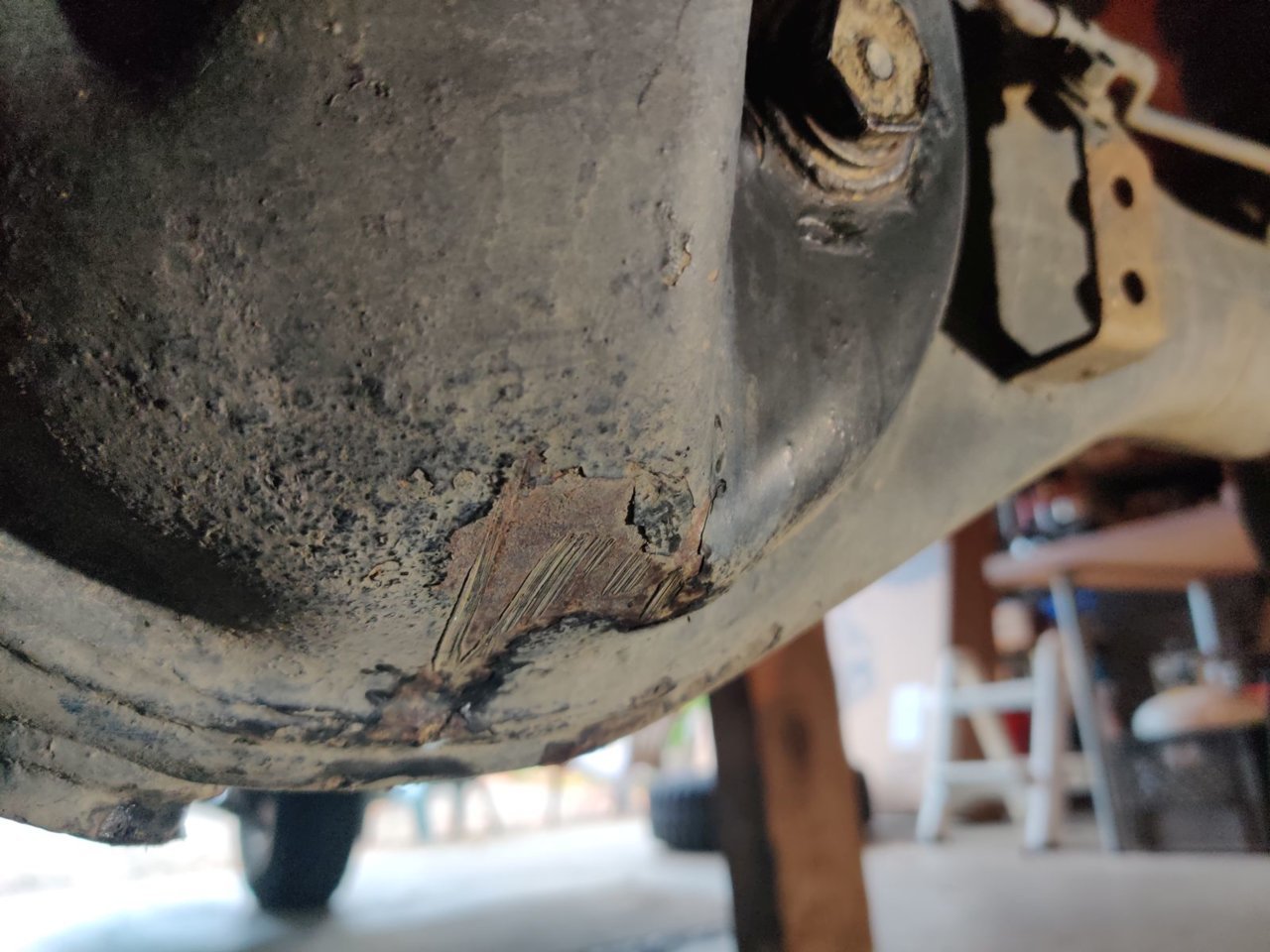

    First of all, I want to say that I was off my game just a bit on my last adventure a couple of weeks ago in the Idaho Sawtooth area with Ben.
    On a couple of occasions I had trouble picking the right line on challenging obstacles and banged on my shit hard more than once. Normally this is not a huge issue because that is what armor is for, right? But if I fail to mount my armor and them bang shit, well..., that's not so good. In this case, I hadn't installed my trusty BAMF diff diaper. And then what did I do, yeah, I backed into a rock and dinged the diff pretty good. Like teeth rattling good. :oops:
    With no weird noises coming from the rear end when I rolled, I thought I had dodged a bullet. So when a started to hear a new noise on the way home from Boise that seemed to be coming from the rear somewhere, a closer inspection was in order.
    Here is a pic of the dent I put in the diff cover:
    It feels like the indentation is about 1/8".

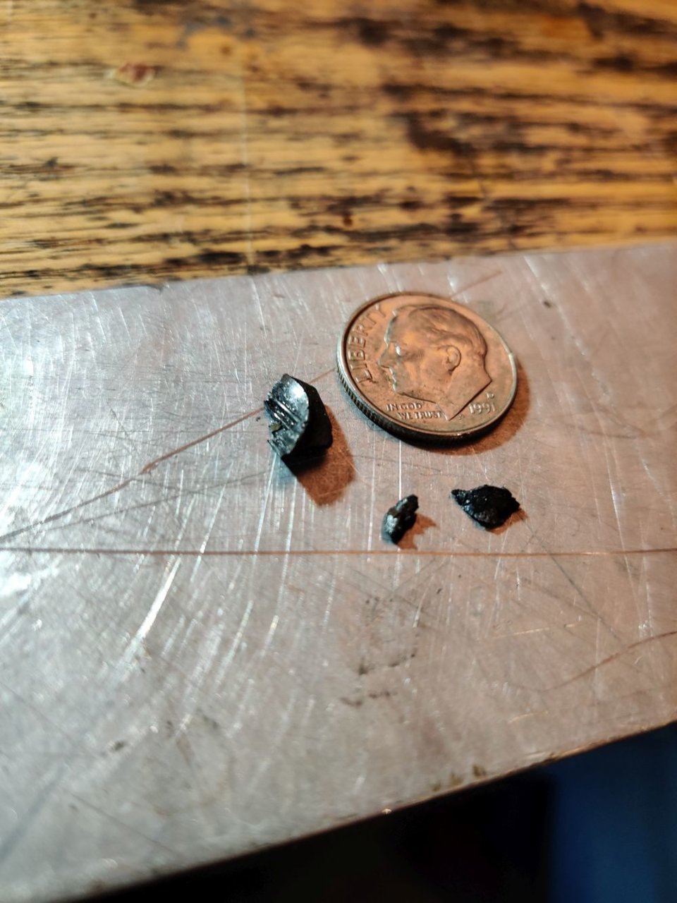

    It was time for a fluid change anyway. So when I drained the oil, along with a little pasty sludge, this is what I found on the drain plug magnet.
    FWIW, I put the rear axle up on jack stands so I could spin the diff to listen for noise, but there was no noise coming from the diff. There was however, noise coming from the wheels, both of them had an unusual amount of brake shoe dragging noise coming from them. And worse yet, the passenger side wheel had a pretty significant wobble to it. :facepalm:But the diff itself was quite.

    What do you guys think? Are these 'chips' from the ring gear? Am I looking at a potential failure of the ring gear down the road?
    And how bad is the bent axle? Is it time for a set of chomoly axles?

    Hard to tell from looking at it, but yeah I would say there’s some likelihood that you took some teeth off the ring gear. We should be able to stick an endoscope through the fill hole and check it out.
    Personally I wouldn’t do anything to the axles until they start leaking or the bearings go. Because you know it’s just going to happen again #semifloatproblems

    That looks like ring gear to me. Or bearing. I'd pull the diff surprised you just didn't all things considered with how far you had it torn down.
    But the shaft looks okay for now. I'd run it. It'll get worse over time then yeah upgrade time.
