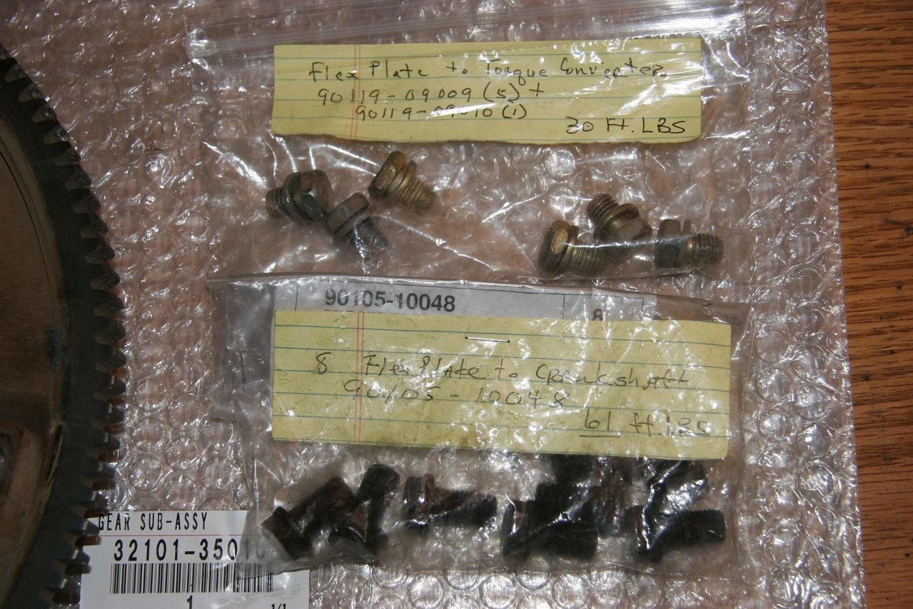

    Drive Plate
    Product ID: 32101-35010 For the flex plate,Yes
    Bolt Washer Based H
    Product ID: 90105-10048 For the flex plate mounting bolts to the crankshaft, yes. There are 8 of them.
    Don't forget the 6 bolts that hold the flex plate to the torque converter. There are 5 of these 90119-09009, and there is 1 of these 90119-09010.
    Engine Crankshaft Seal (Rear)
    Product ID: 90311-A0027 For mine, I show 90311-92006. But it looks like that was replaced at some point by the one you listed.

    Here is what I see on toyoDIY
    32101A BOLT(FOR DRIVE PLATE & TORQUE CONVERTER SETTING)
    90119-09009 *9-1.25PX12.8-8.8, YELLOW 5 $1.34
    90119-09010 *9-1.25PX12.8-9, GREEN 1 $1.34

    Yeah, I saw the pic of that long bolt. I wouldn't put too much creadence in the pic that are showing.
    And just to some mystery to all this, here is a pic of the old bolts I removed from mine

  16. Nov 9, 2021 at 10:03 PM
    Digiratus
    Digiratus Adventurer
    Mar 26, 2010
    #34006
    23,827
    Roaming the PNW
    The RedHead
    2002 XtraCab TRD 4x4 SCv6 AutoTrans With Lots of Mods ADS COs w/Compression Adjusters Camburg Uniball UCAs Whiteline Lower Control Arm Bushings Kartek 7" Limit Straps Plastics Guy Front Bumpstops Total Chaos Sprindle Gussets Custom Alcan Springs +800 lbs +3" ADS 10" Stroke Triple Bypass w/Resi Rear Shocks Custom Rear Shock Relocate All-Pro U-bolt Flip w/Timbren Bumpstops 4.88 Nitro Gears ARB Front Locker ARB Twin Compressor Black 17x8 Konig Countersteer Type X 285/70r17 Falken A/T3w Gunmetal 16x8 SCS Ray10s 255/85r16 Maxxis Bighorns Limited Edition (Relentless) Elite Front Bumper Smittybilt X2O 10K Winch Diode Dynamics SS3 Sport Selective Yellow Fog Lights in the Bumper Diode Dynamics SS3 Pro 4,000 Kelvin SAE Driving Lights with Clear Lenses on the Bumper Morimoto D2S Projectors XB35 Ballasts + 4300K Bulbs Badland Sliders FrankenFab Tire Carrier Swingout bumper w/kitchen BudBuilt Front & Bellypan Skids BAMF Rear Diff Skid Dometic CFX 55im Fridge/Freezer Alpha II Hardshell RTT Badland Custom Bed Rack Denso 210-0461 105 amp alternator Dual Northstar 24F AGM batteries BlueSea 7622 ML-ACR Battery controller Peak DBI Dual Battery Voltage Monitor Haltech IC-7 Display with Mako Dash Insert Haltech Elite 2500 Standalone ECU Magnuson MP62 Supercharger w/URD 2.2" Pulley Doug Thorley Headers Denso 650cc Fuel Injectors Aeromotive Stealth 340 Fuel Pump TransGo A340F Reprogramming Shift Kit OEM ECU Delete Full A340F Trans Control with the Haltech 2500 ECU 2.5" Magnaflow Hi-Flow CAT Magnaflow 18" Muffler w/Vibrant Resonator 13WL Brake Calipers with OEM Rotors & Pads Braided Steel Brake Lines Kenwood TM-71A Dual Band Ham Radio STI-CO Flex Whip VFH/UHF 1/4 Wave Antenna Midland MTX275 GMRS Radio w/Roof Mount Antenna Pioneer DEH-P9400BH HU Alpine Amps & Type R components (F) and coaxials (R) Wet Okole Seat Covers Weathertech Digital Liners Deck Plate Mod 1" Diff Drop Carrier Bearing Drop
    Yes... That was it.
