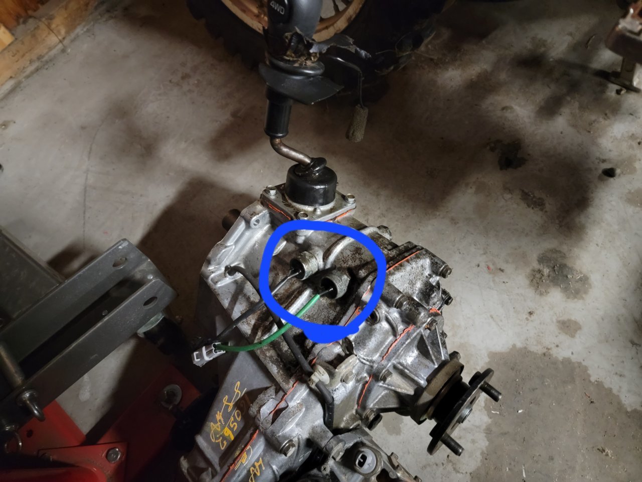

    So you got me curious Dan, I think all top shift J shift cases are the same, just with the sensors added/omitted as needed. So trans, locker, add, abs doesn't matter, as long as it wasn't a 2.7 auto.
    Pic from my case I'm about to tear into:
    turbodb likes this.

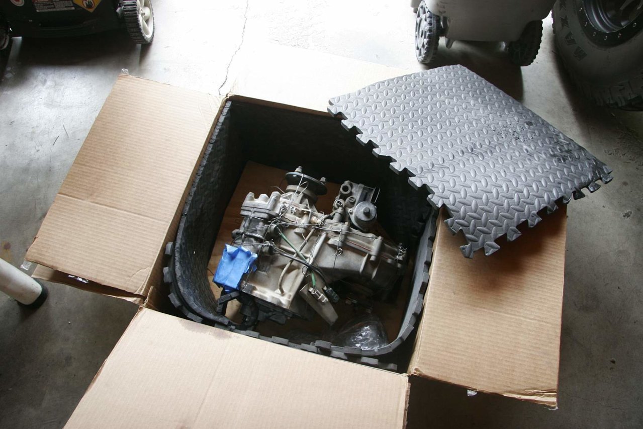

    For shipping, here are some ideas. This is how mine was shipped. That is a piece of plywood that the tcase is wired down on. The UPS Ground shipping label says it weighed 90 lbs.
    jubei and turbodb like this.
