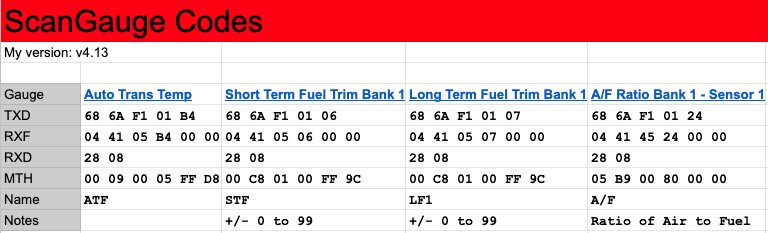

    I think you need to look at fuel trims. Lots of places have the codes for those. Mike does, I think. You could also have a vac leak in the engine bay - I'm assuming you've looked for that? I mean, you did have the engine out and all that crap unplugged. Would line up with the timeline at least. Spray a little starter fluid around in there.
    Then, start keeping track of fuel consumption, even just for a few tanks, to make sure you're actually seeing the drop you think you are. Who knows, maybe it feels like a lot, but is actually just the 1-2mpg you'd expect from bigger tires.
    Mike can confirm if these are the codes; just found this in a search of TW, and don't use a SG myself, so haven't tried them.

    These codes for short and long term trims for bank one appear to be the same as what I am using.
    turbodb[QUOTED] likes this.

    Put the codes in. Trims don't seem wild. Seems to sit pretty close to 0 and occasionally gets to 3 on long term.

    That seems fine for long term. What is the short terms doing?

    bounces around a bit but not a ton. on the highway it stayed on 0 mostly. -4 to 3ish id say during other stuff

    Trims seem normal. Look elsewhere.
