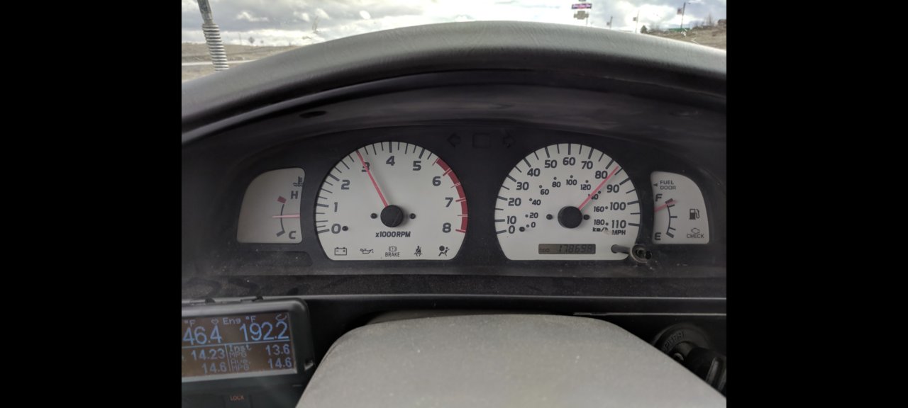

    On 31s, with 4.10 gears, my RPMs in 5th gear @ real70mph were 2500 RPM or so. Maybe a tad higher. I'm right around 3000 now with 33s, and 4.88s.

    wow. Okay then.
    I remember Frank being around 2750 for 70mph. But almost 3k is a bit nuts.

    Here's 32s so your numbers seem in spec, would expect a lower speed for the same rpms with your smaller tires. This was circa 2018 on my truck.

    so your actual speed in the photo is 70mph?

    32s on 4.10s make the speedo 100% accurate to gos readings. So no, the actual speed there is 84mph, plus you are rounding the wrong direction.

    Wow okay. So this is looking more like my gearing is not 4.10s then.

    I found that my speedo was dead-on with 4.10s, 30 tooth speedo gear, and 255/85R16 KM2s (albeit slightly used from Dan @drr). Of course, we all know that "32s" or "33s" are just suggestions. Not sure of the real world sizing differences between the KM2s and KO2s that Ben was running.

    My door code is for 4.10s though. So unless someone did an aftermarket swap or my Speedo is just fuckin loco.

    Unfortunately with tires I stay away from specifics as there's a ton of variability in the notes size, and actual size and variation among manufacturers and tire wear. So the general statement of 32s correct the stock speedo on stock gears is the game I'll play. This was true waaaay back when I had 235/85/16 on the green truck. Not sure what the error would be with 33s. With my current setup of 35s the error is about 10% which makes it easy mental math.
