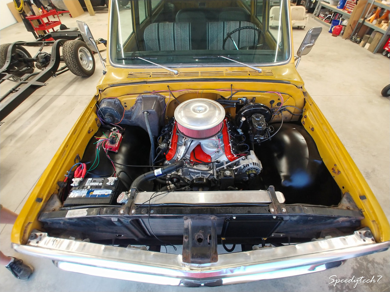

    It's a tool that gets endless use in the shop, I've recabled 5 different cars and three tacomas, countless winch setups... Etc. It's a delightful tool.

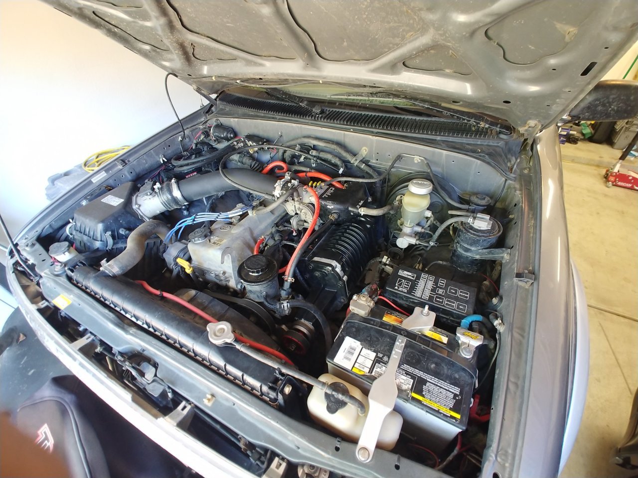

    is that a power cable over the radiator? Laaaaaammmmme
    I always like putting cables in front of the radiator up under the core support. Much nicer looking and protected...plus out of the way of the radiator when it comes out :D
    or is that a vac line? (clearly i know nothing about the 3rz lol)
  8. Jan 11, 2022 at 4:28 PM
    Speedytech7
    Feb 20, 2014
    #123587
    58,296
    FCQM+VG Cheney, Washington
    It's less Tacoma and more mod
    It went to the winch power switch and then to the contactor which was behind the airbox. Kept the line shorter and away from things, it was safely tethered and when unclipped from it's loops easily fell back to take out the shroud and rad. And it's plenty protected under the hood
