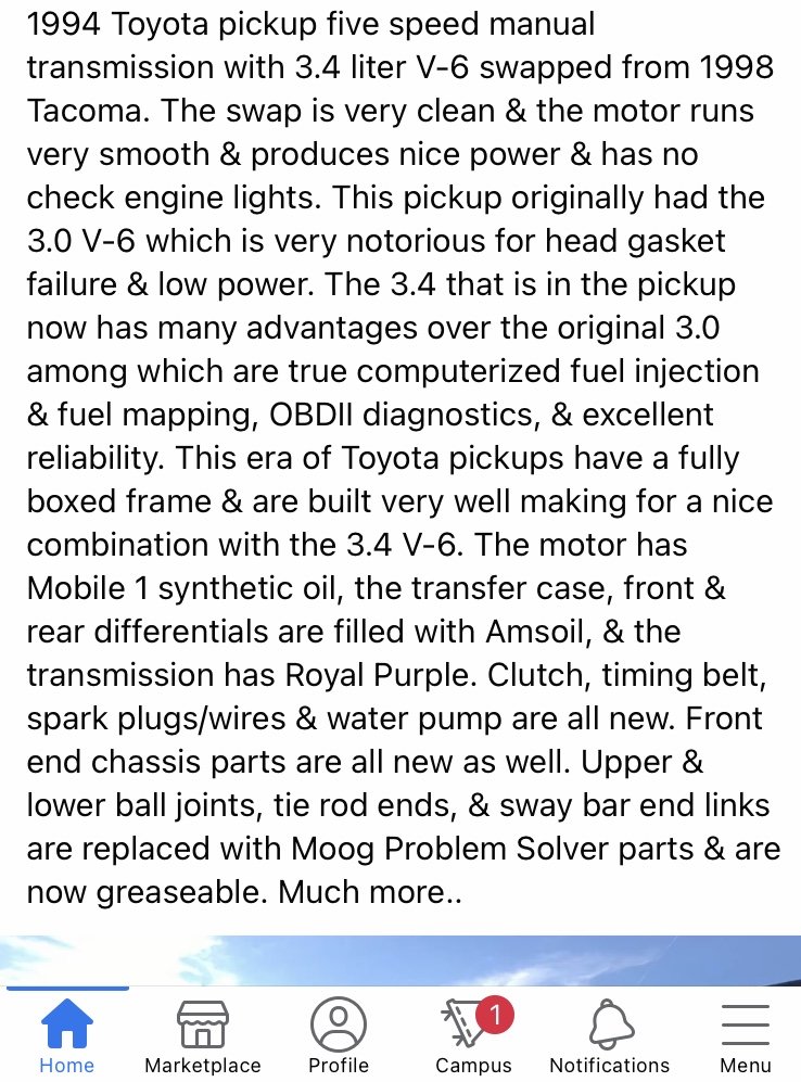

  13. Jan 24, 2022 at 8:07 PM
    JKO1998
    JKO1998 Well-Known Member
    Jun 2, 2015
    #156578
    53,031
    Utah
    Good ol Green River
    3EC989AE-BEBB-46BA-A16D-4CC7D4BC07B9.jpg 16D193A5-9E6D-4F8C-A708-DAA2CB7335EB.jpg
  14. Jan 24, 2022 at 9:01 PM
    Blackdawg
    Blackdawg [OP] Dr. Frankenstein
    Dec 31, 2010
    #48500
    81,631
    Monte
    Wyoming/St. Louis
    The Trifecta of Taco's
    20k? wtf haha
  15. Jan 25, 2022 at 8:27 AM
    BossFoss
    BossFoss If your over 40 feet back, you ain't suspicious.
    Nov 14, 2014
    #142355
    3,067
    Wyoming
    01 DC Tacoma
    You see this one up in your area? That can't be worth that
  16. Jan 25, 2022 at 10:42 AM
    Digiratus
    Digiratus Adventurer
    Mar 26, 2010
    #34006
    23,827
    Roaming the PNW
    The RedHead
    2002 XtraCab TRD 4x4 SCv6 AutoTrans With Lots of Mods ADS COs w/Compression Adjusters Camburg Uniball UCAs Whiteline Lower Control Arm Bushings Kartek 7" Limit Straps Plastics Guy Front Bumpstops Total Chaos Sprindle Gussets Custom Alcan Springs +800 lbs +3" ADS 10" Stroke Triple Bypass w/Resi Rear Shocks Custom Rear Shock Relocate All-Pro U-bolt Flip w/Timbren Bumpstops 4.88 Nitro Gears ARB Front Locker ARB Twin Compressor Black 17x8 Konig Countersteer Type X 285/70r17 Falken A/T3w Gunmetal 16x8 SCS Ray10s 255/85r16 Maxxis Bighorns Limited Edition (Relentless) Elite Front Bumper Smittybilt X2O 10K Winch Diode Dynamics SS3 Sport Selective Yellow Fog Lights in the Bumper Diode Dynamics SS3 Pro 4,000 Kelvin SAE Driving Lights with Clear Lenses on the Bumper Morimoto D2S Projectors XB35 Ballasts + 4300K Bulbs Badland Sliders FrankenFab Tire Carrier Swingout bumper w/kitchen BudBuilt Front & Bellypan Skids BAMF Rear Diff Skid Dometic CFX 55im Fridge/Freezer Alpha II Hardshell RTT Badland Custom Bed Rack Denso 210-0461 105 amp alternator Dual Northstar 24F AGM batteries BlueSea 7622 ML-ACR Battery controller Peak DBI Dual Battery Voltage Monitor Haltech IC-7 Display with Mako Dash Insert Haltech Elite 2500 Standalone ECU Magnuson MP62 Supercharger w/URD 2.2" Pulley Doug Thorley Headers Denso 650cc Fuel Injectors Aeromotive Stealth 340 Fuel Pump TransGo A340F Reprogramming Shift Kit OEM ECU Delete Full A340F Trans Control with the Haltech 2500 ECU 2.5" Magnaflow Hi-Flow CAT Magnaflow 18" Muffler w/Vibrant Resonator 13WL Brake Calipers with OEM Rotors & Pads Braided Steel Brake Lines Kenwood TM-71A Dual Band Ham Radio STI-CO Flex Whip VFH/UHF 1/4 Wave Antenna Midland MTX275 GMRS Radio w/Roof Mount Antenna Pioneer DEH-P9400BH HU Alpine Amps & Type R components (F) and coaxials (R) Wet Okole Seat Covers Weathertech Digital Liners Deck Plate Mod 1" Diff Drop Carrier Bearing Drop
    It's not.
    Might make a decent parts truck if it was priced at half of what the listing is for.
  17. Jan 25, 2022 at 1:23 PM
    Blackdawg
    Dec 31, 2010
    #48500
    81,631
    Monte
    Wyoming/St. Louis
    Yeah I did. Way too much for how fucked up the cab is.
