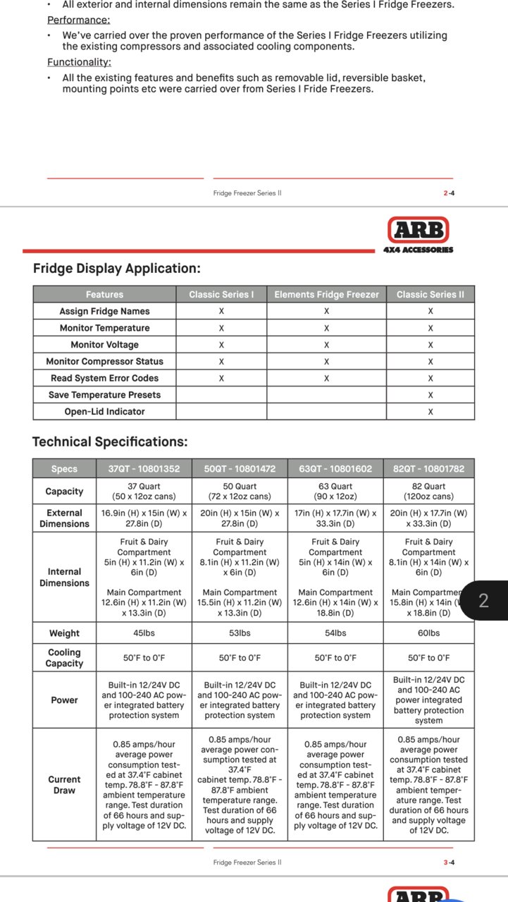

    I wanted to circle back to some of this information as I think the thinking here needs to be more granular. There are two different charging phases that are done by both the CTEK and my Magnum inverter (and it is now configured for AGMs). The phases are Bulk/Absorption and Float. Both the CTEK and Magnum will Bulk/Absorption charge at 14.7V which is what you want and alluded to as a requirement for AGM battery health. However, your concern of the 13.3V occurs at Float charging, the tail end of charging and used to maintain the voltage in the batteries using a minimal amount of current. The CTEK will float charge at 13.6V, my Magnum will sit at 13.3ish. To me, it is telling that both components float charge AGM's below 14V. And it also man's that outside the RECON function of the CTEK, I wouldn't gain much by using it over my Inverter from what I see other than a slightly higher float charge voltage.
    Curious what you think on this as I still learning. CTEK numbers are from the Manual. Magnum are from what I've observed.
    Also working down the path of my isolator and circuit breaker. The diode on the isolator are looking to be working but the shortstop circuit breaker seems dead so hopefully getting that replaced will allow for charging off the alternator when driving.

    @m3bassman - I'm with Brett on this one. While I have (and like) the ML-ACR that Mike mentioned, I think your usage profile in the van is different enough for a few reasons that I'd recommend a DC-DC charger:
    • You have a battery bank for your house batteries, rather than a single battery. I know that technically, when they are wired together in parallel, they are sort of like having a single big battery, but yours are really meant to be house power vs. ours that are more house power/starting-battery-savers combo.
    • You need a DC-DC charger anyway for the solar. Brett likes his Renogy, but if you're replacing what you have, I'd recommend the REDARC BCDC1225D DC-DC Charger w/Solar since that'll replace all the brains of your electrical system and consolidate everything into a single controller. Maybe the Renogy does too, since I know they have some solar stuff (re-reading Brett's, I see his does). The Redarc will probably cost more (just due to brand/reputation); I have no idea if it's worth it, but I've heard good things. Steve (Monte's dad) runs one for his setup.
    • A DC-DC charger will - 100% - give you a high enough charging voltage for AGMs, and as you know, is configurable based on your chemistry. That's a lot different than just sending "whatever the alternator" outputs to your batteries and hoping for the best. We're lucky in 1st gen Tacos that it generally works out, but it's not something that's universal (e.g. it doesn't work on 2nd, 3rd gen Tacos)
    • With the DC-DC charger, you don't have to run a monster set of cables between your batteries. While it charges at the necessary high voltages, it does so with less current.
    There are some drawbacks to a DC-DC charger, in that you can't link your starting and house batteries for jump starting or winching, but I think those are rare enough cases that they don't matter for your new setup. Winching - as you mentioned - you can do with a single battery and an idle controller. Jump starting - well, you don't currently have a problem of running down the starting battery... plus, you can just carry cables and use those if you need them.
    Lastly - regarding the draw of your fridge. 10A isn't all that much at 12V - that's a 120W power draw, which is about the same as my headlights or SS3 fog lights. My ARB fridge (50qt) pulls 6-7A at full tilt on a hot day.

    Those are great points. I'm looking to get it working, I can upgrade later with some of the options available. I still need to retain the inverter so a DC-DC+solar wouldn't be the end all be all solution. It also didn't appear in my 5minutes of research to be designed to live under the hood. The inverter allows me to run my 110v plugs and utilize shore power hookup. The biggest draw back to everything thought, is I already have parts that work (besides the old breaker that cost $12). It would make sense if I had an issue with my solar and my isolator but I don't currently. So DC-DC really isn't on the table, it would be different if this was starting from scratch build.
    As far as your arb pulling 6-7amps per hour, is that at 100% duty cycle? Because that is 7x what arb claims is the average power consumption of the 50qt fridge given the parameters below.

    Yeah, you totally need to figure out the cost/benefit on getting new parts vs. using what you've got. If what you have works, no need to spend $1K buying new, just to have new.
    The fridge: That's why I said it pulls 6-7A at full tilt on a hot day (70-80W). That's totally different than what ARB has there, which is amortized over time. Most of the time the fridge is off (i.e. warming up).

    Wait were you saying you use 6-7amps/24hours? Most 12v fridges I've looked at are 1.25-4ah consumption. Your numbers aren't really adding up.
