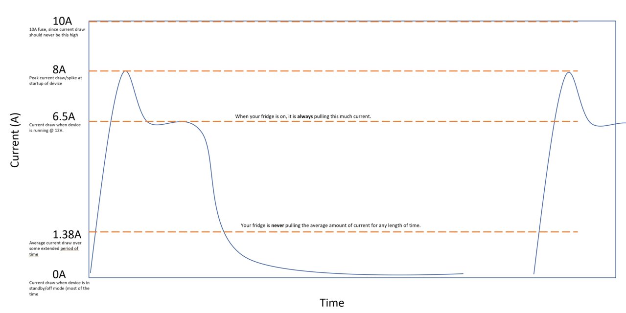

    I realize that this is a little bit of :deadhorse:, but I'm going to do it anyway because it's the internet, hahahaha.
    The issue you're running into with your stove startup is a little different than what we're talking about. The initial voltage check to get the fridge compressor (or in the case of your stove, igniter/fans/whatever) is actually because it needs a certain amount of Power (P[W] = Vi) to get everything moving, which is more than the power necessary to keep it moving. A lot like your MPG example, where it takes less fuel to cruise at 70 than it does to accelerate to 70mph.
    Anyway, the reason that there is a V check and not a Power(W) or Current(A) check is that you can measure voltage without sending (any real amount of) power to the device, by putting a really big resistor into the circuit, but you can't measure current without actually flowing all the power through the circuit (thereby actually starting the device!). So, your stove (or our fridges) assume that if you have >12V at the battery, that it will be able to pull enough current to start up. Usually this is an OK assumption, until your battery starts to degrade, at which point it can't actually maintain those 12V when current is being pulled.
    The thing we've been talking about - draw when on vs. avg. draw - is actually this chart. I've also included the startup spike that is what I think you were alluding to in your last post. That startup spike is one of the things that determines the fuse size for the circuit; the other is the number of Amps drawn when the battery gets to the lowest voltage the device can run on.

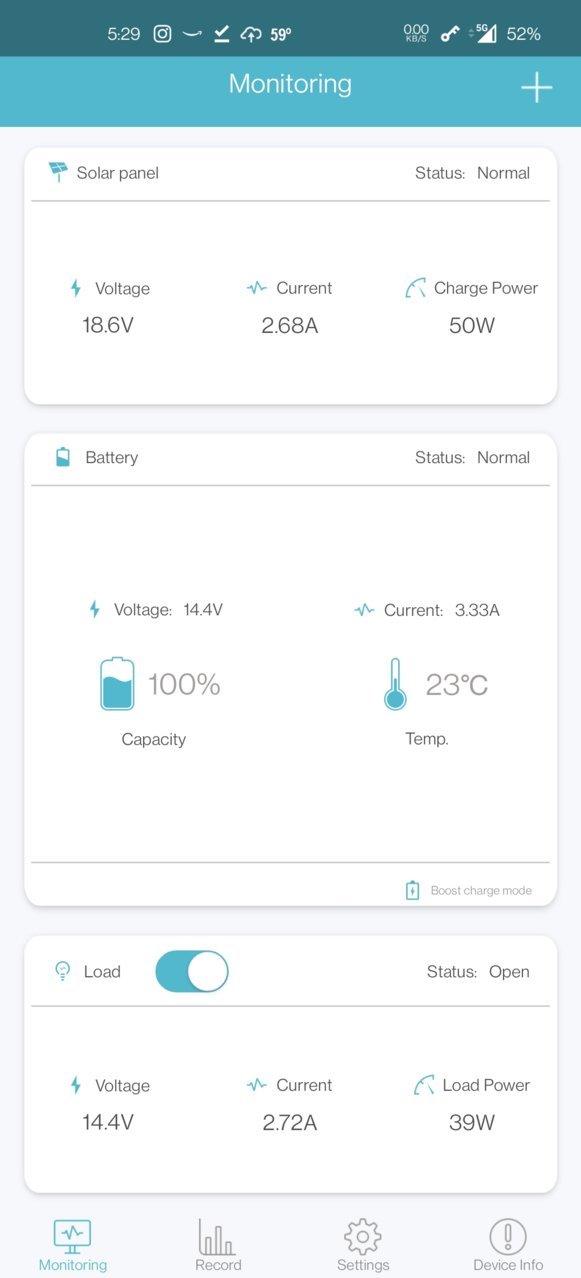

    Chiming in on the power talk!
    Although I'm not new to electronics, I am somewhat new to solar and house-power.
    I've been trying to manually monitor my house battery usage though the Renogy BT controller. Usually with my CSI fridge in eco-power mode, the draw is 2.5A-3A 30W-40W when is running full-bore.
    I've also been trying to monitor the diesel heater startup and running-on-low power consumption.
    As of now, I've got a single X2 27f (100ah total) dedicated house battery charged by a 175w panel through an MPPT controller.
    Fridge and heater running all night in freezing temps outside (65-70+ inside, depending on ventilation) keeps me around 55% capacity in the morning.
    Fridge only:
    m3bassman likes this.
