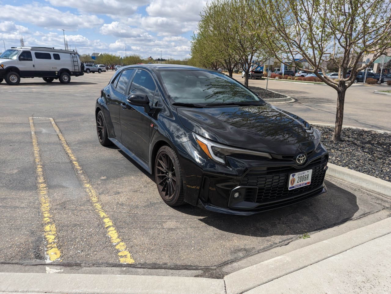

    Saw a GR Corolla today for the first time. Barely noticed till I saw the badge on the back. Looks fun!
    SconnieHailer and Blackdawg[OP] like this.

    I want so bad.
