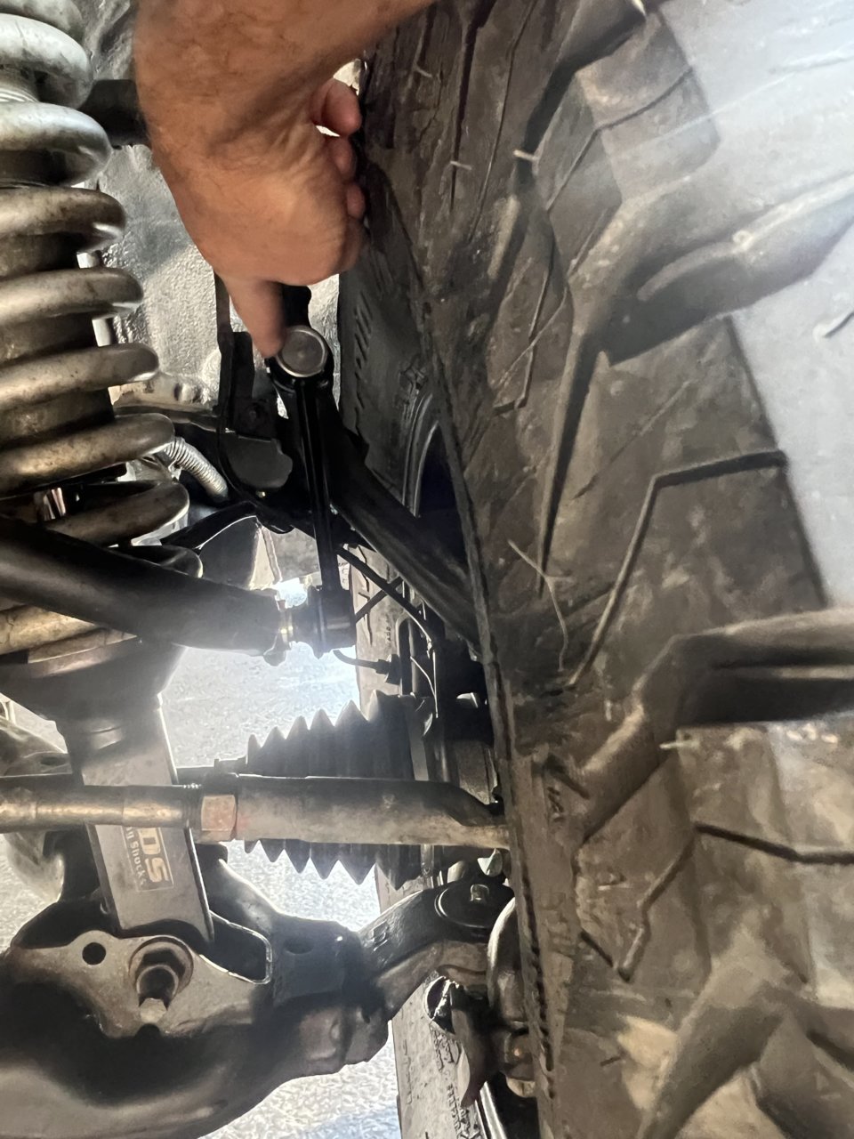

    Follow up all fixed and the caused ended up being broken drag link, sheared at the base of the rod at the lower link and flopped around and took out my cv boot, driver’s side

    this lil guy did it!
