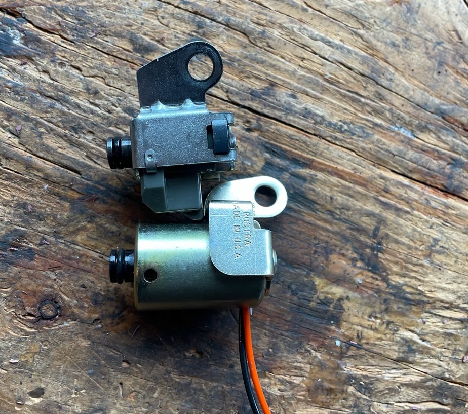

    stupid replacement solenoid isnt the right length and doesent fit. factory on top, replacement on the bottom. Anyone have a link to a replacement that actually fits that isn't a $250 each oem one ?

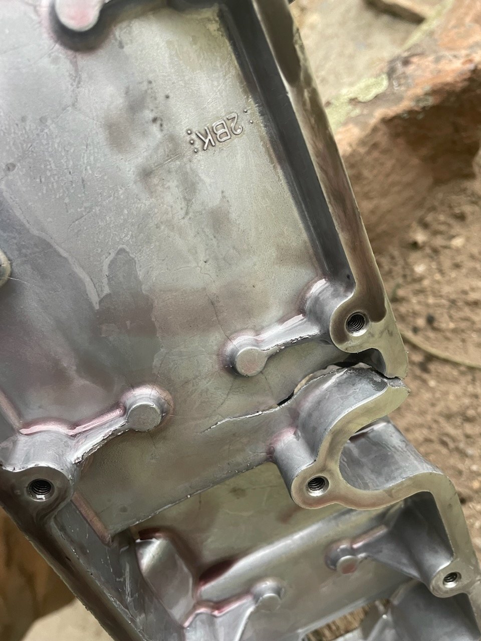

    also, my transmission filter clearly wasnt doing a very good job lol. this is the top of the filter case, just cracked to shit. probably happened when i dented the shit out of the pan like, 8 years ago

    I avoided paying the $250 oem price on my Land Cruiser by buying the solenoids from Isuzu since the same trans is used in their box trucks. Maybe there's one for a Jeep you can use since the AW4 is an A340? Isuzu OEM was literally the Aisin solenoid, gotta imagine Jeep probably does similarly. Also in an A340 there are two shapes of solenoid, did you just buy one instead of the whole kit?

    I bought the kit that said it fit. but then rock auto admitted there was an issue and the kit was in fact incorrect so they are accepting the return.
