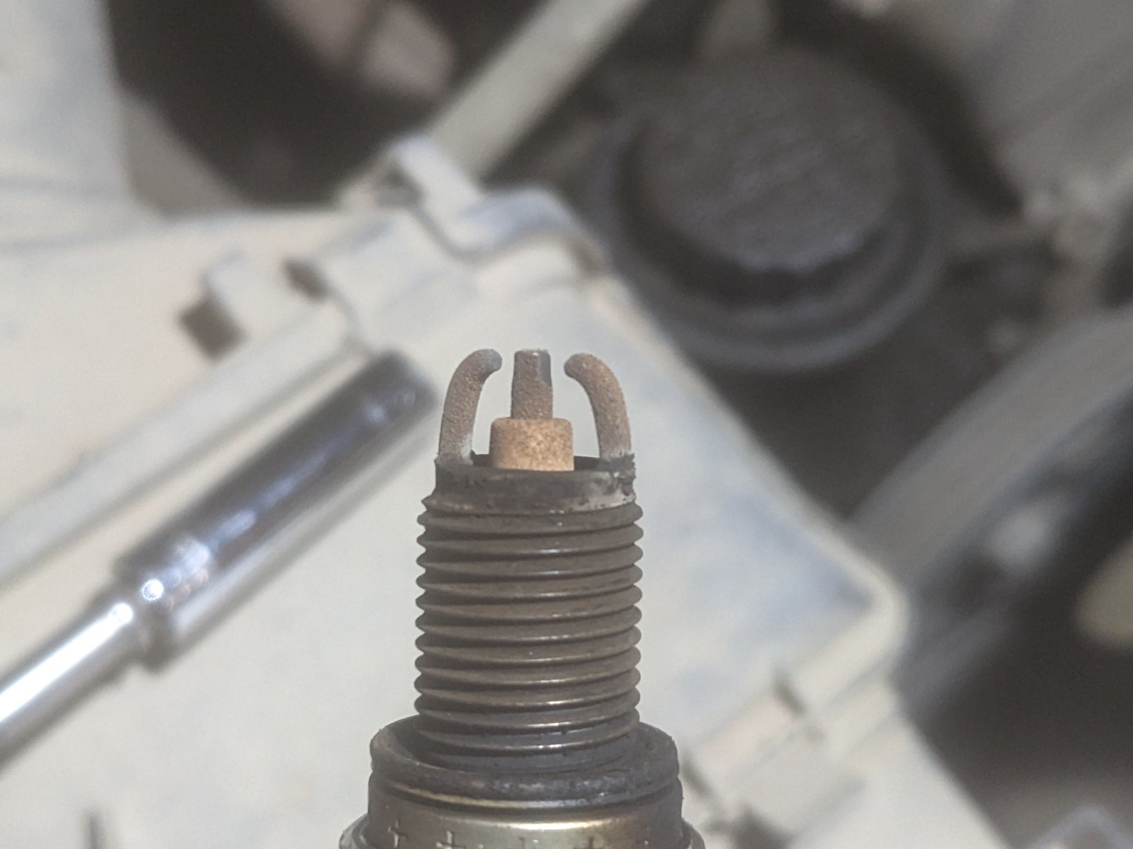

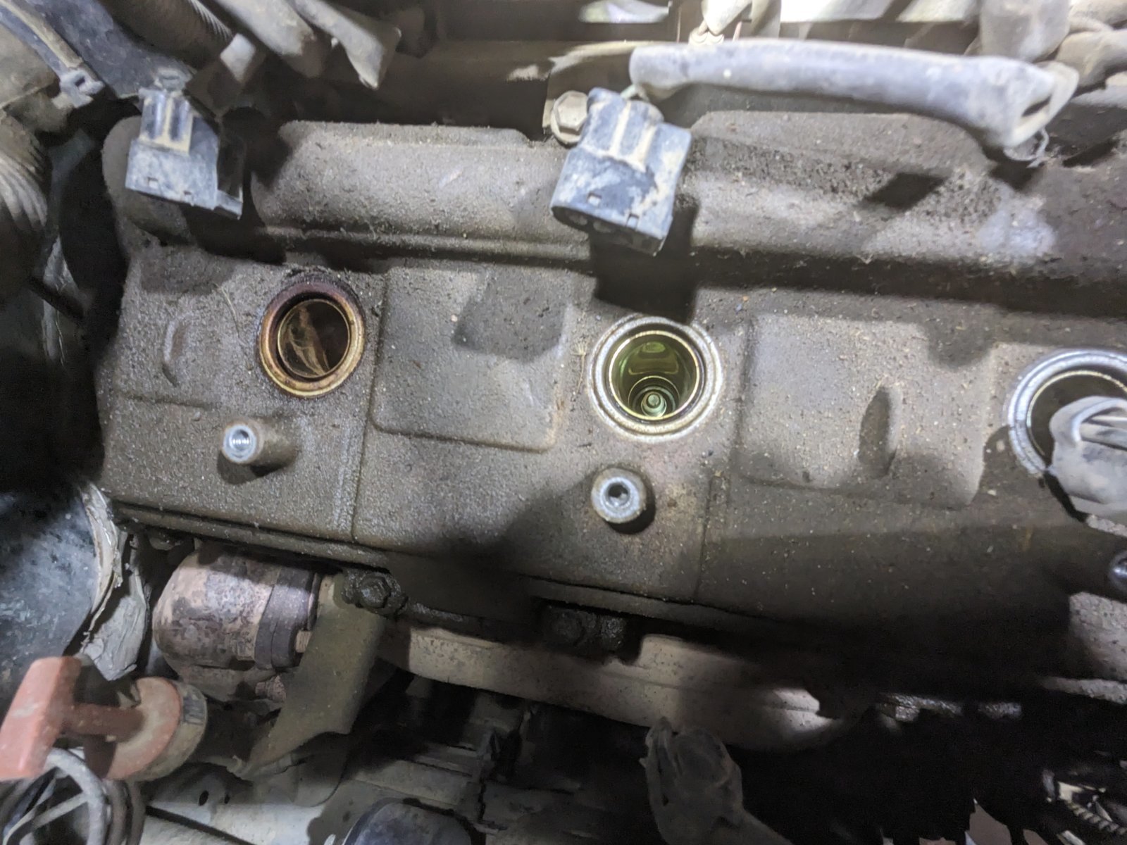

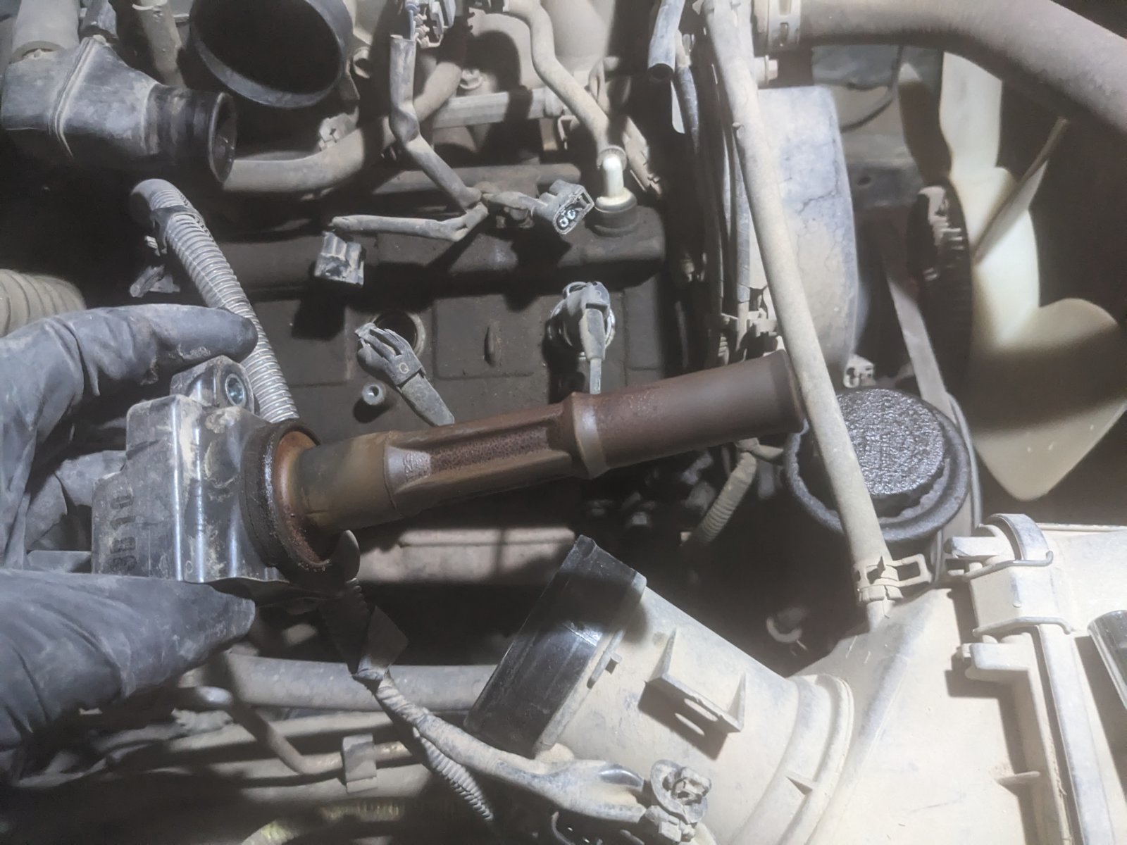

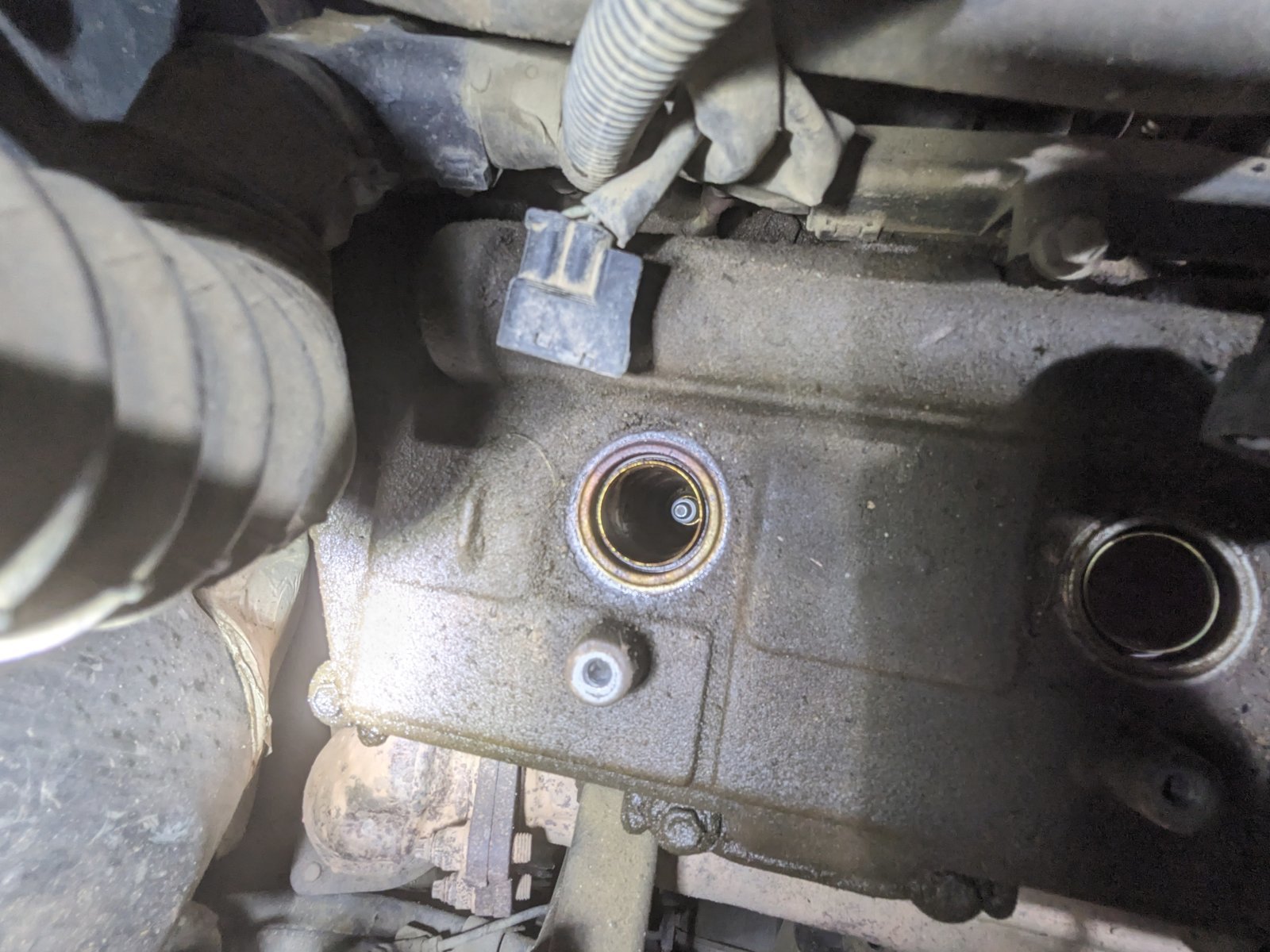

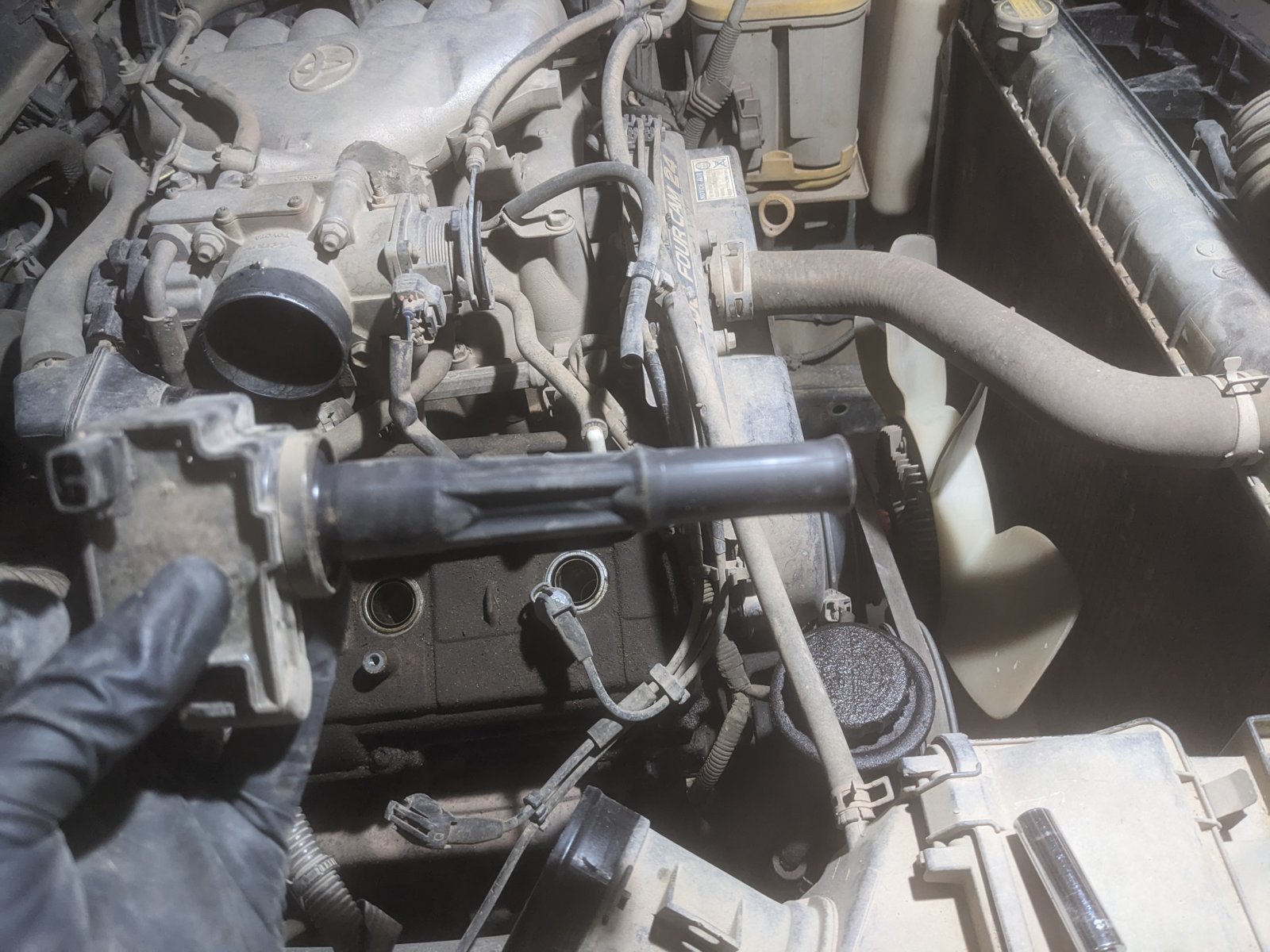

    Props Jaxon. Seems you might be right.
    Third coil pack is dark and not smelling great. Spark plugs tube is filthy.
    PXL_20240312_011912613.jpg PXL_20240312_011925521.MP.jpg PXL_20240312_012103353.jpg PXL_20240312_012127408.jpg

    Plus doesn't look any worse that the others in this side.
    Which begs the question. Are the plugs bad or the one coil pack?
    That's the same one that was giving me a misfire code two years ago. Which led me to get new coil packs in the first place.

    Well I've got new plugs so might as well.
    Only difference I've noticed is the bad looking one doesn't tighten up like the others. Was more sudden and stuff then nice and smooth. So that's not great.

    Are the coil packs OEM? If you are not going to replace them right now, try moving that one to another hole.
    That plug is not totally done but there is some wear. Replace them if you have them.

    Yeah Toyota OEM. I'll move it see if anything happens. Last time I have a misfire code for cylinder 3 and it followed the coil pack. I said fuck it at the time and replaced them all.
