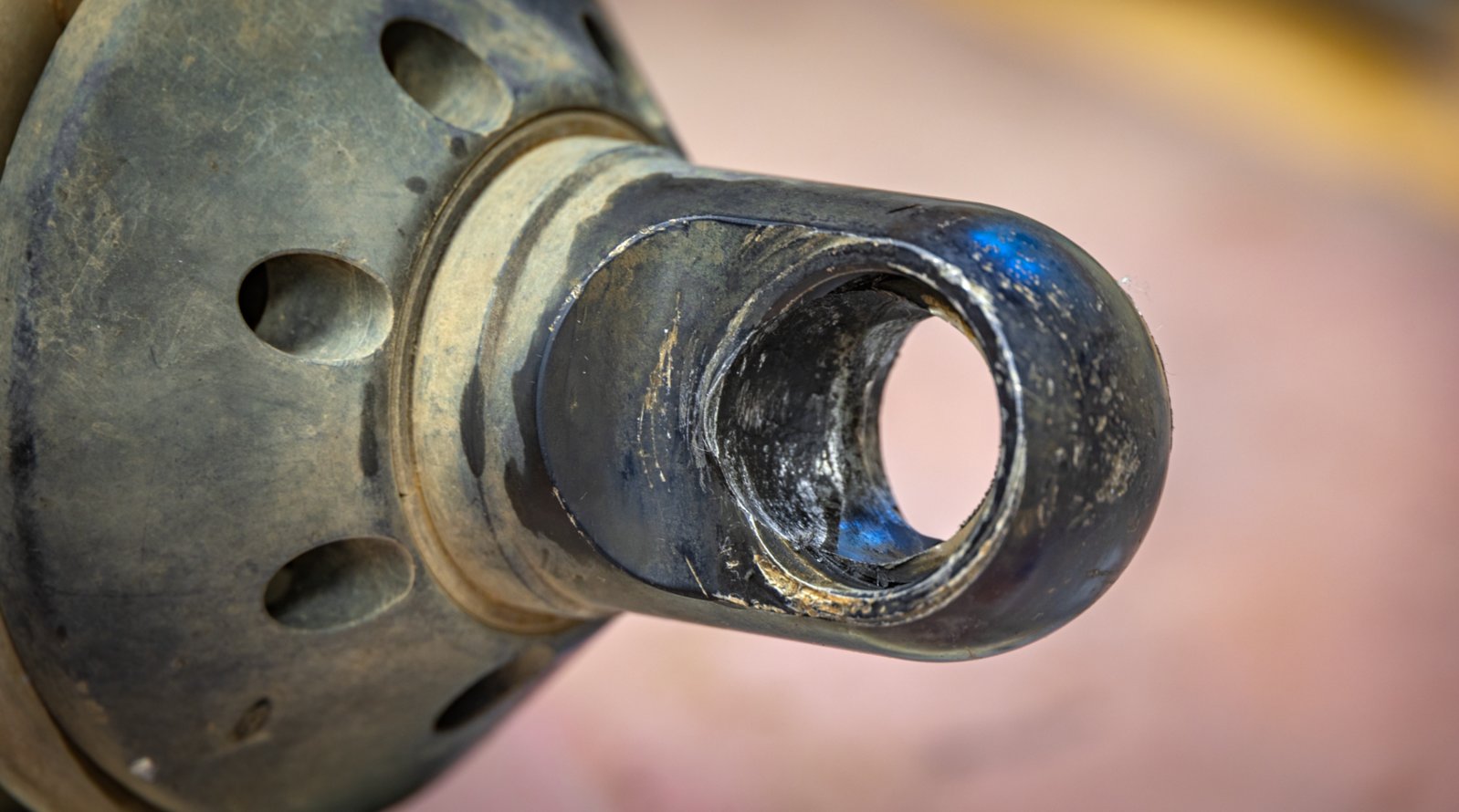

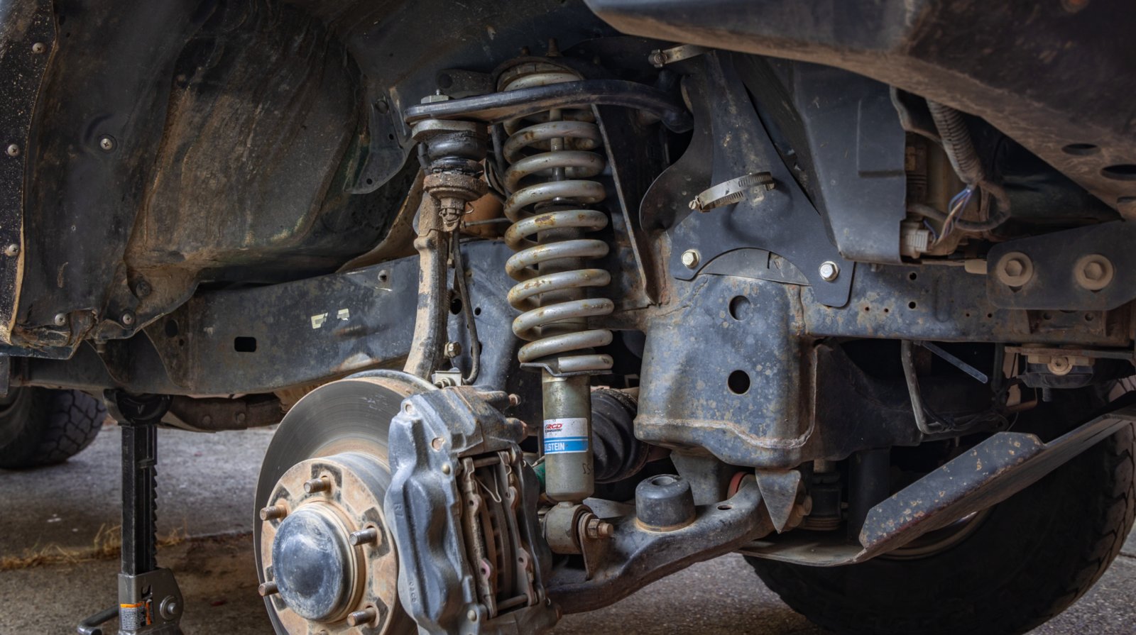

    Well, I guess I can't make fun of Monte for waiting too long to swap out spherical bearings anymore...
    Monte - how hard is it to replace the rod end? Curious about holding the shaft and how hard it is to remove unscrew the end. Need to heat it? Loctite on reinstallation?

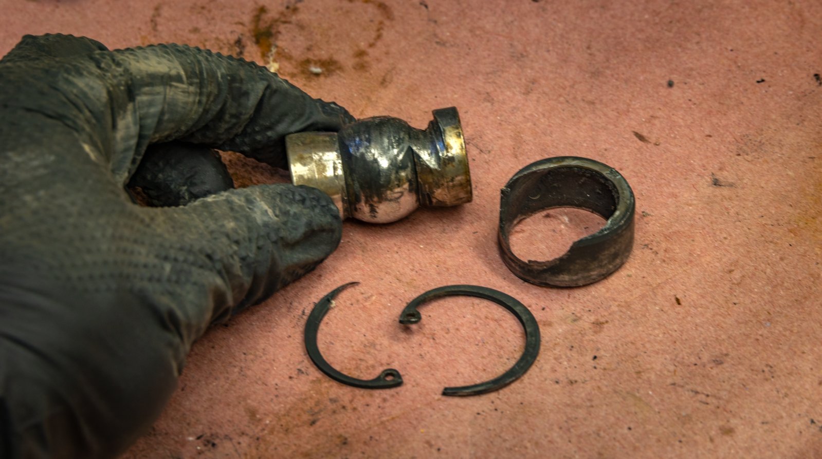

    What's left of the bearing and clips. Of course, the ball and misalignments have a little wear too, and of course, they just fell out of the whole situation once I had the shock off the truck, hahahaha.

    bummer. I should have known. The only time mine squeaked was when that happened.
    Anyways, no idea. That happened to my Kings and I bought ADS to replace them lol
    I had hoped to rebuild them but never did.
    I know it's a PITA to get the rod ends off though. Basically the right way is to get a block of Aluminum and drill a hole slightly smaller than the shafts. Cut it in half. Then use a press to hold the shaft down while you try and get the rod end off. Not easy though as it's very high torque and lock tighted with some good shit.
    I think even most rebuild shops just do full shafts rather than try to do the ends.
    Id call ADS for the torque specs as I'm sure there is one and for sure lock tight it.
    What was the mileage?

    Mileage was.... 56K. They go bad fast though. I last checked them at 12K ago. They were ready to be replaced, but there was no destruction at that point.
    I figured the rod ends might be a PITA. Probably best to just send them down to ADS and get new ends put on. Already sent an email to Tyler at ADS; calling tomorrow if I don't hear back in the morning. I wish I wasn't so damn lazy. I need a mechanic.
