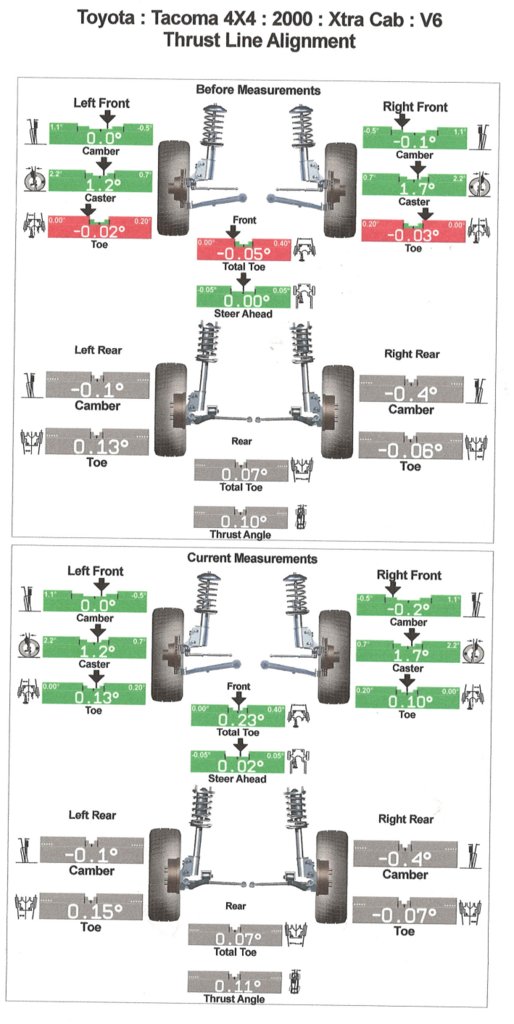

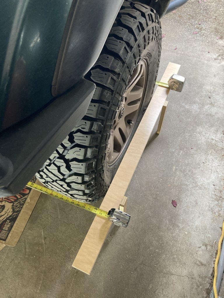

    Thanks Brett @Squeaky Penguin for some guidance on the home alignment. Got it pretty close with my "tools."
    And Zane @Speedytech7 - we got the rear dialed in pretty close it looks like.

  15. Sep 11, 2024 at 6:41 PM
    Squeaky Penguin
    Squeaky Penguin Nothing Ventured, Nothing Gained
    Apr 5, 2012
    #76340
    10,097
    Brett
    Steamboat Springs, Colorado
    '01 4WD, SR5, TRD & '13 TRDOR AC
    Lots of dust and custom dents, Check Build
    Glad I could help! :cheers:
    It's a good skill to have. Slight toe correction and you could've been fine without the shop. Plus, hopefully you were able to gain tire clearance by making adjustments that shops won't do.
    Does it pull to the left at all? It'll pull to the side with less caster, but that might be a good amount to compensate for road crown.

  16. Sep 11, 2024 at 6:46 PM

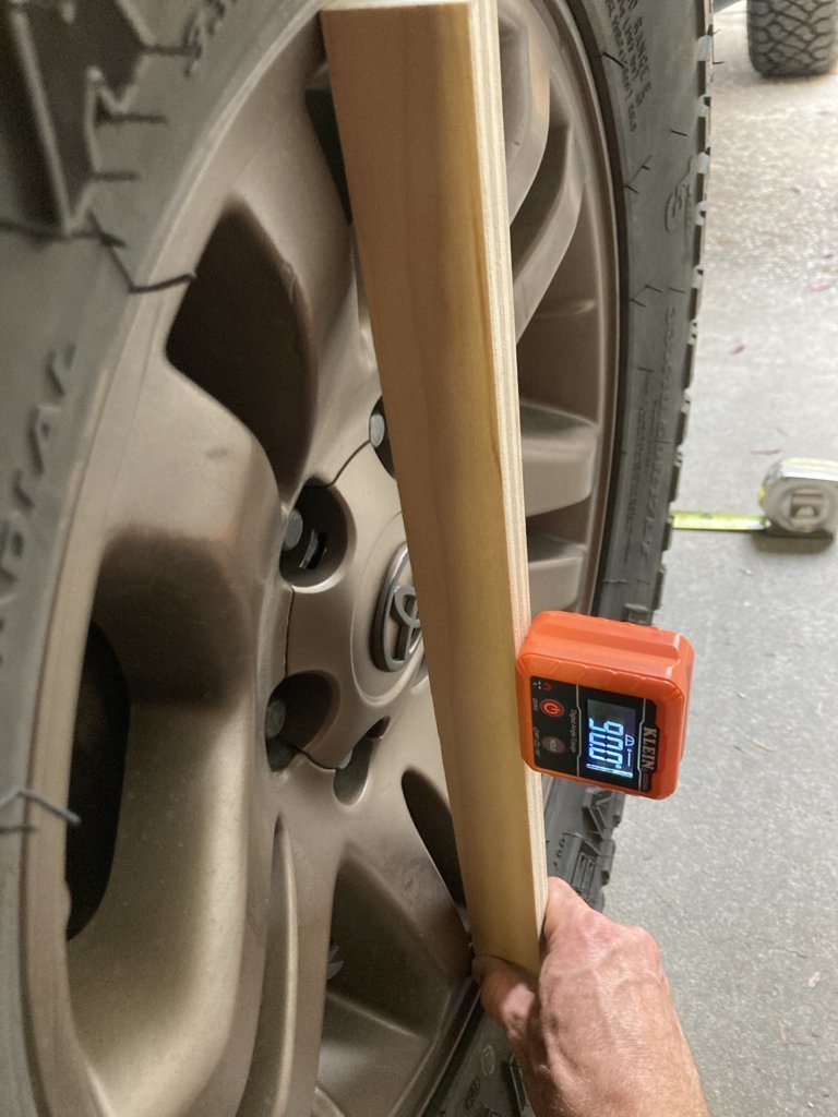

  17. Sep 11, 2024 at 7:22 PM
    turbodb
    turbodb AdventureTaco
    Feb 9, 2016
    #177696
    8,577
    Dan
    PNW
    2000 Tacoma Xcab 4x4 SR5 V6 TRD
    AdventureTaco
    Doesn't seem to pull left at all, at least so far. My steering wheel used to be canted left about 10° when I was going straight, and they got that fixed too, which was nice.
    Thanks! I was surprised how easy it was with a few pieces of wood, an angle guage, and 2 tape measures, to get everything dialed in nicely. I'll definitely be doing this before I take it in from now on, b/c it makes it much easier get a "dumb" alignment from Firestone, rather than hoping that they can deal with the SPC UCAs.
    @Digiratus - this was at the Renton Firestone where Oscar used to work. Alex was the tech, and seemed very knowledgeable. I probably could have had him mess with the UCAs, but I didn't want to risk it given a trip next week.

  19. Sep 11, 2024 at 8:25 PM
    m3bassman
    m3bassman Well-Known Member
    Jan 16, 2011
    #49376
    17,138
    Green truck
    Why would they ever need to touch the spcs? You should be able to set those yourself.
    An alignment is much like shooting your camera in Aperture priority. If YOU control some parameters, the camera will do the others to get the right exposure. So I set aperture and ISO and the camera will nail the shutter speed. But based on what I set the aperture and ISO, I can dictate the the shutter speed because I know the end exposure target is fixed. Same with the alignment, the exposure is the same as the alignment specs, a known finishing point. You can adjust the ISO (spc) and it'll end up where you want with them automatically adjusting the cams, aka the shutter speed. I would never want an alignment shop touching my spc, I set them where I know they need to be so that they can adjust the cams and nail the exposure with them alone.
  20. Sep 11, 2024 at 9:34 PM
    turbodb
    Feb 9, 2016
    #177696
    8,577
    Dan
    PNW
    AdventureTaco
    lol
    I had the ball joint cams set on the SPCs already, but I didn't have the camber dialed in because that's work and seemed easier for the guys at Firestone to do with their fancy machine than for me to do at home. I just put the "new" SPCs to the same camber position and snugged them up.
    Plus, for the last ~6 years, we've had alignment techs here who were actually good. They would reposition the SPC ball joint cams even, to max out caster, etc. as long as you asked beforehand. No more, unfortunately.
    I'm curious how you set the big top nut on the SPCs. Did you use an angle finder (what I did the second time) or just eyeball a guess (what I did the first time)?
