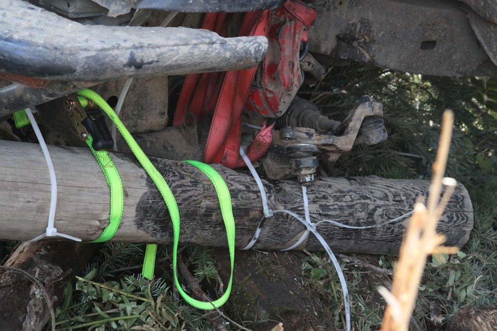

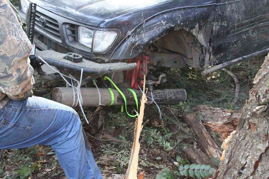

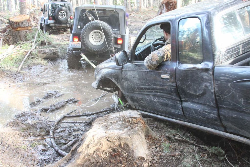

    A tried and true recovery method. Not sure why it needed to be done on pavement though.
    These are some pics I have of a trail recovery of the Raisin out at Elbe Hills ORV. A sloppy mess.

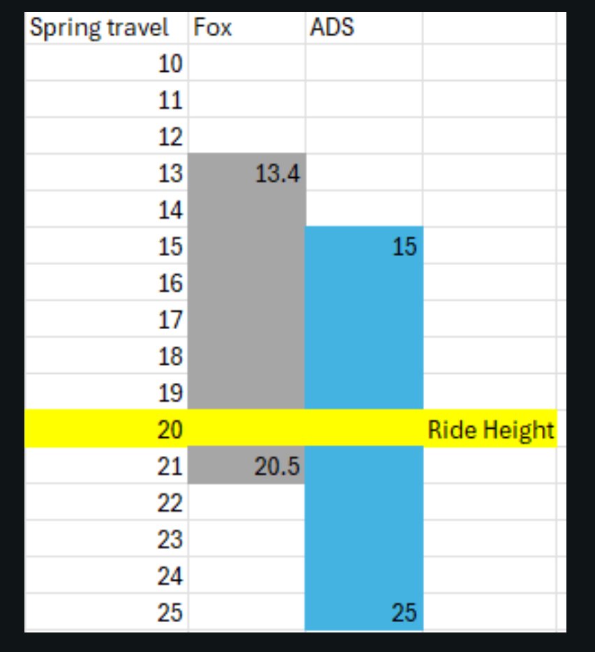

    Ok a need some help with rear shocks. Obviously the shocks I have aren't working. Per Headstrong they were made for 0-1" of lift and this worked when the truck sat lower on 35s. But now the rear is taller and I'm topping out the shocks in normal driving (the roads here are pretty shitty) and they are pretty brutal off-road.
    https://www.headstrongoffroad.com/store/p296/Fox_-_95-04_Toyota_Tacoma_Rear,_PS,_2.0,_IFP,_7.1",_0-1"_Lift_-_980-24-672_(PAIR).html
    The shocks are 13.4-20.5" stroke. I want something like 15"-25" and ADS has 250-sbx10-000 that meets this and are bit spendy at $1400. I know you are ADS fanboys but is there anything else I need to worry about with this? I am assuming that the leafs can droop the additional 5" but maybe that isn't the case as they barely squatted when we put weight on them. I could take a leaf out and swap to 650# front springs as another option. The image below is based entirely on the assumption of how much travel the springs have in them, assumes the ride height based on experience with the Foxes, and ignores what the compression is at the bumps.

    I forget if you ever did the rear shock relocation? If not, don't forget that the ADS are going to come with spherical bearings vs. the rubber bushings used with the stock mounts. If you're still using stock mounts, maybe 5100s? (since I know those are commonly recommended for 0-3" lifts).
    If you do want to go ADS, want to save a bit of money, and don't mind waiting a few weeks, I'll sell you mine, newly rebuilt for $1000 shipped, since I want to pick up some longer ones for the 63s. But, I haven't ordered yet, so you'd have to wait for me to get the new ones and then ship mine your direction.
