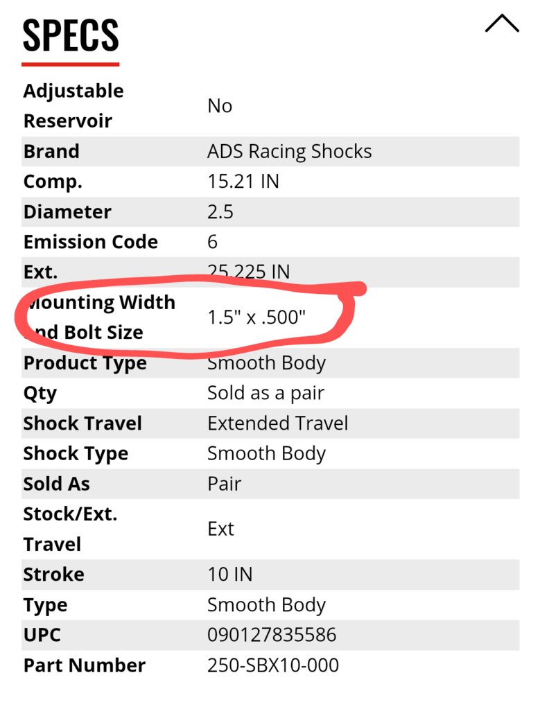

    I mean, like I said - I don't know how they'll mount up at all since they have spherical bearings and the stock pegs expect rubber bushings, but that's going to be an issue with any shocks from ADS, I'd suspect.

    Are you sure those will work on his truck without relocating the mounts? Seems like they will be too long. Also, the stock mounts wont work with the spherical bearings. IIRC, the ID on the bearings is 1/2" and the oem mounts are either 9/16'" or 5/8" OD.
    Edit: NVM, I see you addressed it.

    Just be aware - the ones from ADS are not a direct fit, either. They are the same part number as my invoice, and they most definitely have spherical bearings. You can call to confirm, but I guarantee that direct fit is a typo.
    To clamp the resi on mine to the shock body is free. I already have the little rubber thingies, b/c they are used to clamp the resis to the round bar that the shocks mount to. You just end up with the resi hose kinda... "there." But again, the mounts won't fit, so you'll have to do something there for anything ADS.
