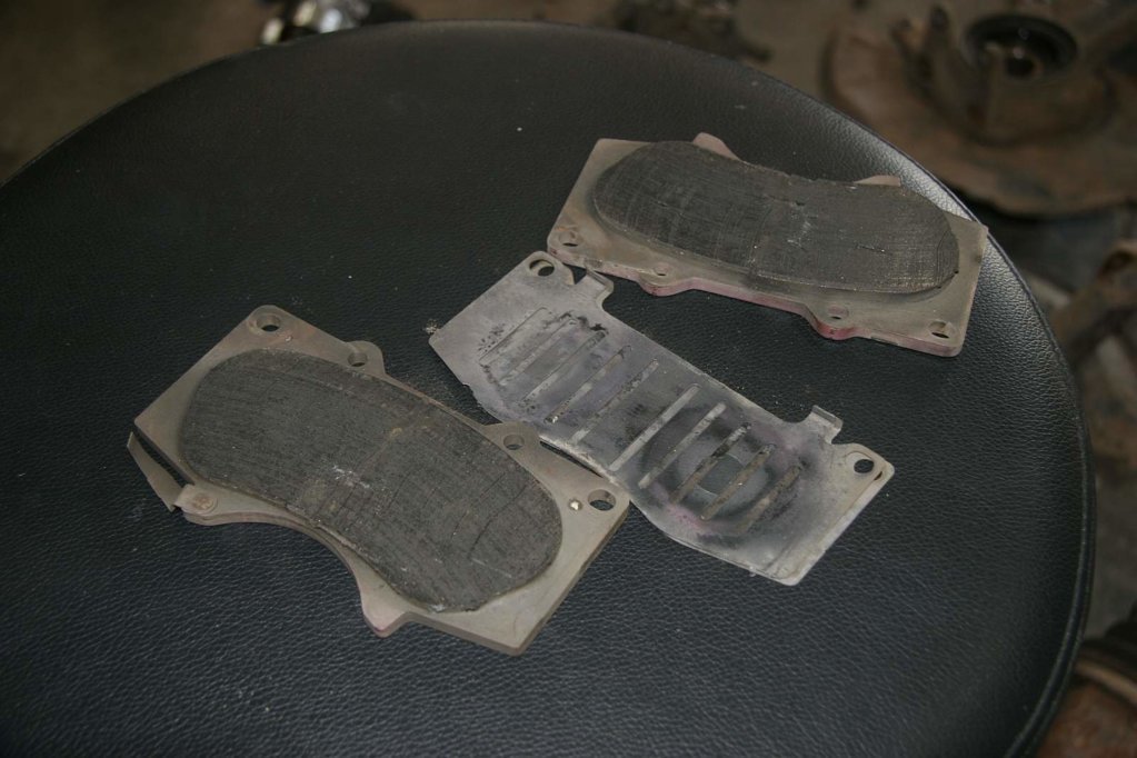

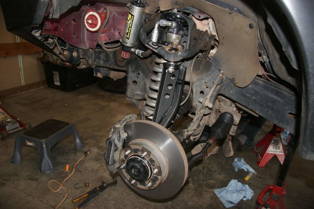

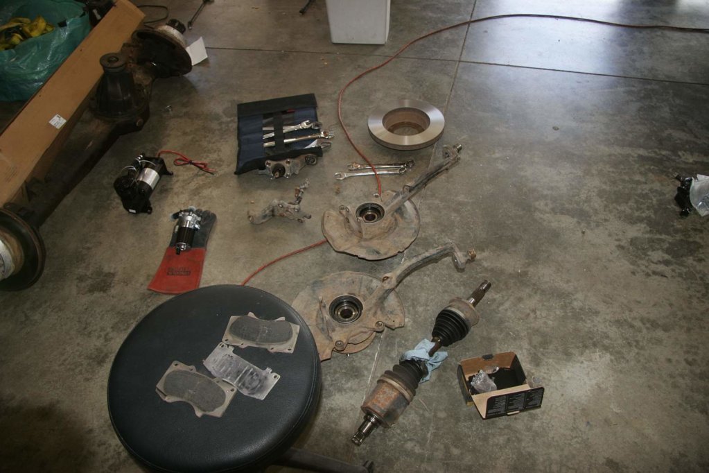

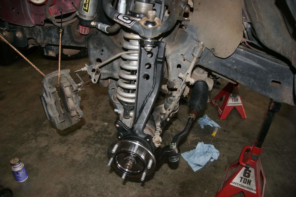

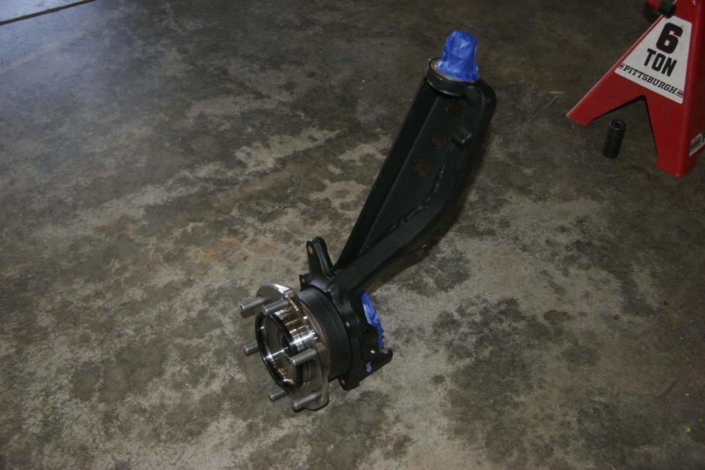

    Thanks to Zane and his shop, I finally got my new reinforced spindles installed. These have brand new hubs and wheel bearings too. While in there, also turned the rotors and installed new brake pads, new outer tie rods and lower ball joints.

    Looks awesome!! How big of a bitch is doing the wheel bearings?
    Also why turn the rotors instead of new ones, iirc new ones are pretty cheap.

    If you have a 20T press and enough dunnage and scraps of steel to make your own press fixture as well as press slugs... not all that hard. Doing the first one took like 45-50mins then the next one was maybe 15. Just had to make a wheel bearing size press slug and figure out how to hold the weird shaped spindle.
    He had OEM Toyota Tundra rotors that were well above minimum thickness still, getting them turned was like $60 for the pair and took an hour. A single new Tundra rotor from Toyotapartsdeal is $78 currently + shipping most other outlets have them near $92 + shipping

    The wheel bearing job in our trucks is intimidating. Timmy has a video on it that does a good job of showing the process.
    As a diy job it is doable with a good press and the right fixtures as Zane mentioned. And as long as you are prepared to deal with the old bearing coming apart when the hub is pressed out. Not a big deal for us as I had new hubs to go in. But if you are going to reuse your old hubs, getting the old half bearing off the old hub raises the level of complexity of the job a few notches.
    My old brake rotors were in very good shape. No pulsing or vibrations under braking. So it made sense to have them trued up. That cost will vary with location. Around here on the wetside I was quoted $35-$40 per rotor. But the O'Reilly's near Zane's place charged me $30 each to do them.
