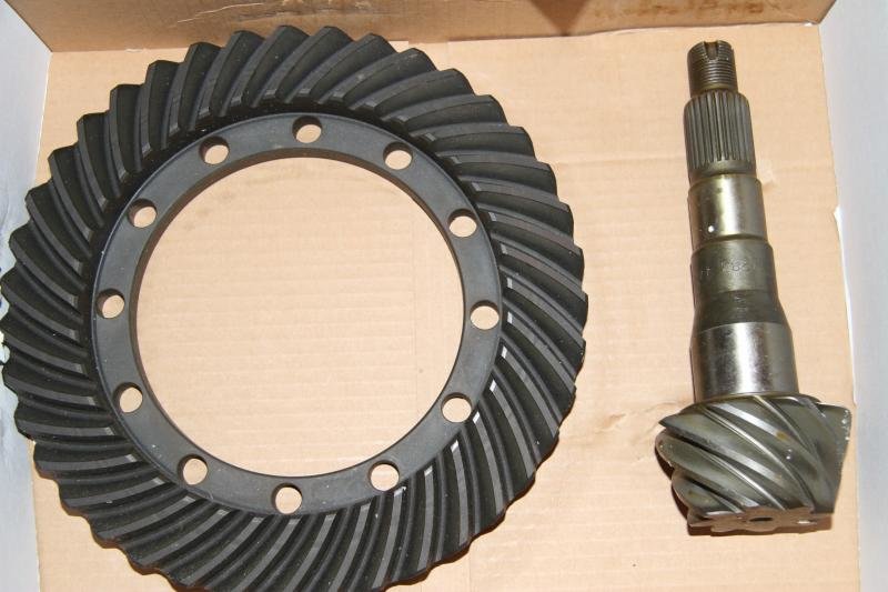

    I think there are actually 2 bearing on the shaft which are oiled by a slinger. I am guessing it is the bearing closest to the flange end, not the pinion head end, that failed. It would be the one most vulnerable to a lack of oil situation because of where it is.

    This may be true but there is know way to know now. Besides, we don't know which of the 2 bearing failed. I assume it wwas the outer one, but he has not said.
    For visual aid. Here is an install kit that shows the bearings.
    Here is a pinion shaft. The shiney spots on the shaft are where the bearings ride.

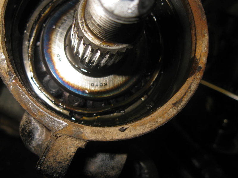

    No they don't. Its an ADD diff. It only spins once engaged. Thus, the reason he was able to drive it home once out of 4wd.
    I really don't want to sound like an a-hole here, and I don't want to place blame anywhere either, but here are some facts:
    The upper pinion bearing welded itself to the pinion and race. It can only do this without enough gear oil in it or none at all. It is impossible for this to happen with gear oil in it as it would NEVER allow it to get that hot. The bearing would have to reach nearly 2000 degrees with oil in it for that to happen. Not to mention wheeling it at slow speeds and angles would still allow for plenty of gear oil to move through the diff. Especially with climbing up stuff. Gear oil would have easily run to the back of the diff(even a high pinion) numerous times during a wheeling trip.
    Now, I have been setting up gears in Toyotas for 10+ years. So, its not my first rodeo, and "if" it was a bad setup I will own it. But, when the evidence is clear that it was a lack of oil that did it, then my hands are tied. I warranty any 3rd for six months on parts and labor unless its been run low or without oil. Its easy to see the evidence. Unfortunately, this is the risk taken when I setup 3rds that were pulled from the vehicle by the customer.
    Here is a pic of the upper pinion bearing. Notice the blue/purple hue on the bearing. This is evidence of EXTREME heat that is not possible if gear oil were present.
    At this point, Joey and I have worked out the fix. We are splitting the cost of parts at my cost and I am setting it up again for free.
    So, even though, I have my evidence, and I know that shit happens and I feel that I am helping him out with getting the rig back on the road for a minimal cost.
