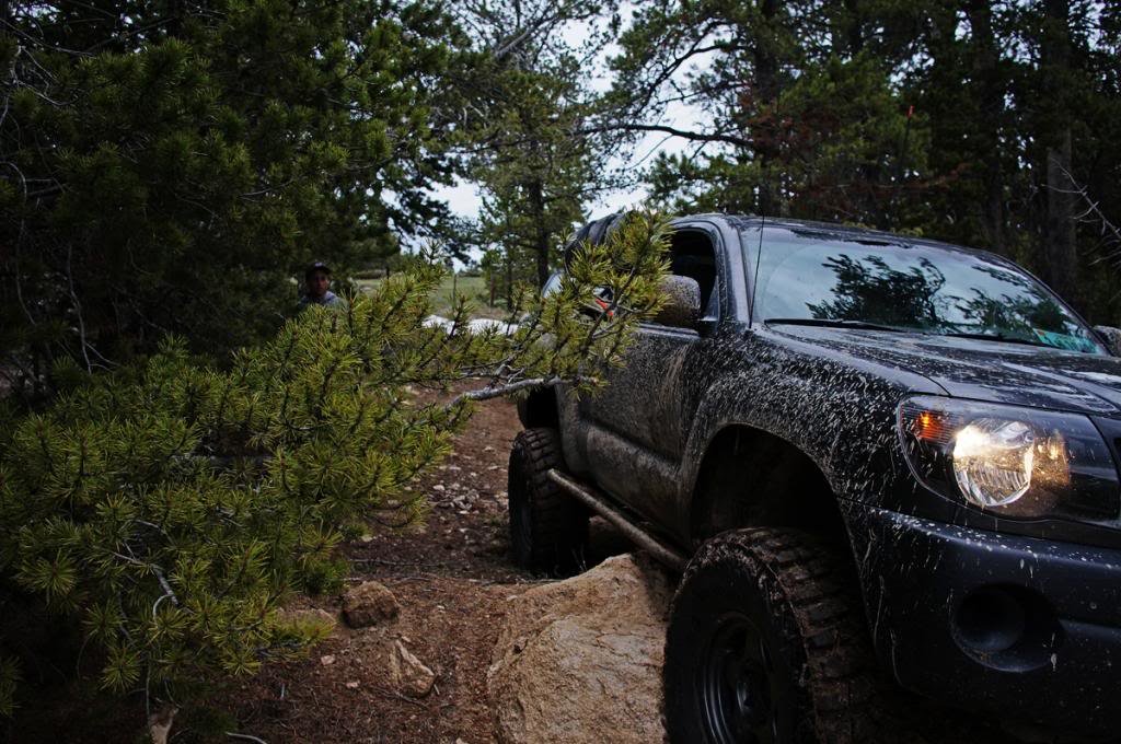

    ^Get to cutting yet?
    Some slider action + Josh's head.

    45acp
    45acp Paint me back in Wyoming again...
    Aug 9, 2009
    #20861
    6,705
    Jonathan
    Boring, Wisconsin
    1981 Long bed 4x4
    Haha took me a minute to notice josh. I was looking for tree branch in josh's face :eek:

    Lol fuck it took me a minute too
