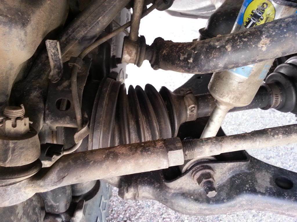

    So i managed to get the front CV shaft boot replaced the other night. I started at 1am and got done around 4:30am.
    before.....

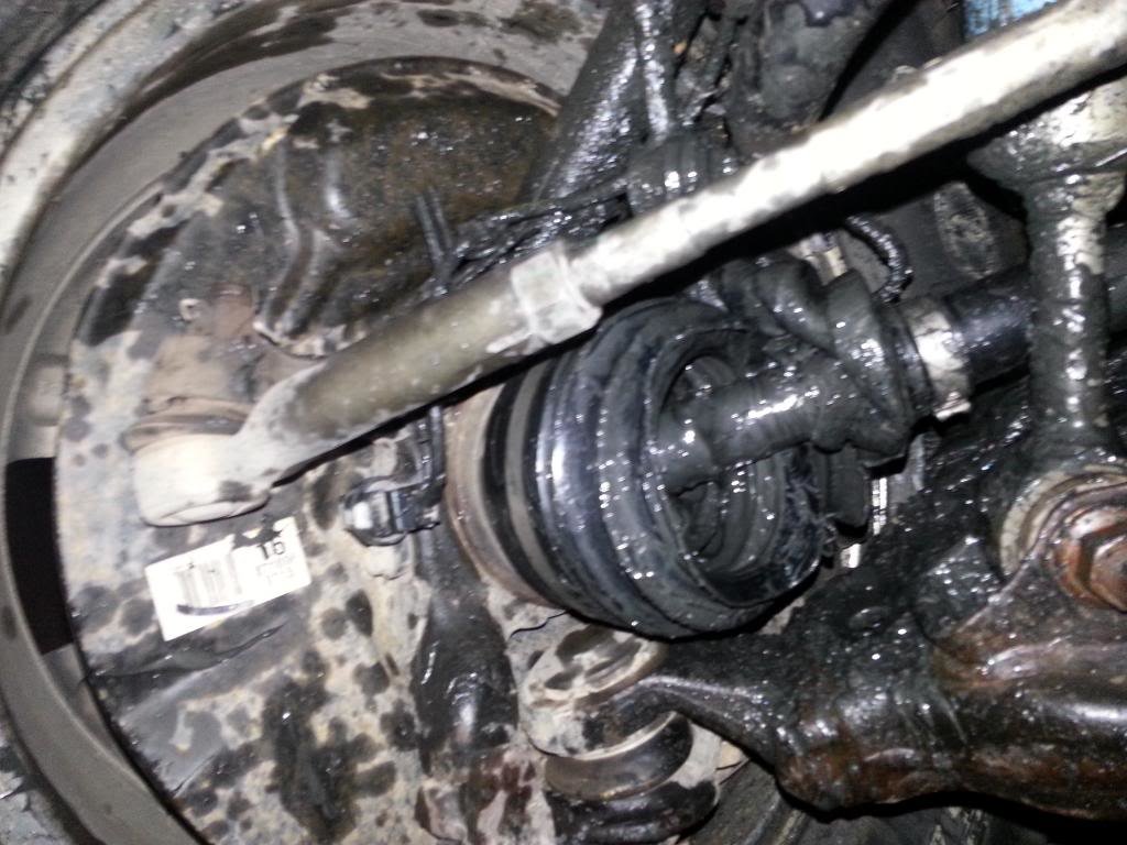

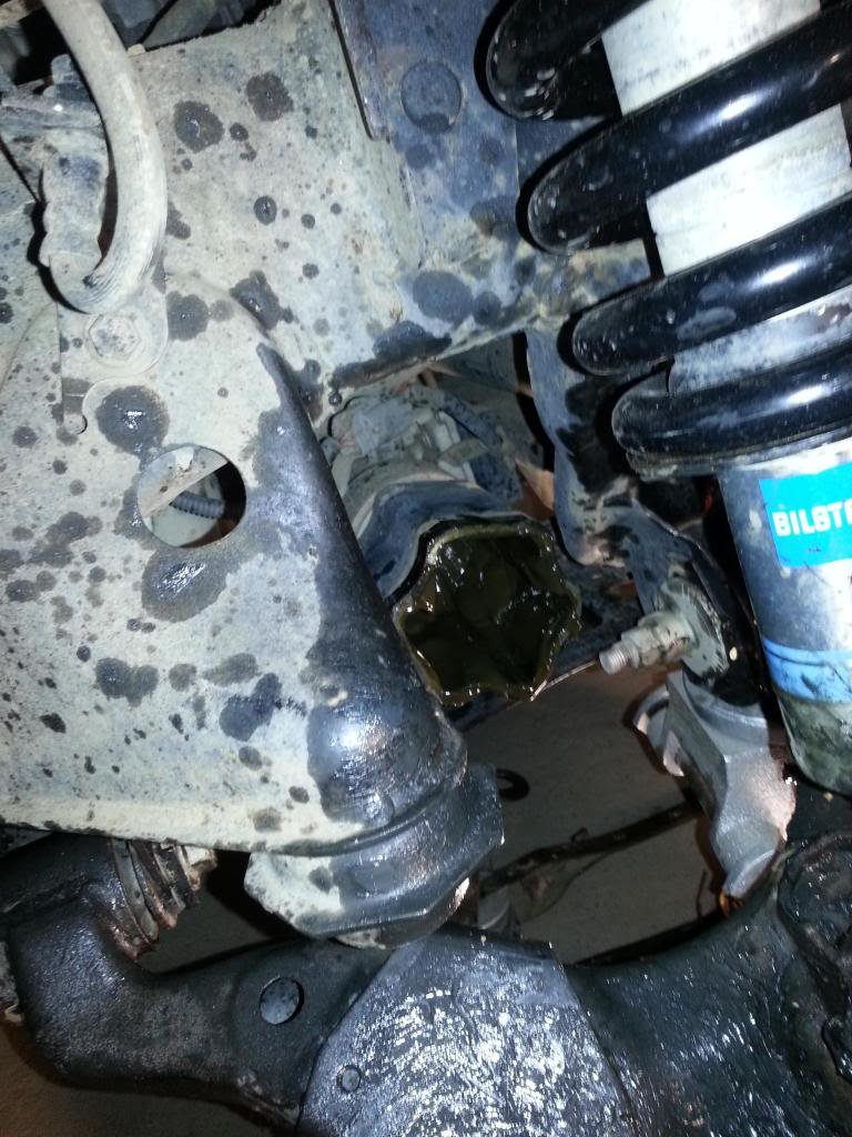

    This is how i got around pulling the whole CV shaft out.

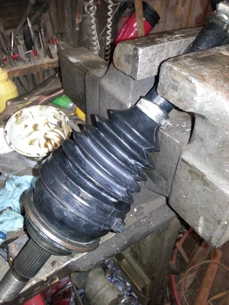

    I had to take the inner roller joint off so i could get to the boots off.
    Here is the new boot installed 20130627_033037_zps688b1e70_6aee8e723dfa8da4961efc0fcc67440c69485b4c.jpg
    Only problem was that both new clamps were 1/2" short so i had to use a hose clamp and left over HD zip ties from my SC install.
    Here is the roller joint with a hose clamp

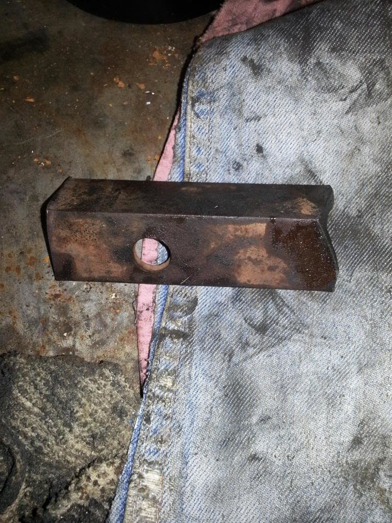

    Here is the tool i made to drive the outer cv off but i couldnt keep it held tight enough to be able to drive it off while still on the pickup.

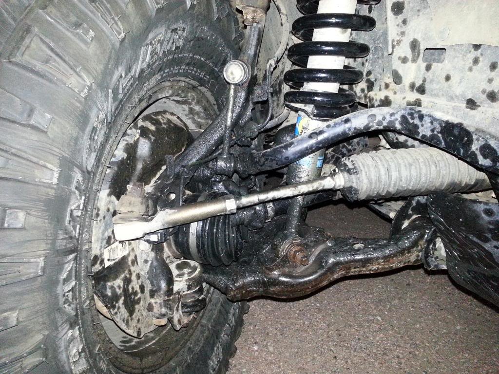

    Here is the new boot after 600 miles
    Only problem i have now is it seems my inner is leaking a little grease now.

    Hmmm..that new boot isn't going to last long.
    Reason they blow usually is from the fins rubbing. That GM OME looks like it has more fins..and rubbing pretty good. If you go feel them you'll feel grooves I bet. :eek:
