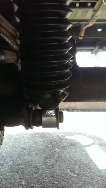

    I am curious if you tried to put the bushing on the shock before mounting the shock on the truck.
    The way I have always done it is to use a table vice to push the bushing in to the eyelet on the shock. The allows the bushing to compress enough to slide into the eyelet. If you do it with the mounting shaft running through the bushing it is a lot more dificult because the rubber bushing cant collapse enough to fit into the shock's eyelet.

    Sorry Buddy, was just trying to offer helpful suggestions. It sounds like those are/were much more difficult than what i've experienced.
    Also, to prevent the bushing from seizing on the shaft, like other things involving a shaft, a little lube goes a long ways. :D

    :facepalm:
    You need to grease them, not wd40. Then they will pop right in. Never put in rubber bushings dry on anything ever.
    I told you you where more like 4" of lift. You need at least 9.5" shocks if not 10s and longer bump stops.
    Using a vice and socket they will go right in or out. Or a piece of tubing or something.
