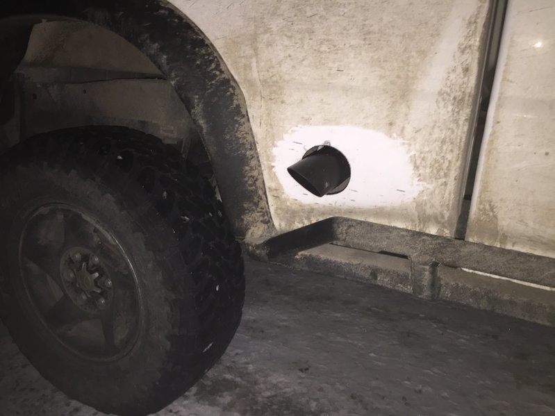

    Got the exhaust on today. Went 3" from the headers back with a 18" magnaflow muffler. Little louder than I hoped when I get on it hard but otherwise it's got a nice low tone to it.

    Why don't you leave the tube flush with the fender?

    Well silly me was hoping that pointing it slightly back and away from the truck would make it quieter in the cab. Which it may be doing for all I know but it still drones under load which I'm disappointed in.

    Yea that's why mine is piped out back still. No drone in cab hardly compared to how loud it is outside. Mines a 14" magnaflow.
    But most I've seen that di side exit like that use an aluminum ring and flush with the fender. Figure that way you don't touch it possibly haha

    I plan on doing the ring with pop rivets, I just didn't make it that far today. I would of gone out the back but my extra fuel tank is back there and I didn't feel like mounting heat shields. And I like doing things that I don't see everyday. I really thought 3" all the way with a bigger muffler would do it for keeping it quiet. Might have to go with a 24". Going to run it for a month or two and see how much it will annoy me. How's Powell treating you?

    Any large exhaust is going to be loud. The reason mufflers and stuff work is because it they are by design restrictive to a point to inhibit sound waves reflecting

    Good to know. I was thinking opposite. If I stayed small it would be high pitched and loud. If I went larger it would be a lower tone and thus be not as loud.

    Lower tone/pitches have bigger wave lengths with travel further and "through" things much easier. Much easier to quiet down higher pitches then low ones.
    The larger tubing also allows for bigger and lower standing waves too. Thus louder and more resonance of the lower times. Which bleed into the cab a lot more and even worse since its exiting right by the cab.

    Interesting. I kind of feel like either I live with the sound and enjoy the boost in performance or restrict the SC for peace and quiet. Maybe there is a happy medium :notsure:. Yeah I fill it up. I think it's 380lbs

    Yea pretty much. Also depends on the rig use I think. If it's just a rig, like mine, let er rip! If it's a dd and you drive the why a lot..Id just get a bigger muffler.
    the side exit isn't helping though. Haha
