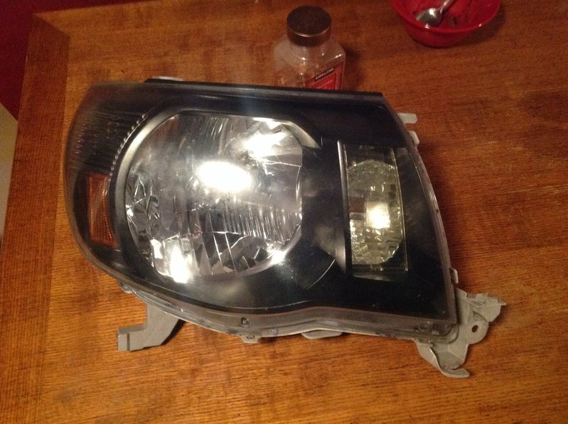

    Done. Turned out great. One more to do.
    FRV will look sweet with these

    That looks good man. I need to do something with mine headlights. How hard did it end up being?

    Bitch too get apart. But not bad. Pretty easy really.

    Hey Monte, was there anything special that you found to keep in mind or do while doing the headlights? I think I might do this, but I might practice on my 4Runner first.

    What does baking the headlight accomplish. More flexible so it doesn't break taking it apart?

    The headlight
    Nah just go slow. Pretty easy.

    Yea have to warm the silicone to split the lens. Super strong stuff. Bake it for 8 mins at 200°

    Yea the goo between the two halves softens up so you can pull it apart.
