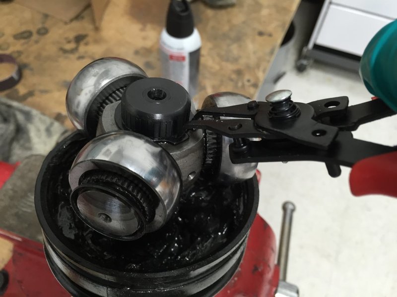

    Yeah, to access the snap ring for the outer tulip you have to "hammer" it out. But, what's the point of getting access to that snap ring is what I'm not understanding I guess. Because at that point you already have access to both boots.

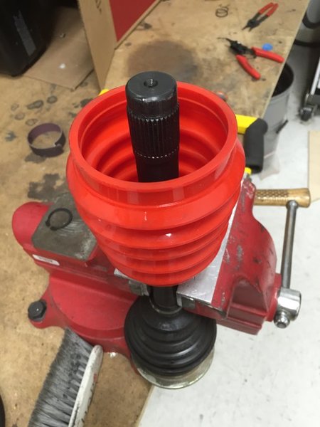

    Only the inner tulip, which the snap ring for that is outside the tulip like this. Once you get the inner off, you can slide both boots off the open end you created by removing the inner tulip.

    But if you already have the inner tulip off, then you can slide off the inner boot, then the outer boot. Then slide the new outer boot on large end first, then slide on the new inner boot small end first.

    Does this pic help?
    With the inner tulip off you should be able to remove both boots, right?

    Yea I dont see why you couldn't do that. What Id do.

    Cool. That was my thoughts exactly.
    The only rebuild how-to's I could find weren't detailed enough to explain why or why not. But since the FSM doesn't even mention removing the outer tulip, I figure I'll just leave it be and clean it out while it's still connected.
