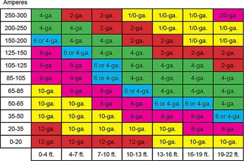

    0/1 or 1/0? I guess it is all about how long the run is and how many amp might potentially go thru there.
    My first reaction to one ought was that is overkill but after looking at this chart, I'm not as sure. I figure the run is 10-13 feet so 1/0 gives me 250-300 amps max to work with. Someone suggested 2 ga. was enough, but your saying naw to that?
    For some reason, I recall 4 ga. is what we used for the alt. I kno that is what the winch power and ground are. Also the stereo amps are 4 ga.

    yea we used 4ga on the alt. But i meant the same quality of wire is probably fine. THe kicker stuff is super expensive.
    yea id go with 1/0 at least. not 2ga. the 0/1 will be fine. The alt and starter battery will supply the winch the most even if the batteries are linked due to the resistant of the long wire run. And if you link them to start the truck for a self jump, you won't need more then 200amp anyways at the most.
    So 0/1 will be good.

    You think a 200 amp capacity is enough? The chart says 2 ga. is enough for 200 amps. I think I need to nail down exactly how far it is between the starting batt and a batt in the bed.

    Id just get 0/1. Save you the trouble of exact measurements and then you're good to 20'
