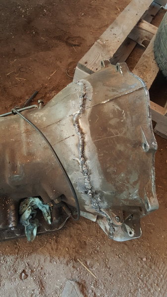

    My first aluminum welding project.

    Looks like the boges I just pulled out of my nose :p probably better than my first go would be right now.
