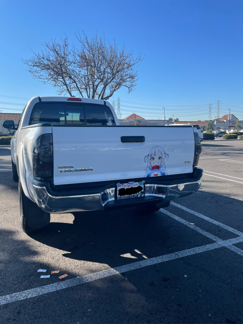

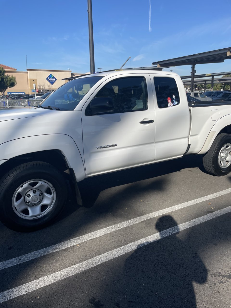

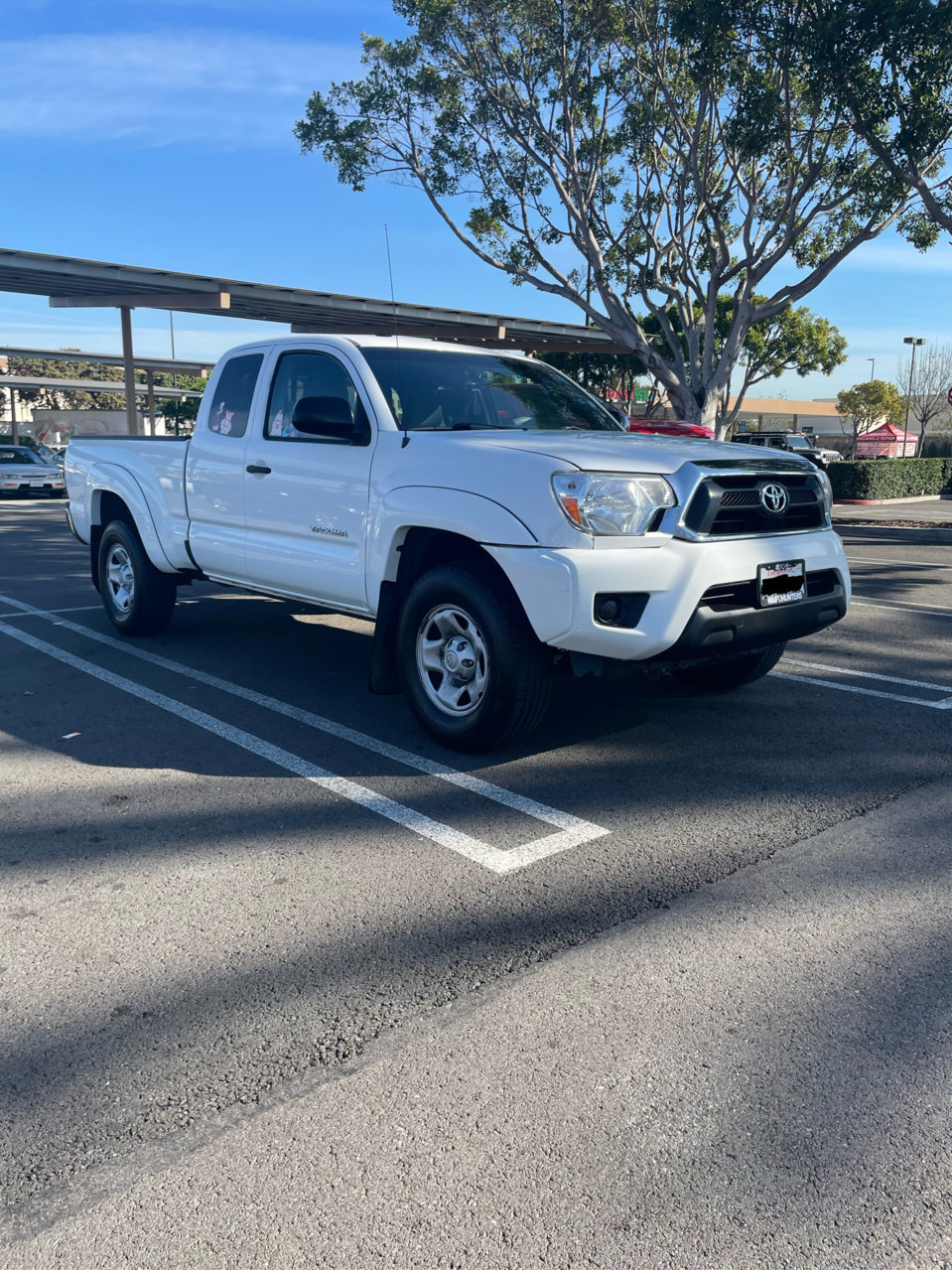

    Hello peeps! Hopefully I’m in the right thread but here’s my situation. I have a 2012 Tacoma SR5 prerunner that I want to convert to an X-Runner using a body kit of some sort. I was hoping you guys can help me find a body kit from a website or something that way I can be on the right direction with my build. I should probably post some pictures of my mode of transportation for an idea. AE17EF39-2F54-4EC3-B7B2-9ED1597A9559.jpgA1E6E38A-4FF1-4B25-AE34-722D340D19A2.jpg FE64DD04-DCF6-4B11-B3AF-679A4AD1C710.jpg
    Don’t mind the V6 badge, trying to get rid of it with a custom badge, mines an I4.

    The X-Runners are built on the 5lug frame/platform, your 2wd Prerunner is built on the 4x4 frame/platform which sits much higher.
    I don't think there is a body kit available to match the x-runner's, but even if there was you would need to lower your truck's ride height quite a bit for it to look like an X-Runner. Which will be tricky because it's on the 4x4 frame.
    it will take a lot more work than just a body kit. And X-runner suspension won't work on your truck because the frame is different, at least not without a lot of fabrication
    it would be much easier to convert a 5lug Tacoma into an X-runner than a 6 lug Prerunner to an X-Runner

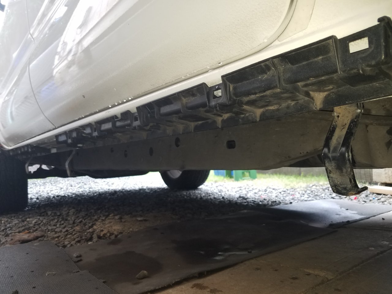

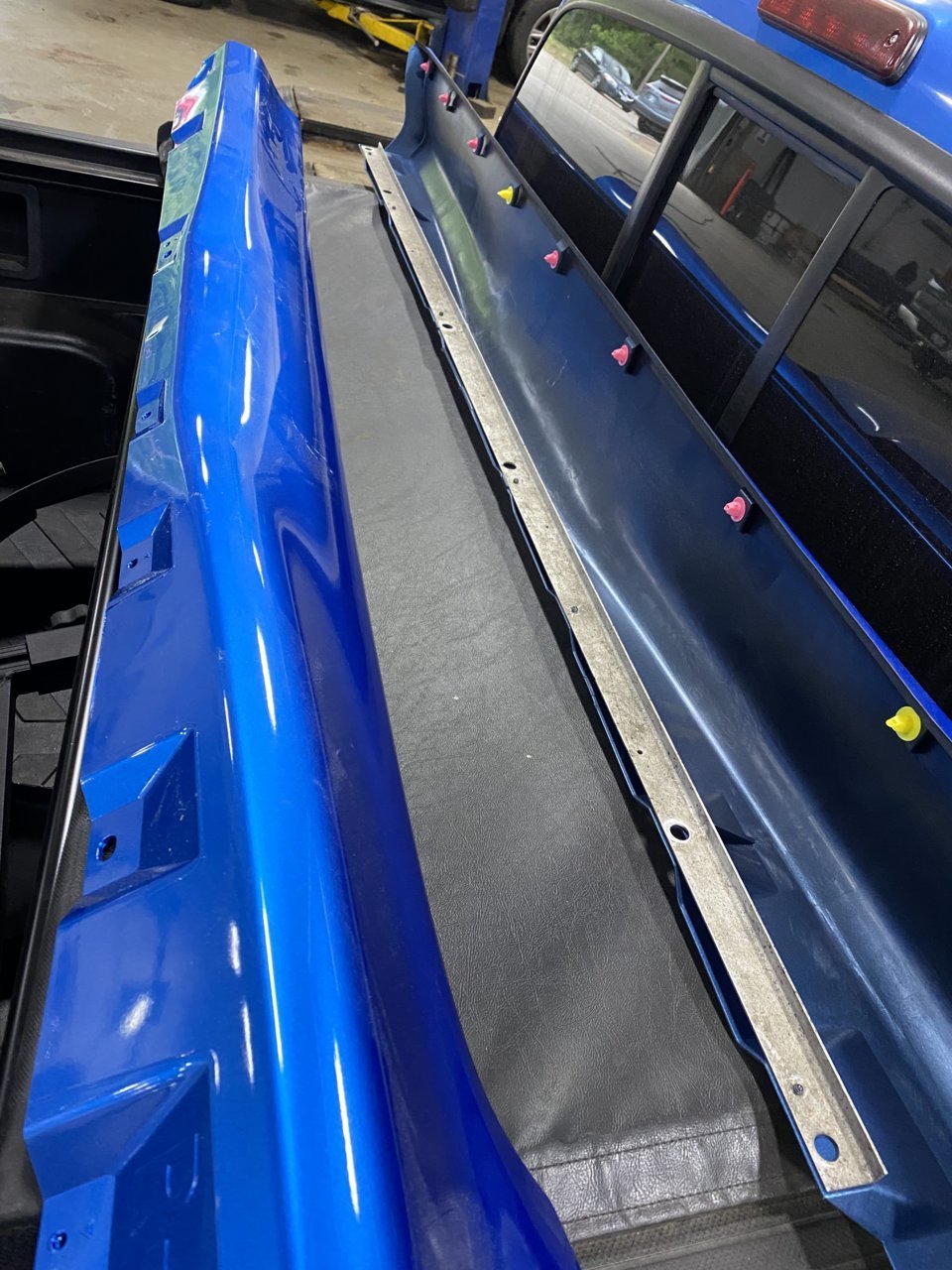

    Easiest way is to get all the parts. You will definitely need cab mounting brackets to mount side spoiler . You can make support bracket if you want to. 3 brakets on bottom . Need all clips to mount side spoiler. Second pic off internet .
