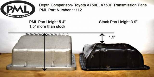

    How's the space limitation? Even slightly deeper for more capacity or same capacity using internal baffles with optional cooling fins would be beneficial. I have the extra capacity transmission pan from PML and can appreciate these kinds of upgrades. I'm sure the boosted bros would too. Even if the spacer with baffle were an option...
    Borrowed from PMLcovers
