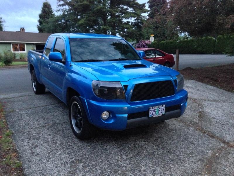

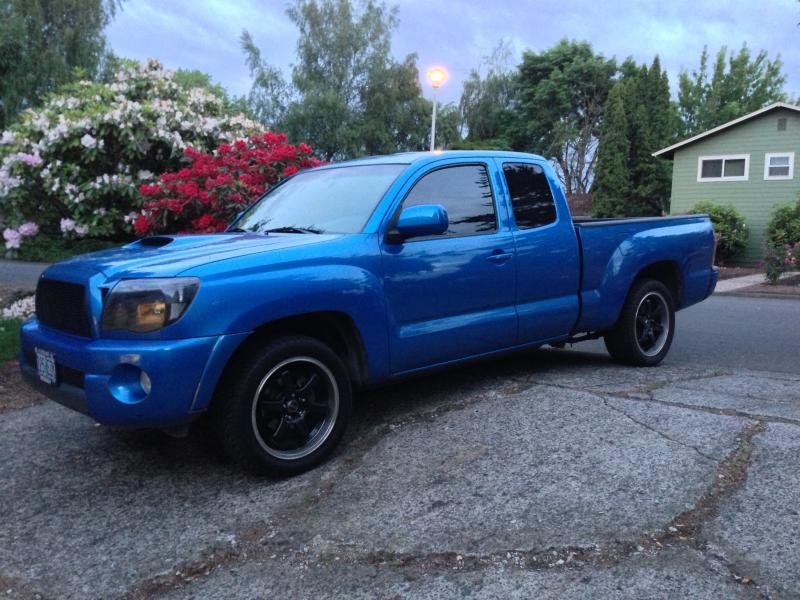

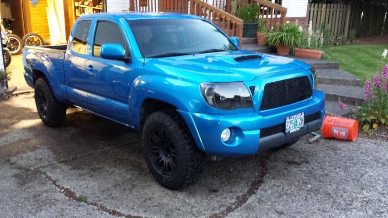

    All done, Could not be happier with the results for how little this cost. I did all the work except wheels and tires.

    I wish it was a 4cyl at times, Well the V6 is nothing special for power it has much more power with the smaller tires but oh well all show no go.
    Thanks! I ended up putting the lift (AAL and spacer) on my birthday. Front went on within 1 hour the rear was a different story. Trying to compress the leafs was not fun.
    Thinking of a full front off road bumper or avid off road light bar and a 30" LED but I am undecided.
