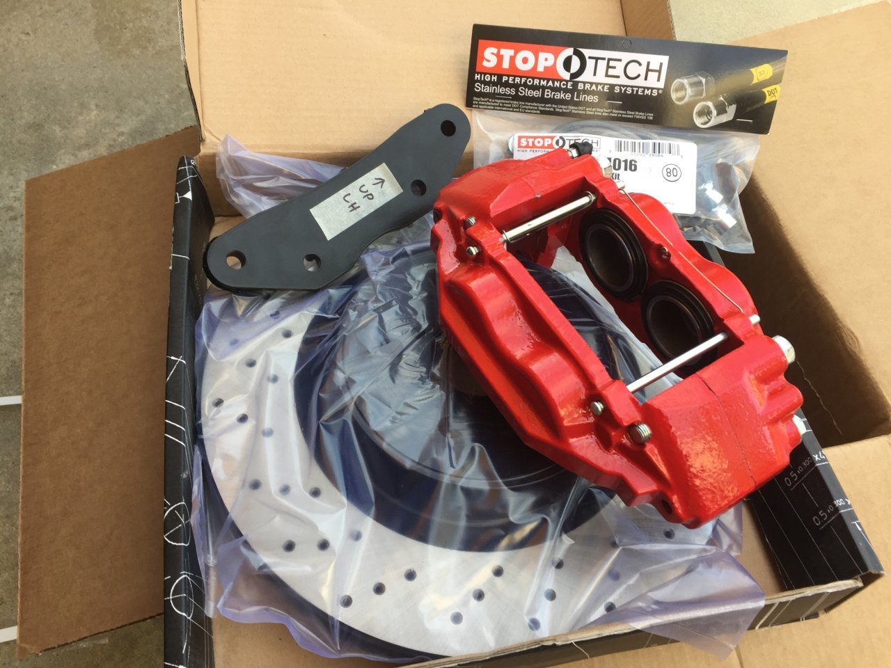

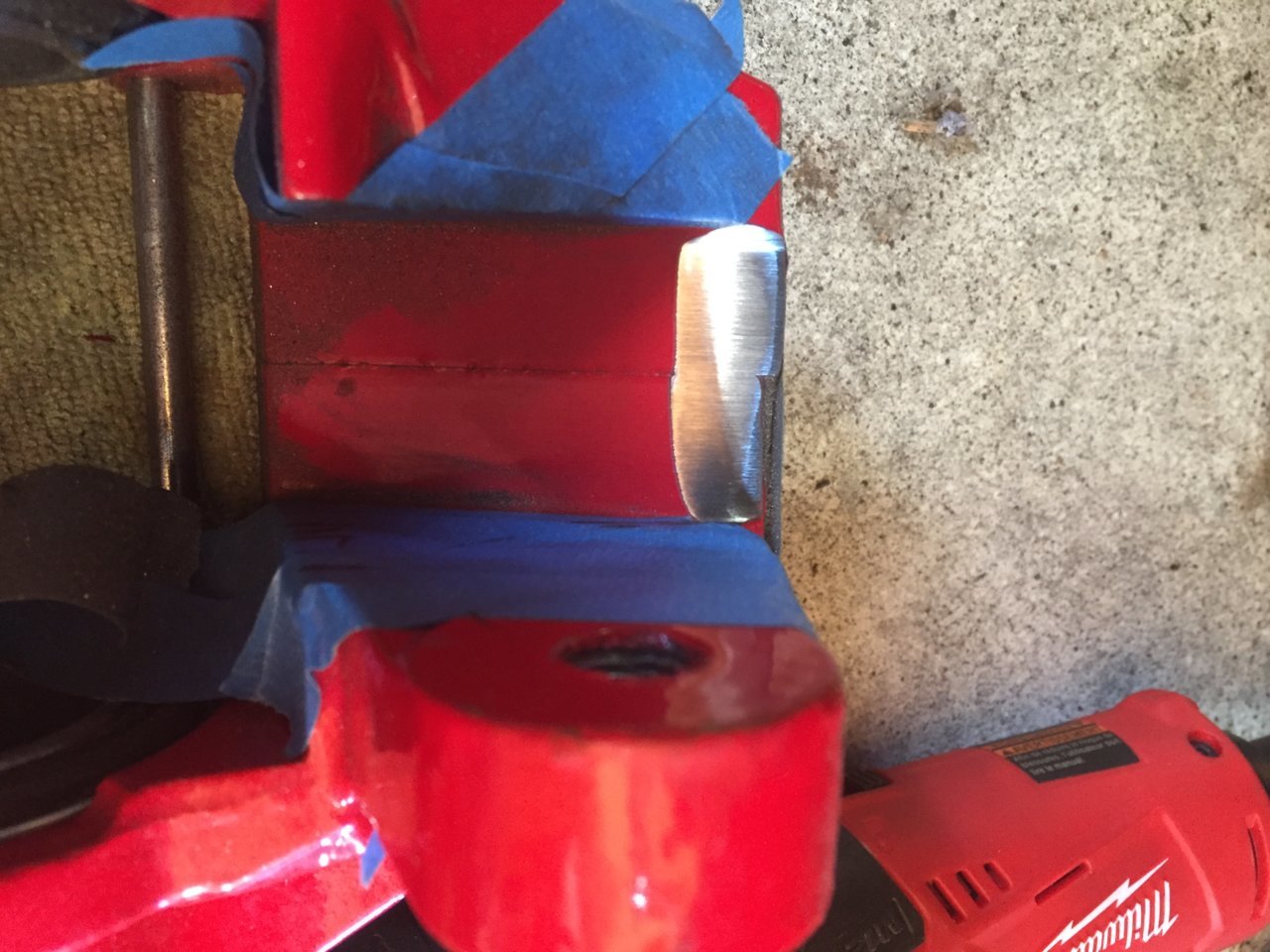

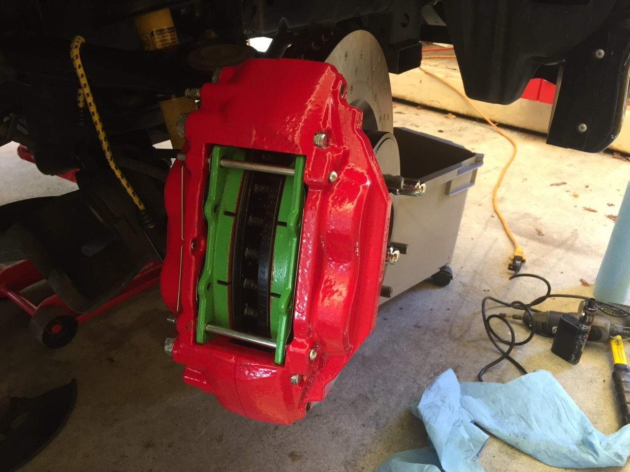

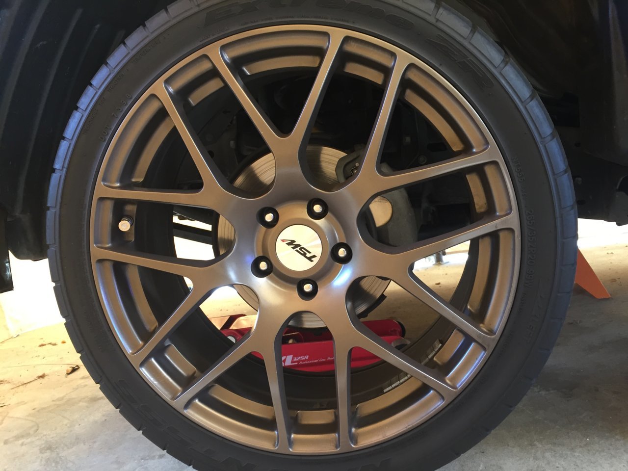

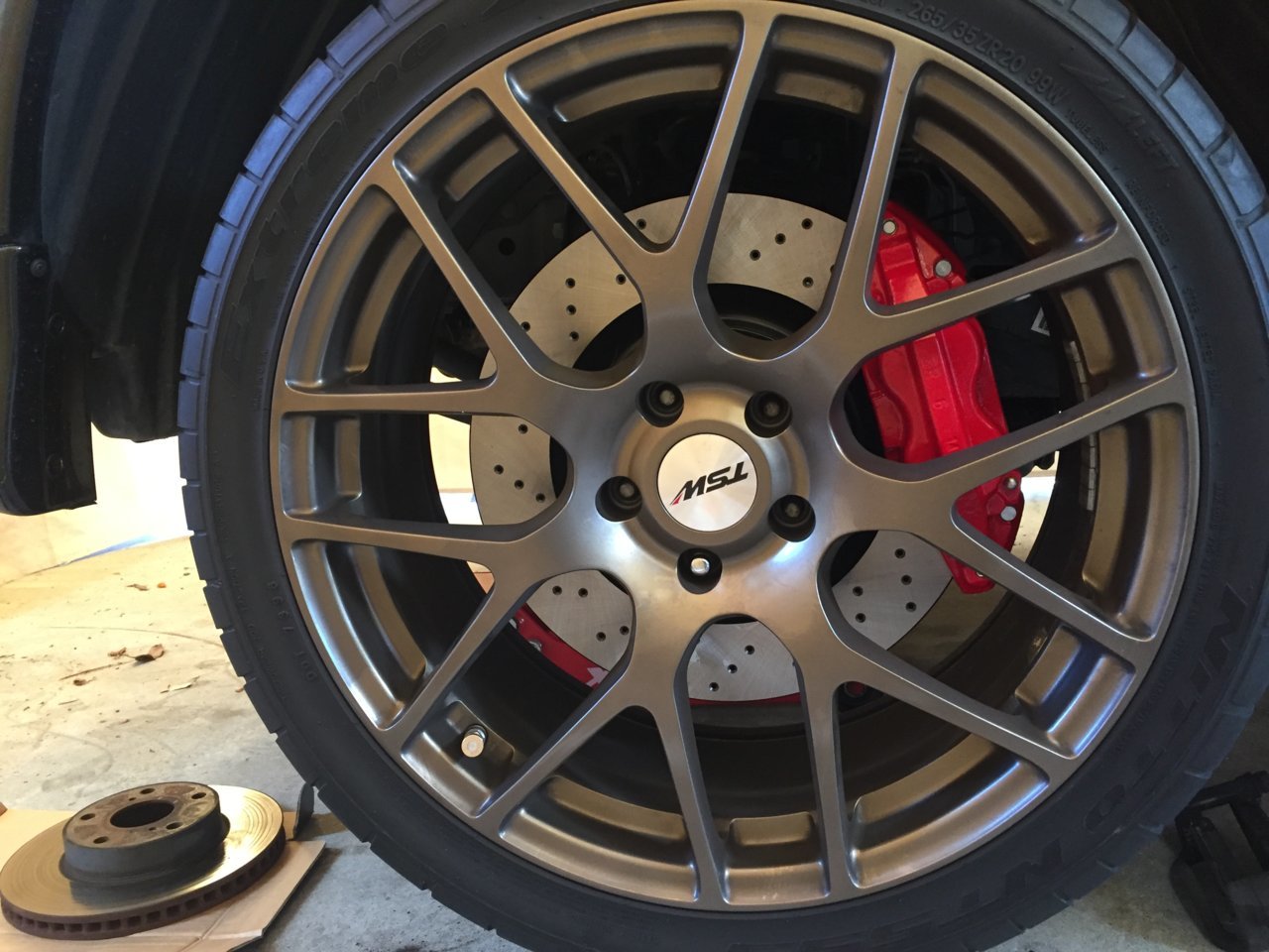

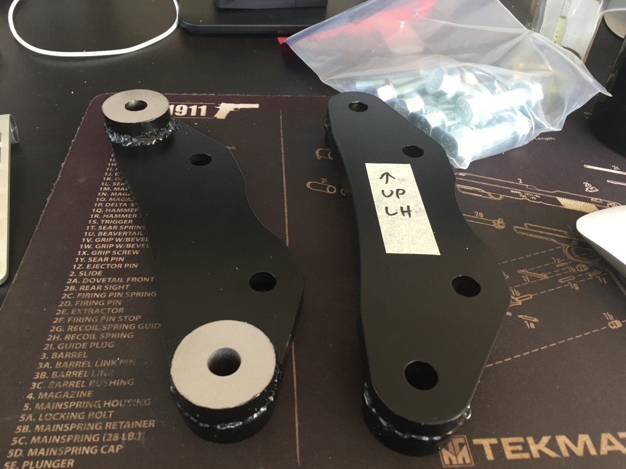

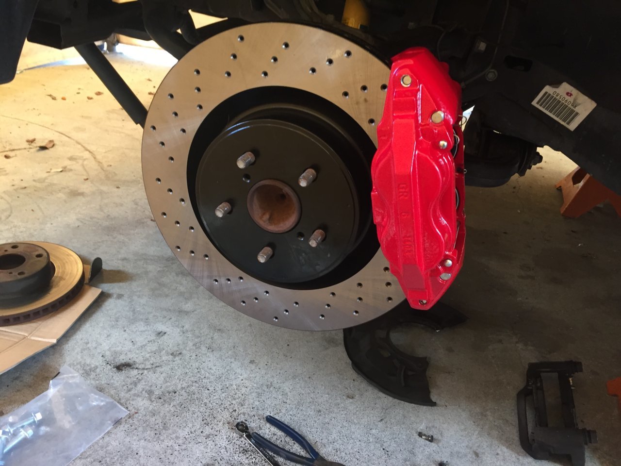

    The one part not off the shelf from any auto parts store is the caliper bracket. Used to be a guy on the X-Runner facebook group that made/sold them (looks like the Strictly Street bracket was inspired by it).
    I got the brackets from him, everything else (new powdercoated Tundra calipers, Stoptech Lexus IS-F rotors and steel braided brake lines and EBC Greenstuff pads) came from various sellers.
    It was a bolt on deal save for having to clearance the inner radius of the calipers a tiny bit as they were rubbing on the rotors ever so slightly.

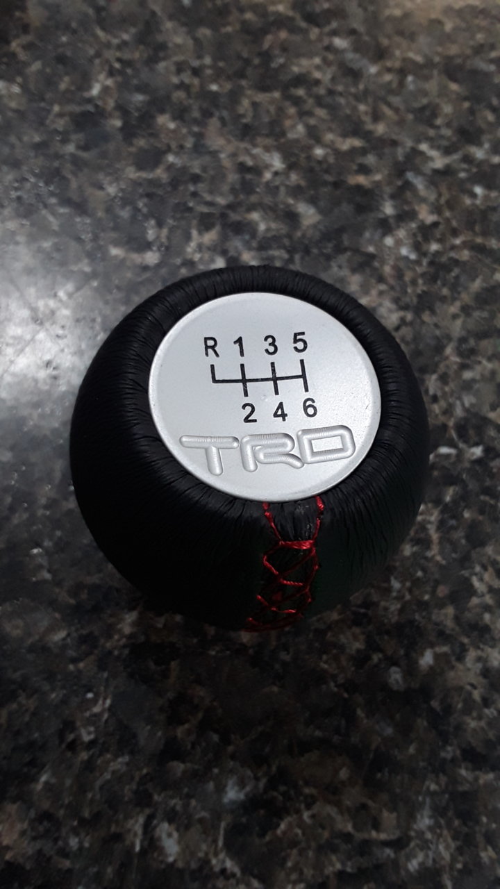

    20201117_132927.jpg just got this in today...

    I had one of those for a while. Nice piece. :thumbsup:

    Where did you get this? I am looking for a shift knob that doesn't feel like a block of ice in the winter.

    yeah it feels solid and has good weight to it.
    also it was pretty cheap considering, but took almost a month to get in.
