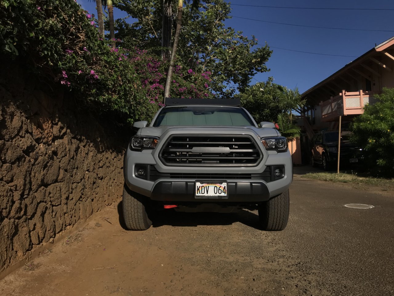

    no intentions to. Although the TOYOTA or a TACOMA emblem would and has made these look very OEM, I wanted this grill specifically to get rid of all branding and chrome That I could on the truck.
    Thank you for making it possible.

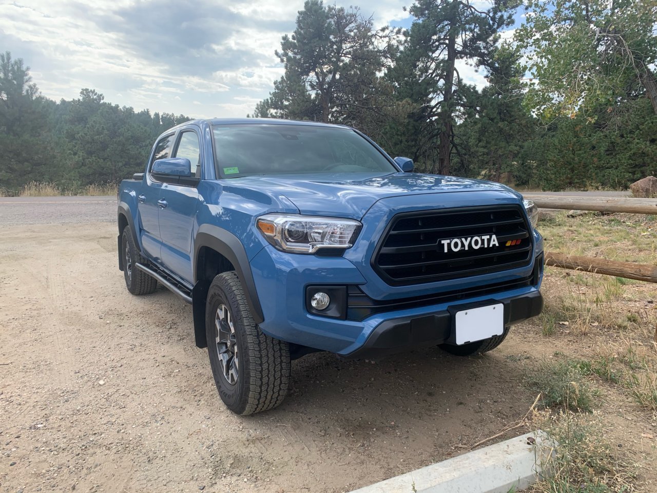

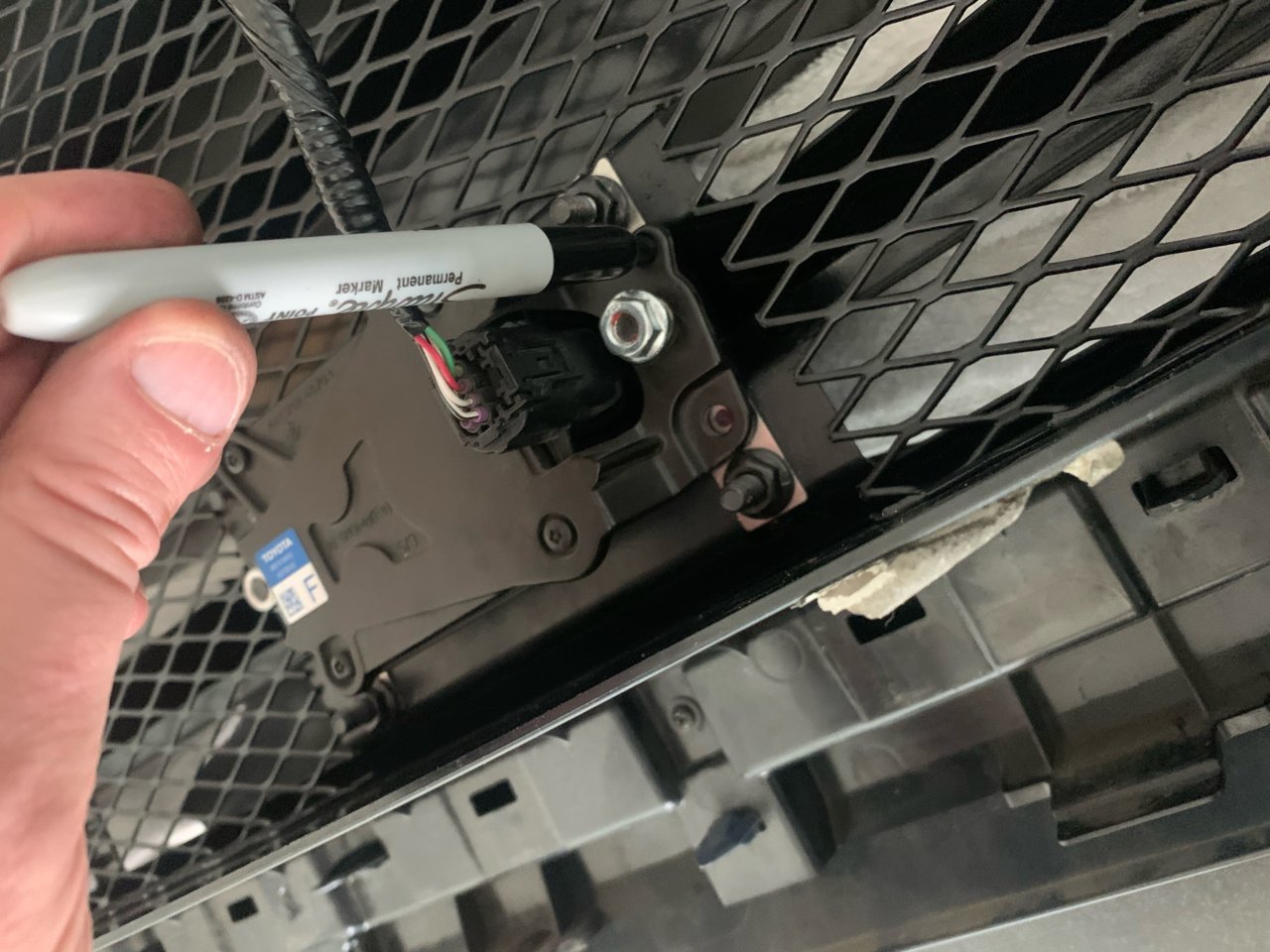

    Got mine, looks great!! I think it looks good without the logo and will prob keep it clean. This post is going to focus on installing the TSS sensor. I had to do it over because mine was throwing the "clean dirty sensor code". Once I redid the sensor install and made sure it was centered exactly its been working without any issues. Here is how I made sure on the second attempt I got it centered.

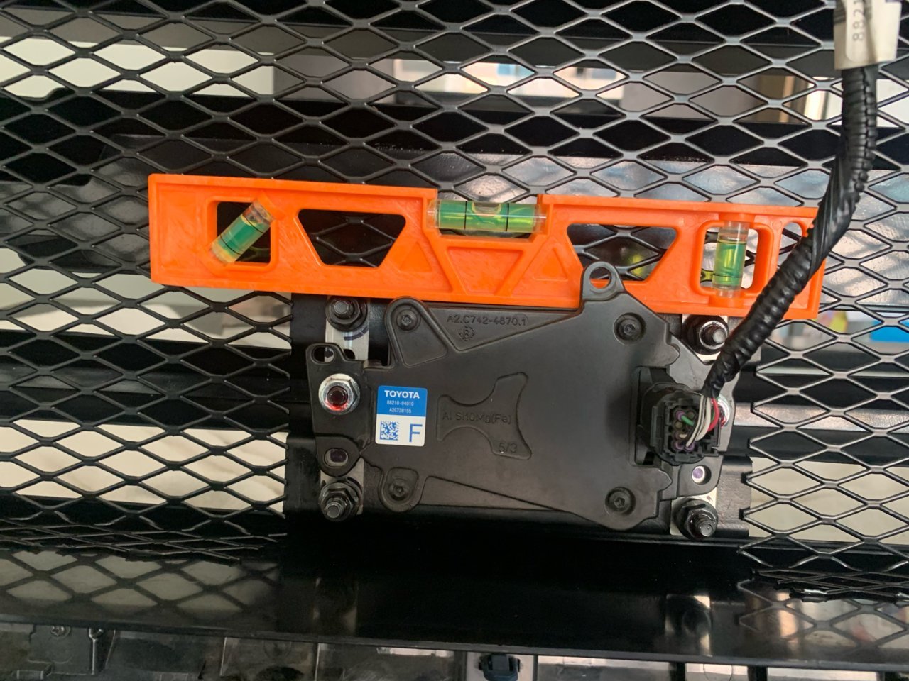

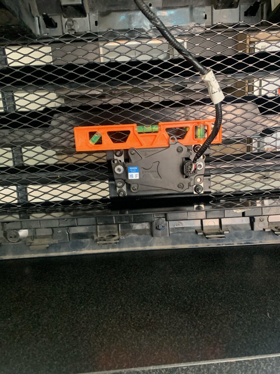

    Make sure you disconnect the battery before removing grill and sensor. Also please make sure all the hardware is included. Mine was missing some of the bolts and washers. Not a big deal, but it can be a bummer if you discover that after you have pulled the grille. So the instructions have you mount the sensor to the brackets after the brackets have been installed on the grille, I found it much easier to mount the sensor to the bracket first. It is real hard to tighten the sensor to the bracket after it has been installed on the grill because the backside of the screws are hard to reach. So first mount the sensor to the bracket and tighten it just enough so that you can still slide it around but it will hold its position. Here is the side view of the bracket with the sensor attached.
    Next mount the bracket to the grill and also just tighten the bolts enough so everything stays in place but you can still slide around to center the sensor. Try and get the sensor right in the middle of the opening "V" portion of the grille in front of it. Stand the grille up and use a level so that it is nice and straight.

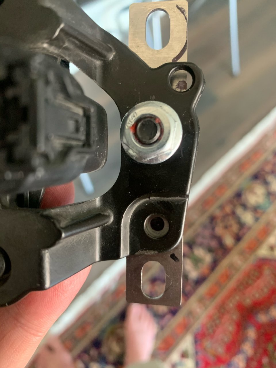

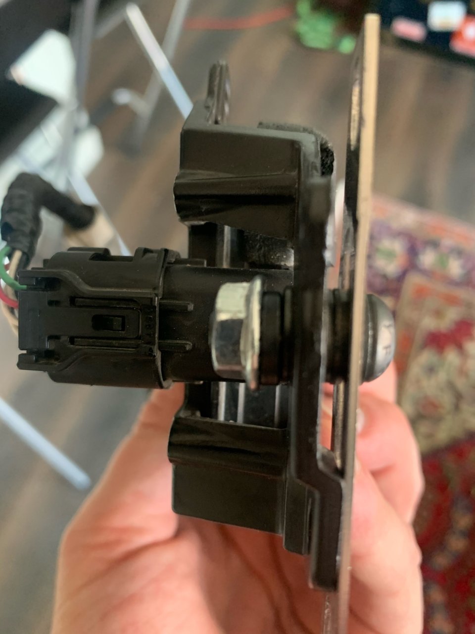

    After you have everything nice and pretty use a sharpe or something to mark up the bracket and sensor to record their current positions.
    Take everything apart and now tighten up the sensor to the bracket using the marks you just made.
    Now reattach the sensor and bracket to the grille, also use the level one last time to make sure you are back to where you were when marking up the bracket. Once you have everything nice and tight add some threadlock if you feel like it. All done! Hope this saves you some time.

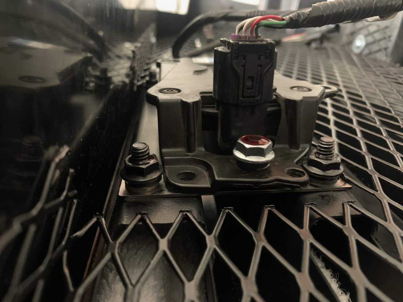

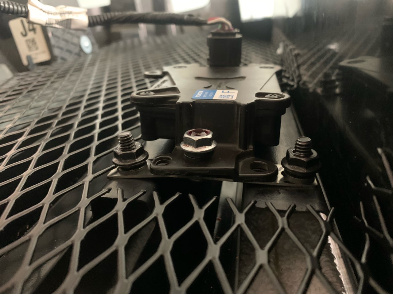

    And here is a couple side views of the mounted sensor, might help get some situational awareness. Left side and right

    thank you very much for taking the time to do this write up and document. Mine has been throwing the light periodically. (I did the install with minimal effort just to get it on) Nice to have a comprehensive guide of someones experience for reference.
    p.s. looks great either way! Nice to see it against a blue tacoma as well!

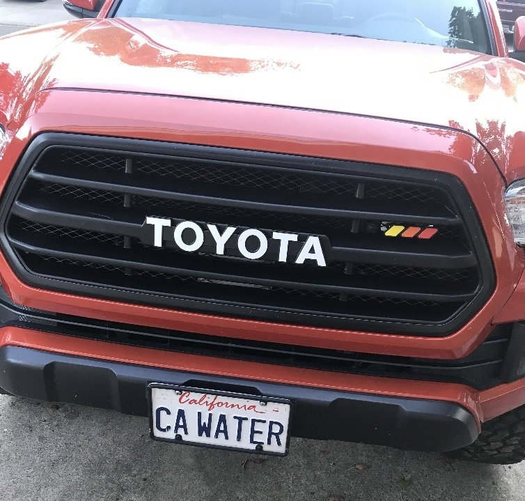

    Looks very clean, nice touch with the yellow, orange, and red badge mounted to the mesh. I really appreciate the feedback and the detailed write up, thank you. I'm always trying to make my products the best they can be and as user friendly. I will be taking your feedback into consideration for the install guide as well.
    I've had a few customers reach out getting the "clean sensor" message and every time we have been able to make it work no problem with minor adjustments. Some fixes have ranged from the sensor not being level to even some some customers who just forgot to plug the sensor back in haha. I did a lot of testing with this grille on several different Tacoma's for long periods of time and never had any issues with it.
    Once I get some time I will be making a video install guide to help with the technicalities. At the end of the day if you can bolt 6 bolts together, you can install this grille.
    @Coolfinedonewicked send me a picture of how it's mounted and I'm sure we can get it figured out! My guess is that it's just not leveled or maybe the washers didn't get installed under the sensor?

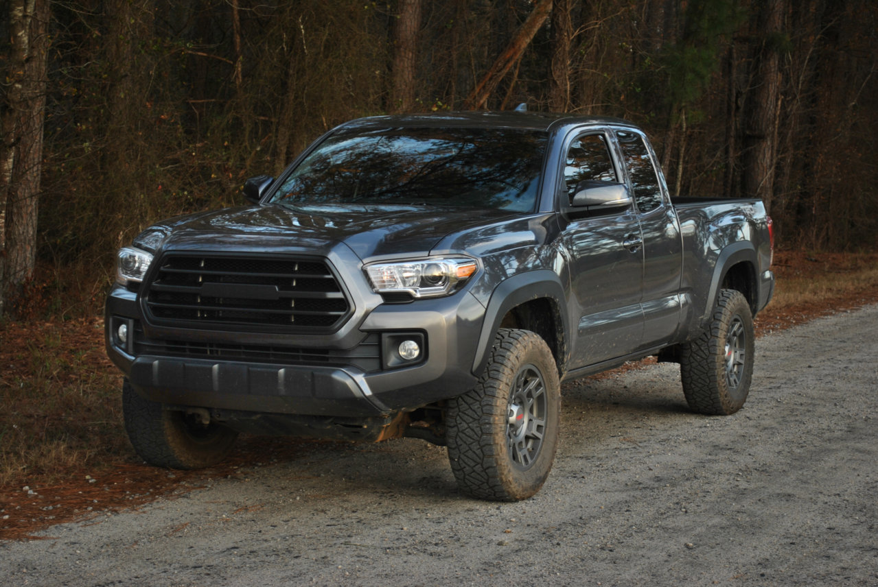

    @watkins303 you really hit the ball outta the park with this grille

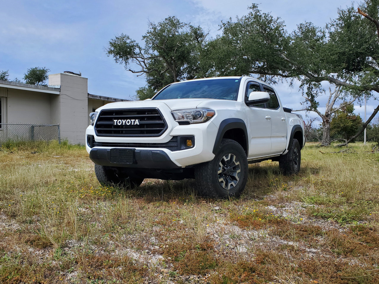

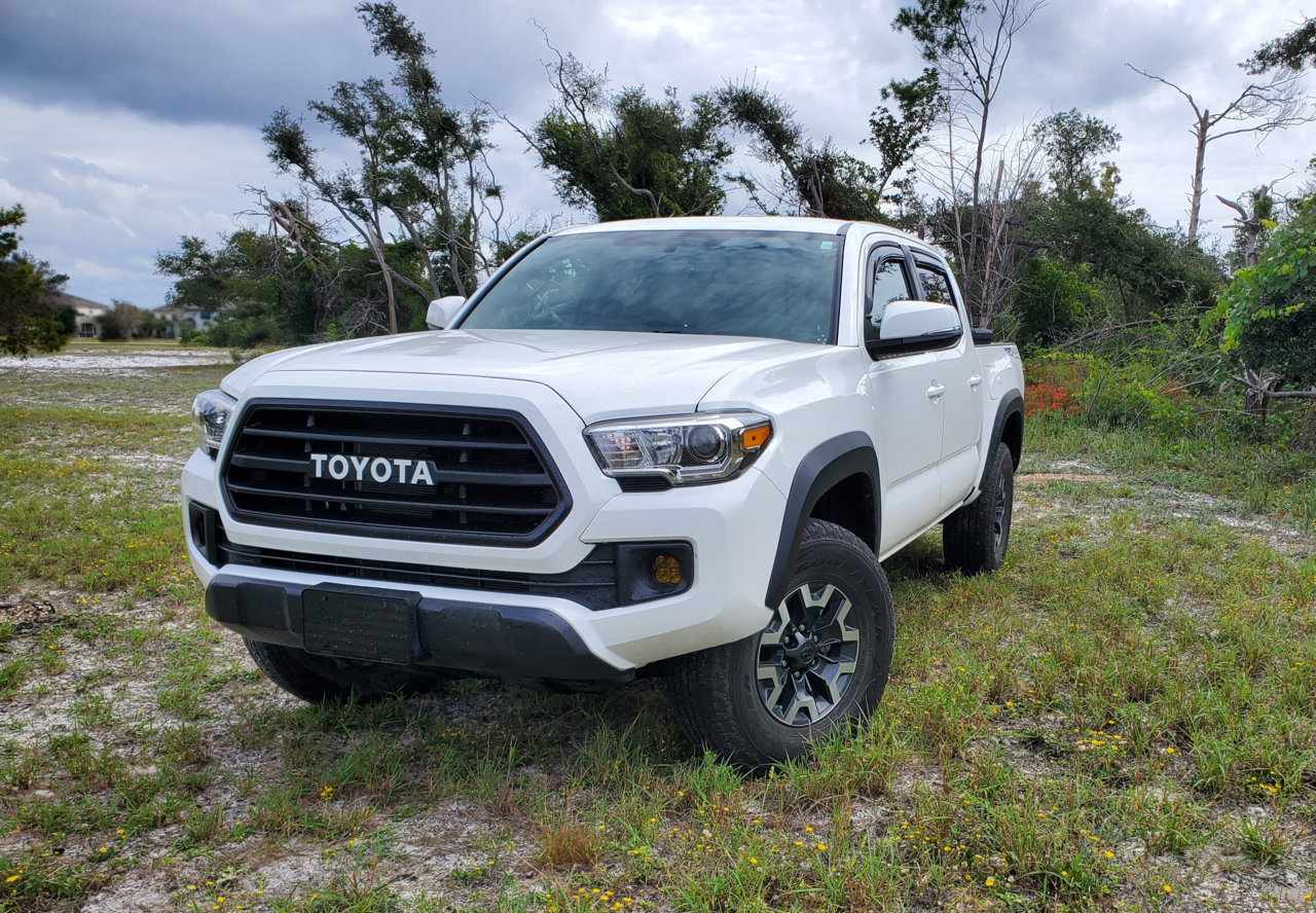

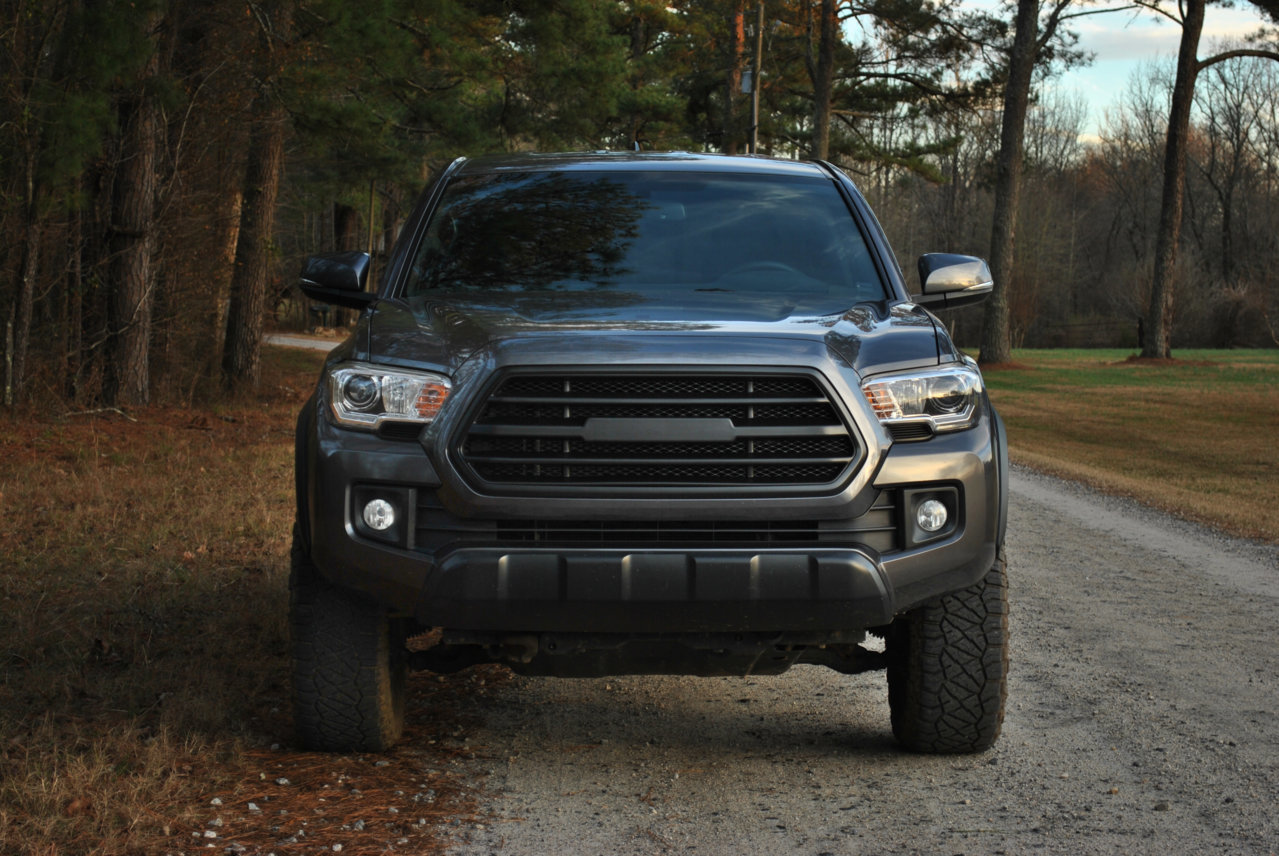

    Looks great!!! Thank you Travis!

    so clean. great job on the pics

    Looks awesome! Thanks for the pics, great job!
    PM me I have a very simple fix.
