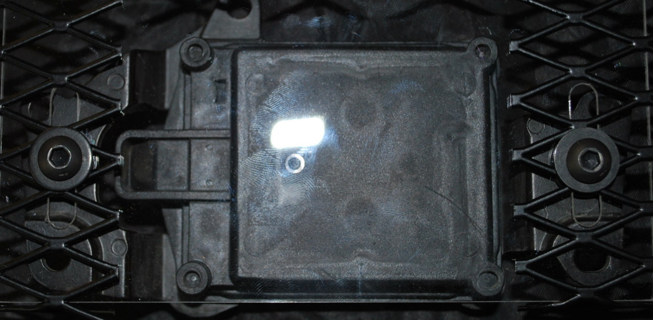

    Thanks, based on the interest I've gotten on this thread the pricing should be able to cover everyone who will actually pull the trigger on purchasing the grille/mesh. I will be giving everyone a heads up and a time when I put them up on the site.
    So far the testing has worked really well like this. The sensor does sit directly behind the lower bar on the grille. Also not sure if you can tell or not but there is a piece of acrylic in front of the sensor to prevent rocks, bugs, etc.
    There is no acrylic in front of this sensor as this mesh was just a prototype but to give you an idea of where the sensor will sit check out the picture below.

    With the sensor set up like this, the bar in the grille doesn't effect the way the sensor works? I like the way its coming togeher!

    Thanks, after testing we found out that as long as there is no metal in front of the sensor, it's at the same pitch and yaw/angle, and the plastic is not super thick, the sensor will work fine. Since the grille insert only serves as aesthetic purposes it's not thick enough to have an effect on the sensor. The sensor has worked as it's supposed to during the testing.
    Seems like the sensor in the stock grille bascially works the same, it's mounted behind plastic and acrylic in the emblem.
