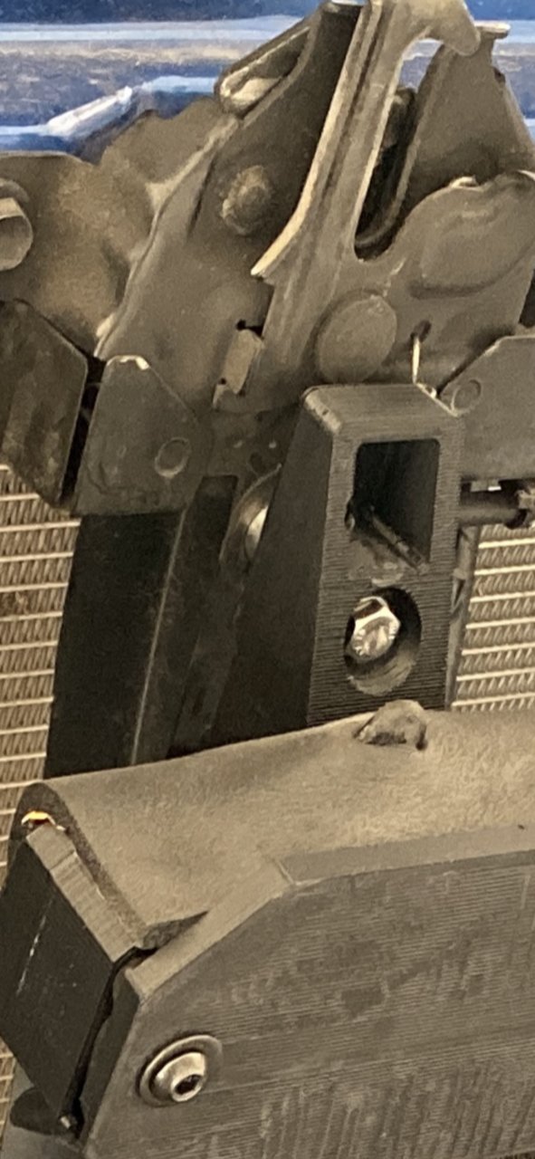

    Had to space it out from the support to clear the tab on the latch .

    Yes this mounted the TSS behind the grill on the middle support bar . Driving ever day the past two weeks in rain and sun shine with no issues so far . Everything on cruise control works as well .

    Haven’t seen where there could be a problem . It’s pretty much a sandwich . The TSS is in between two parts and bolted together . Found this part as the tundra guys have been using this for a while to run grilles with out tss mounts .

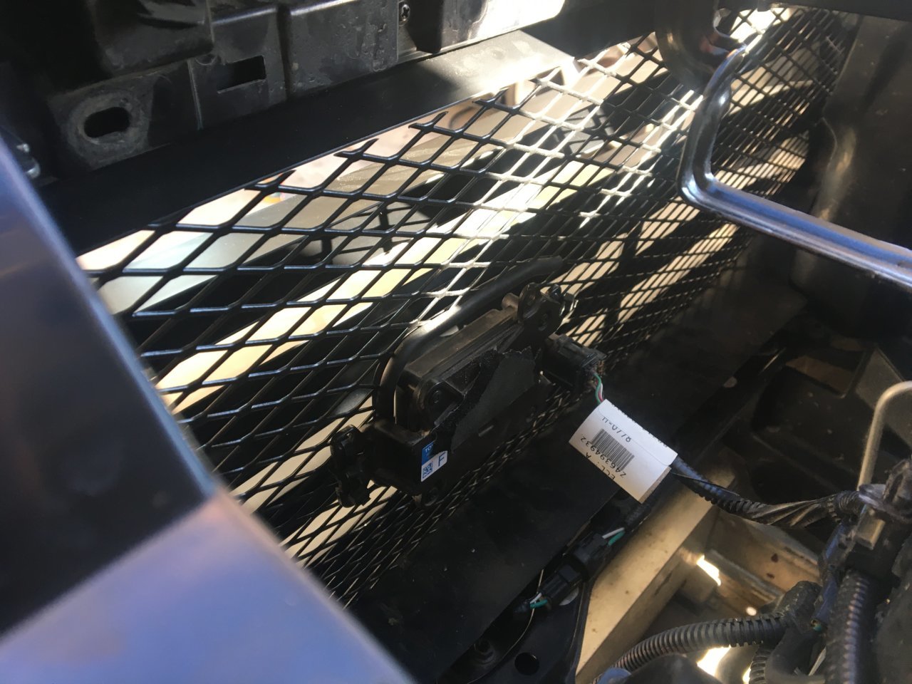

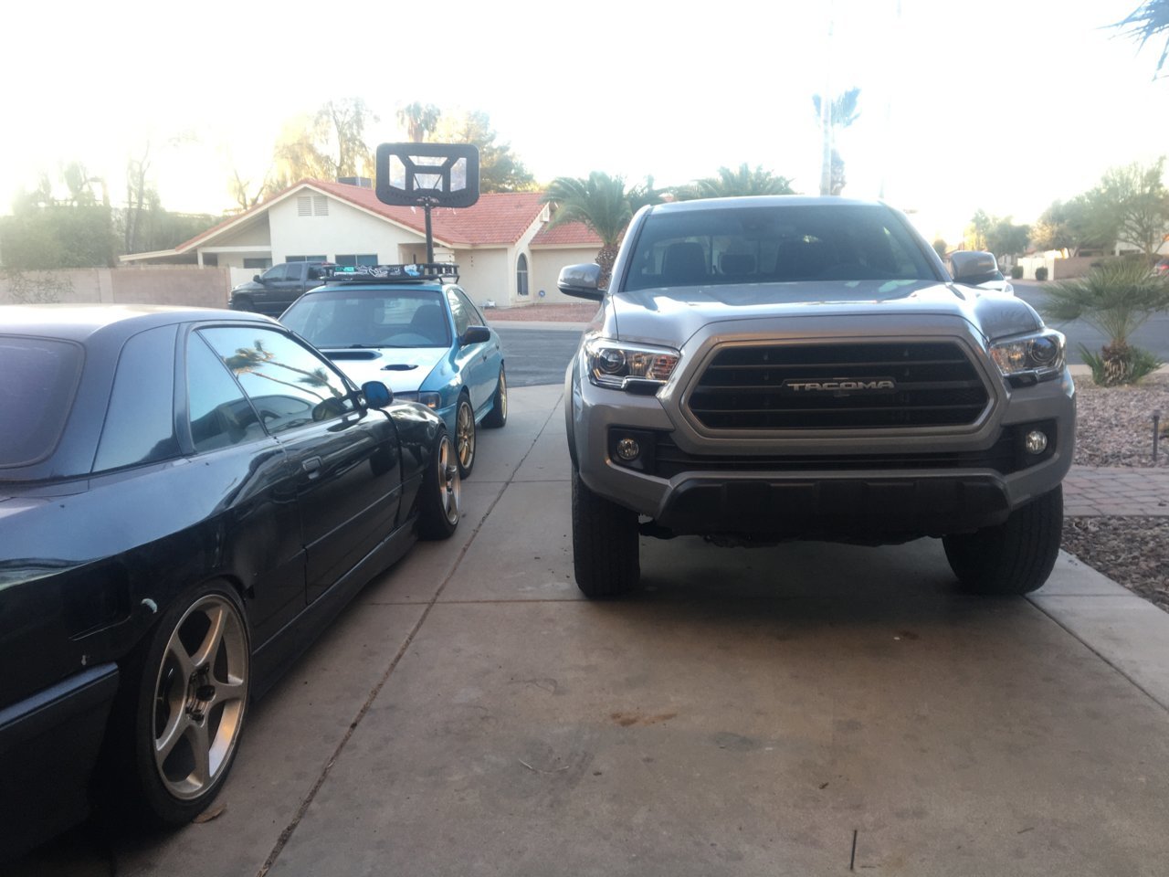

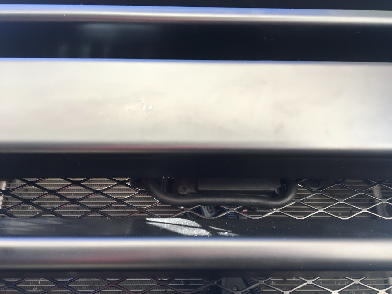

    Howdy....i threw in my grill recently n thought I’d share. First mod lol. I mounted the tss behind the meaty part of the outer grill using the inner mesh by cutting a square in the mesh. Hopefully that is protection enough? i was gonna bolt it, but zipties seem quite sufficient. It hasn’t missed a beat. Also painted the chrome bezel to match the cement.
    41A22089-1D37-456D-AA83-237D97105300.jpg And after playing with different badges, I think I’m likin the no badge ‍♀️ Nice thing is being able to change it up whenever
