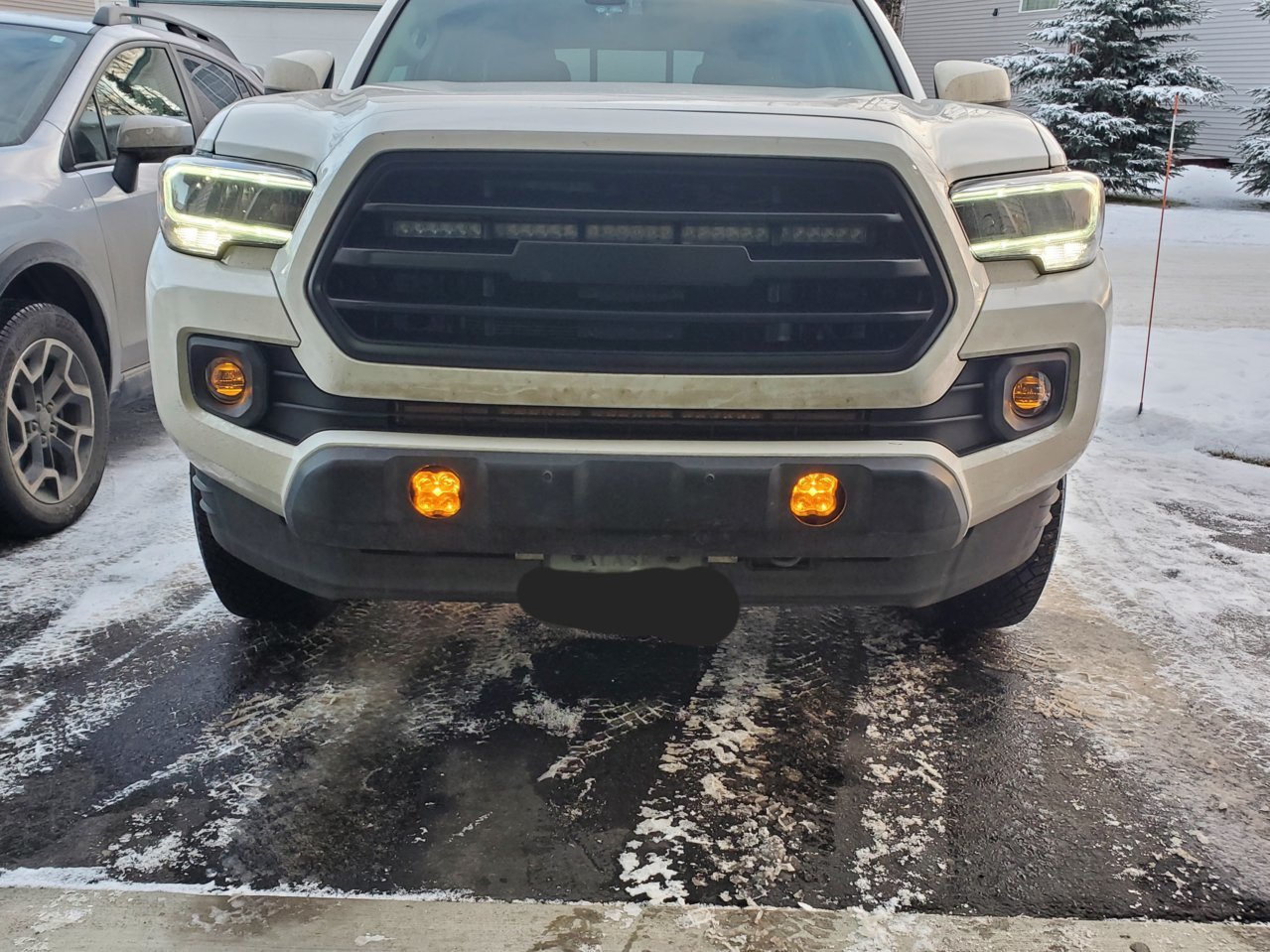

    @watkins303 thanks for hooking me up and shipping to Alaska. Still some tweaking to do on light placement but the xtrek looks great.

    That looks great! Did you have the light installed with the previous grille?

    Previously I just had the white lightbar in the lower grille slot. I used the SDHQ mount with additional brackets to move it up top. I added the SS3 pods in the bumper and the amber lightbar below at the same time.

    I’m really considering this grille and have the Caliraised behind the grille light. I’m wondering if that would still be functional. I’m assuming so.

    I can measure the openings if you want. This is the DD ss30 which is pretty slim, the lense itself is only 1" or so tall.
