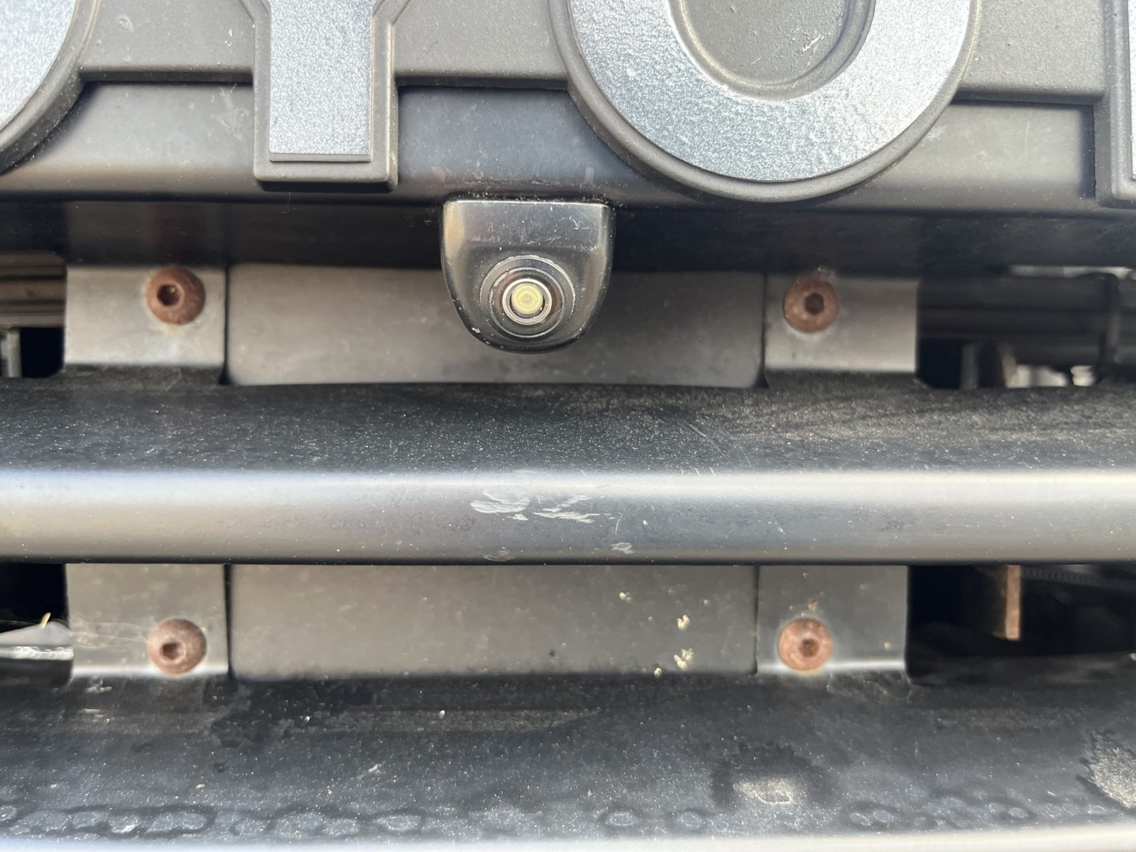

    Don’t know about the 360 camera but I’ve got an aftermarket one IMG_1485.jpglike I’ve said before don’t use this hardware…

    Yea the hardware for the TSS started to rust on mine. I replaced all the hardware with stainless. Also gave those 4 exposed bolts 2 coats of paint/primer to maintain the look.

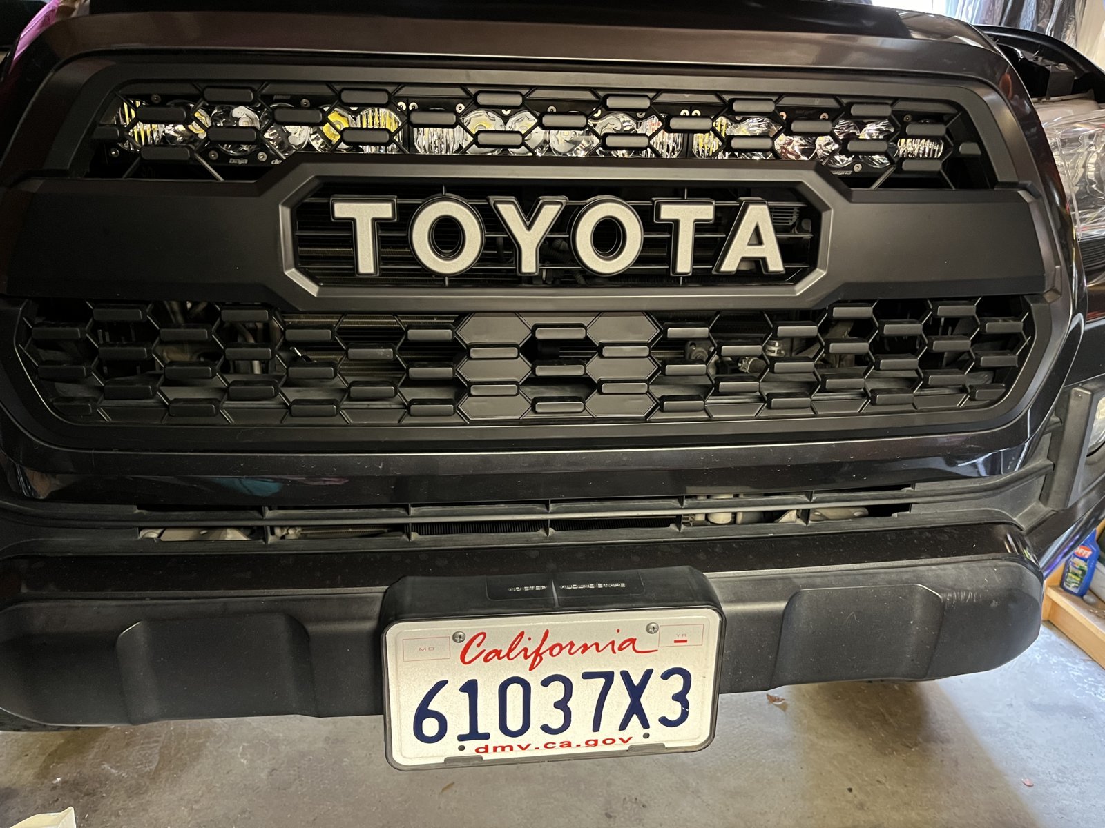

    Does anyone run a 30” Onx6 light bar behind this grille?
    I currently have the TRD Pro knockoff version with the SDHQ dual mount and Onx6 30” that I’m looking to keep running but I’m not sure the openings on the X-Trek line up very well with the SDHQ mounting points. From eyeballing it, it looks close but hard to say for sure. Also a little concerned that since this grille doesn’t stick out as far as the Pro knockoff if I’ll have enough room to mount this particular light bar since the Onx6 requires a little more depth than the average light bar. I have a 2016 so no front sensor to worry about being in the way for the lower opening.

    That’s where I started too, but I never had the onyx it this grill o

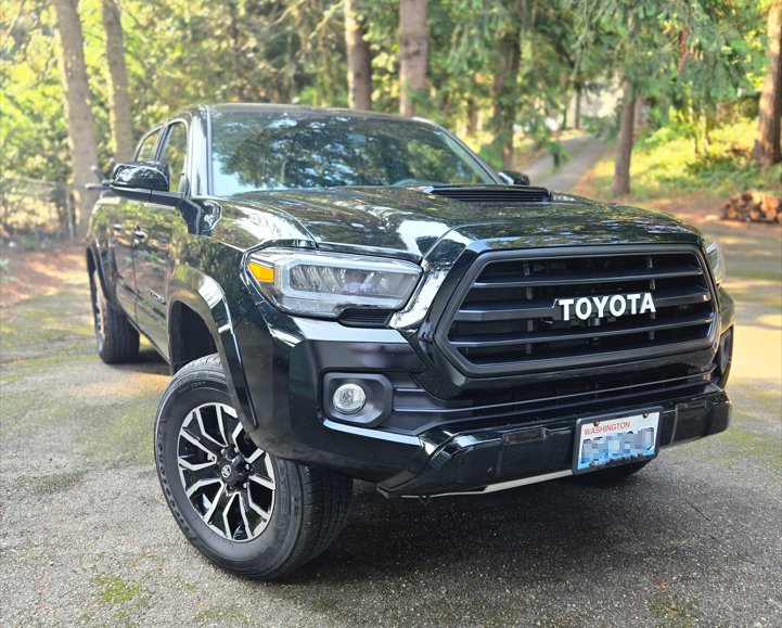

    I recently bought a used X-Trek, along with the chrome trim, relocation bracket, and Toyota emblem. Took my time sanding/priming/painting the chrome piece and I think it came out pretty decent.
    Disconnected battery before starting install and (so far) had a few minor issues with TSS. Suddenly turns off cruise control and warns to clean sensor, then warning stops. Happens infrequently, so I'm going to drive it as is for a while and see if the warnings stop on their own.

    I drove mine for a while and it told me I had sensor problems. Made sure it was tight and secured. After a little bit I forgot and it stopped. TSS works on it. I have had real world moments when it told me to brake. It doesn’t happen often for me, I tend to keep my distance from people.

    Drove it again tonight and no issues at all

    Same here—stainless is the way to go. Changed to stainless after the originals caught some surface rust and haven’t had any issues for over a year now.
    It isn’t as purty as all black but now I don’t have to be concerned about rust.
