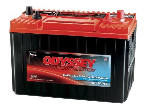

    I've been researching a group 31 battery upgrade for my '12 TRD Sport. I like the simplicity of a single battery system. I've decided that if I got this route, the Odyssey PC2150 battery (likely the ST-M - http://www.odysseybatteries.com/batteries/pc2150_series.htm) is the battery I want.
    I know I will need a new mounting bracket to securely fit this behemoth (http://www.pelfreybilt.com/_p/prd1/3494213141/product/2005+-battery-cage), but my main concern is the OEM alternator's ability to charge the PC2150. During my research I ran across this thread and it raised some concerns:
    https://www.tacomaworld.com/threads/diehard-platinum-31m-odyssey-31m-pc2150-charge-issues.401151/
    That being said, I am very interested to hear the long term (at least one year +) experience of second gen owners who have swapped in an Odyssey PC2150. Have you encountered a similar experience to the above thread - mainly charging issues?

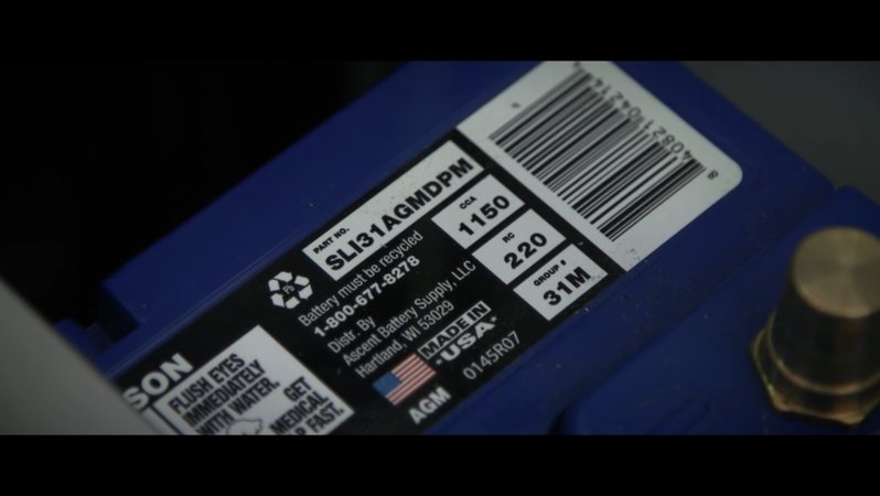

    An update.
    The PB Battery Cage is on back order (even though their webpage states "In Stock", but I digress...). I spoke with Mike from PB and he stated that there is a ETA of 1-2 weeks, so at this point I'm waiting for the cage to arrive so I can mount the X2Power Group 31 and test everything out.
    Once the cage is in and I have everything buttoned up, I'll reply to the thread and add an update (user experience) periodically over the life of the battery - as long as I own the truck.
    For clarity, here is a stock photo and the storefront webpage of the X2Power Group 31 (SLI31AGMDPM) marine variant:
    https://www.batteriesplus.com/battery/marine-and-boat/deep-cycle/bci-group-31m/sli31agmdpm

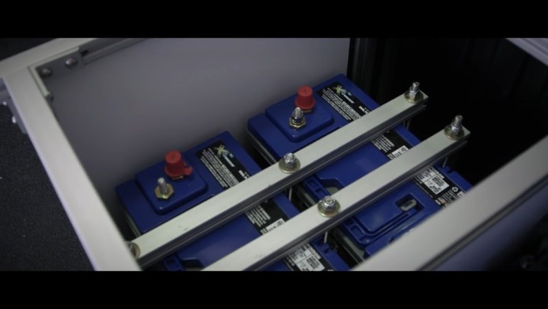

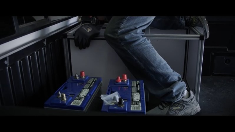

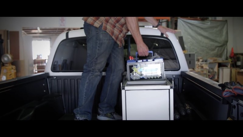

    I'd also like to add that I recently watched the "Power Management" video from Expedition Overland's 2016 Tacoma build video series. They installed two SLI31AGMDPMs in the bed of their '16 Tacoma to feed the team's electrical requirements. I didn't hear the brand or model mentioned at all in the narration - so it sounds like the batteries were not supplied for free from a sponsor (no shout out or plug that you'll hear in the rest of these videos when mentioning build components). This leads me to believe that they actually had to buy the batteries and therefore put some thought into the pricepoint/warranty/performance aspects of their battery selection for the build - which I think is a good thing for us regular joes and a great endorsement for this battery.
    Some screenshots:

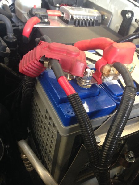

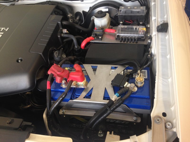

    Here are some photos of the X2Power Group 31 installed in the PB Battery Cage. I'm going to tidy the cables/wires up in the near future, but for now this works.
