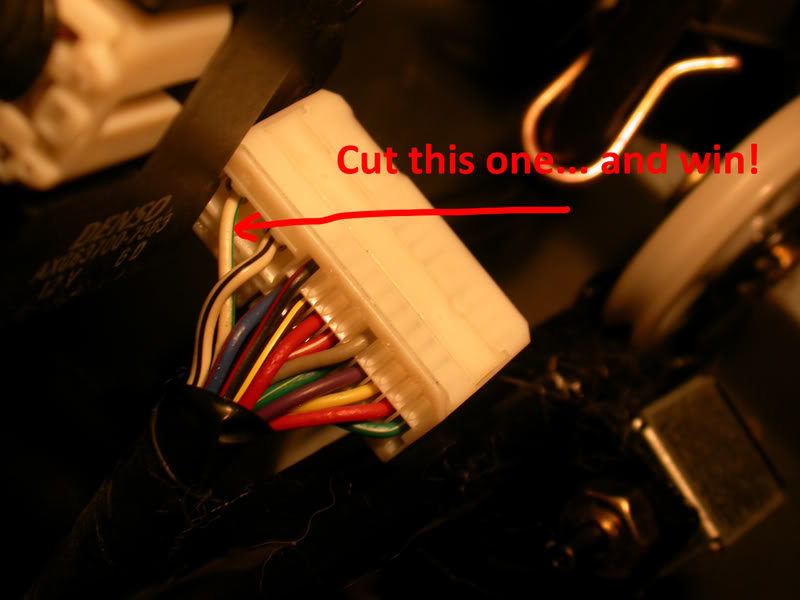

    Hey I am getting the mini morimoto h1 kit with white xb led angel eyes. Has anyone gotten rid of their drls and wired the halos to run all of the time? How would you do this. (2003 toyota tacoma)

    No idea on disabling the DRLs on a 1st Gen, but you can wire the halos to a relay that's triggered by the ignition (hot in run) to get the halos to run any time the truck is running.

    the harness to disable the drl is on the driver side underneath the dash diagcopy_594f0cb34d2ea53ccf56349ed80efbf22c00d5af.jpg

    ohh and im actually running the xb angel eyes also i just tapped into my parking lights if u wanted the angel eyes to run all the time i suggest running to the ignition or acc power
