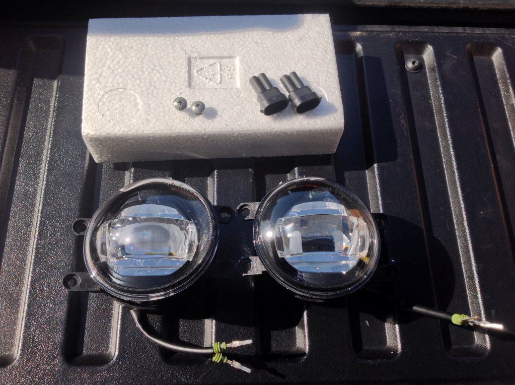

    Contents of said box: Two connectors, two spare screws (I ended up not needing them) and of course, some fancy looking fog lights.
    7b9b16a26a1679c039126c6667db95c0_zps30dd_267b578438f3288a3cd936f4b82cdb34d0511340.jpg

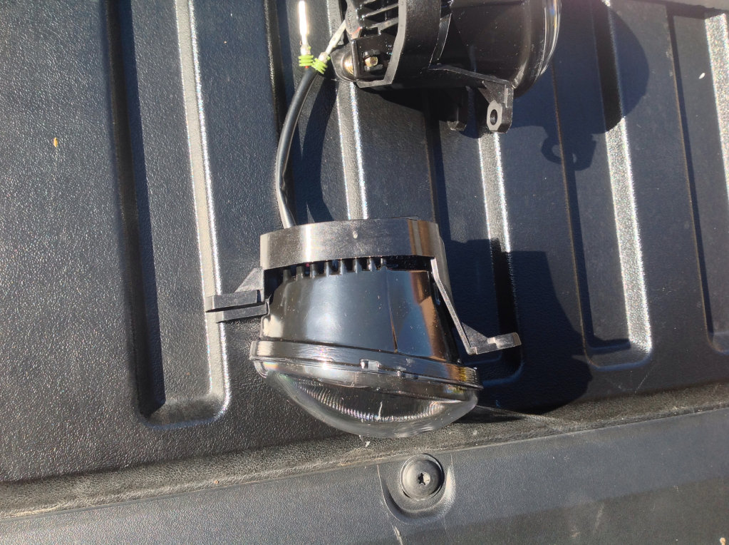

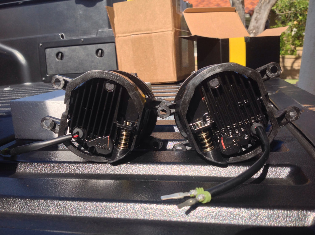

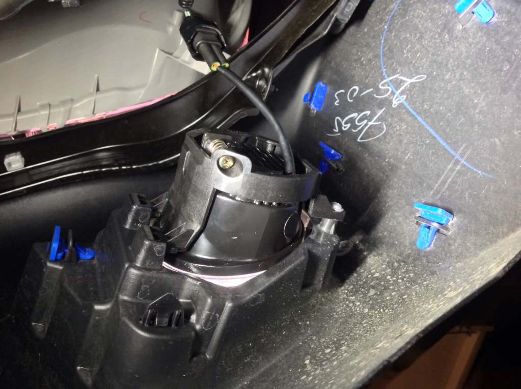

    Backside of the new fog lights. Heat sink built in and you can see the weather proof connectors.
    9da8e4684d781ab3989f2116554303cb_zpsf8d9_a17126b9f2a6a3e0a19f5057b4c577622f53e6a3.jpg

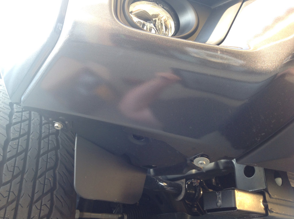

    To start, you need to remove these two screws. You can either use a P2 Phillips screwdriver or a 10MM socket to remove them.
    5fed1b491032261c7128755418485515_zps6a59_75c64c72023ad4b03869f8619578ca57ed048e0b.jpg

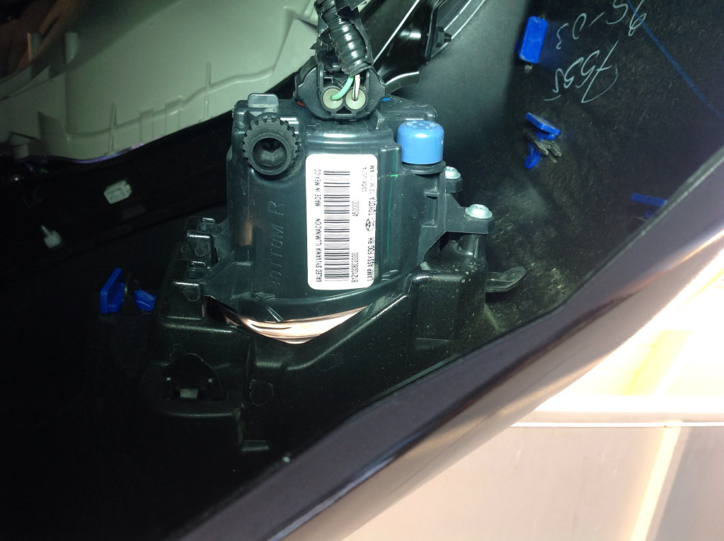

    Once the plastic inner fender is pushed out of the way, this is what you’ll see. The two screws on the one side are what secure the fogs. You’ll need a stubby P2 Phillips head screwdriver to remove them.
    7d575a0bec7ef87f494ee802035ae2a9_zpsc608_8e2a139b5302cc3c3ec055d49fbf0f69cc9f827d.jpg

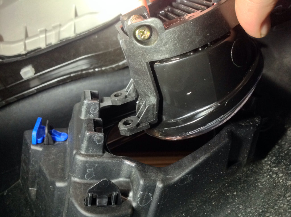

    They simply tilt out.
    aadb53b8b97ede5475d233933ab838f0_zps6ef1_d8dd471d6c79a06aafe6c644a67c4c84c807943f.jpg
    038971ceccaf46832f2525217752105b_zps4c70_6f59a9533157d9817b482bda6882d84c09ba4dcc.jpg

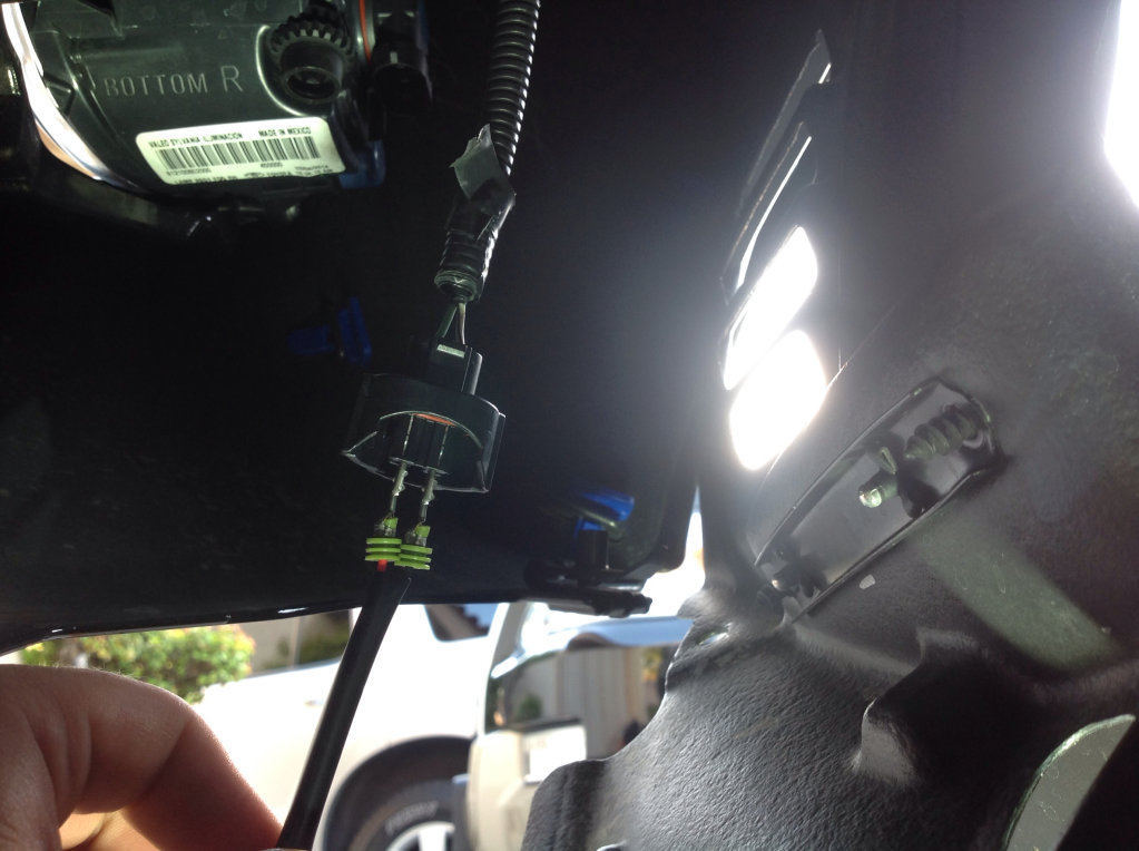

    Now, to hook up the wires, you will want to double check which lead goes in which slot of the factory connector. Simply turn your fog lights on and plug the connectors in to find out which is the positive and which is negative. LEDs will only work one way, so if it works, then you win! If not, simply reverse the two leads and THEN you will win!
    47e0b99d6f8d6575b62ea9f5d0437042_zpsc92e_c4edb45e25750ea39408afd8b5772389c13d8501.jpg

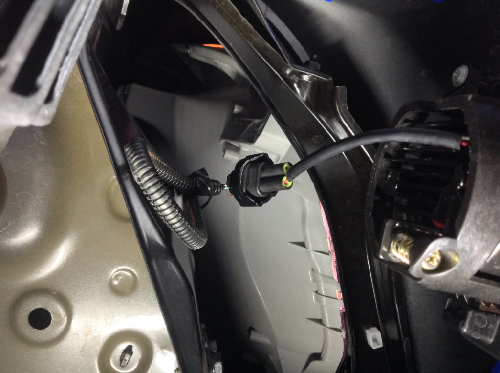

    Now that you’ve discovered which wire goes where, you need to plug them into the connector that TRS provides.
    19a55482bc1e9c7a4a47a8d486dc8653_zpsf945_0564f424c55bb34287ba3ad526ec26e507efc96e.jpg
    Once you have the connectors together, you can safely zip tie the excess wire up and out of the way.

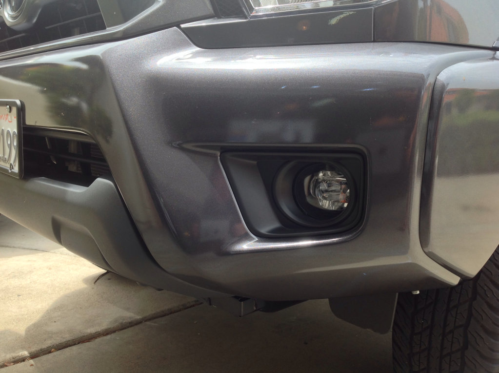

    Here is a comparison of the factory fog light on the left and the XB LED fog light on the right. Yes, the halogen bulb throws more light upwards and all over the place. Not sure how good that is for a fog light.
    a4e554934349c27bfd7800deeb63f7dd_zpsca12_305d3350f7c51e93de049815336d5d0a5db550b6.jpg

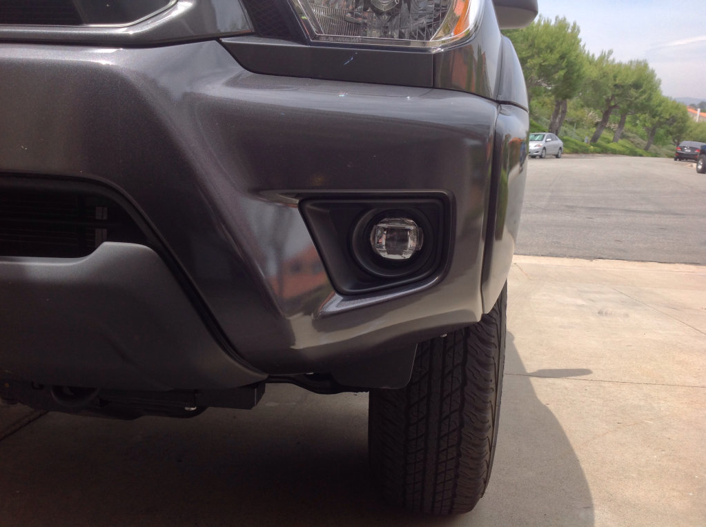

    Here are both of the XB LEDs installed.
    9d9fe89aa34b395e85879b65c7963695_zpsd6f8_fa7b0156061fcd7927f4368e59b3fc67f17eb396.jpg

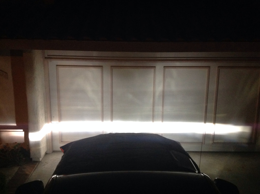

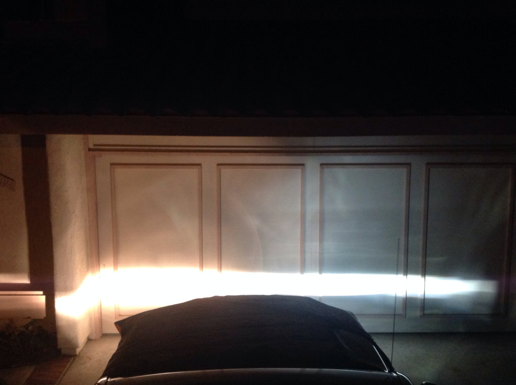

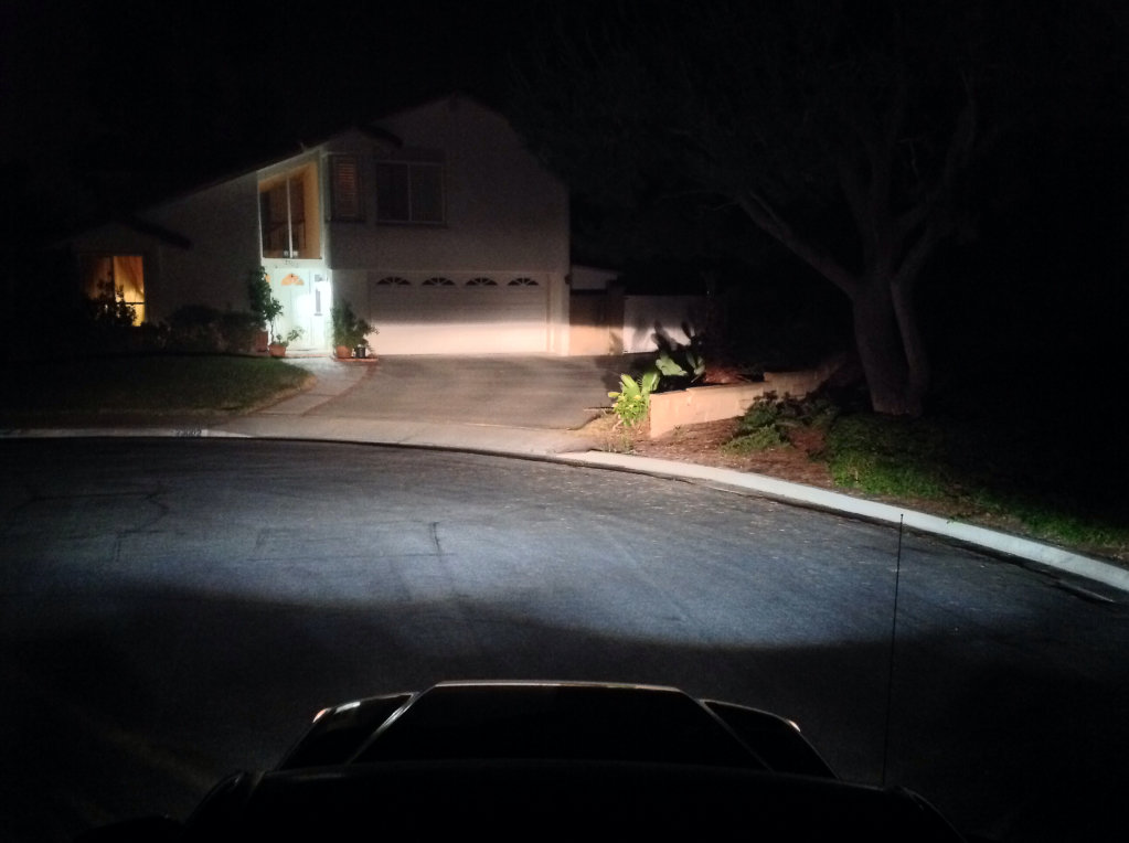

    Low Beam Halogen headlights and no fogs.
    979579ee8f080ca507154155708d8c88_zpsed71_af281f90a659efe31e6cec18a16ec90ae341a8bd.jpg
    Low Beam Halogen headlights plus XB LED fog lights.

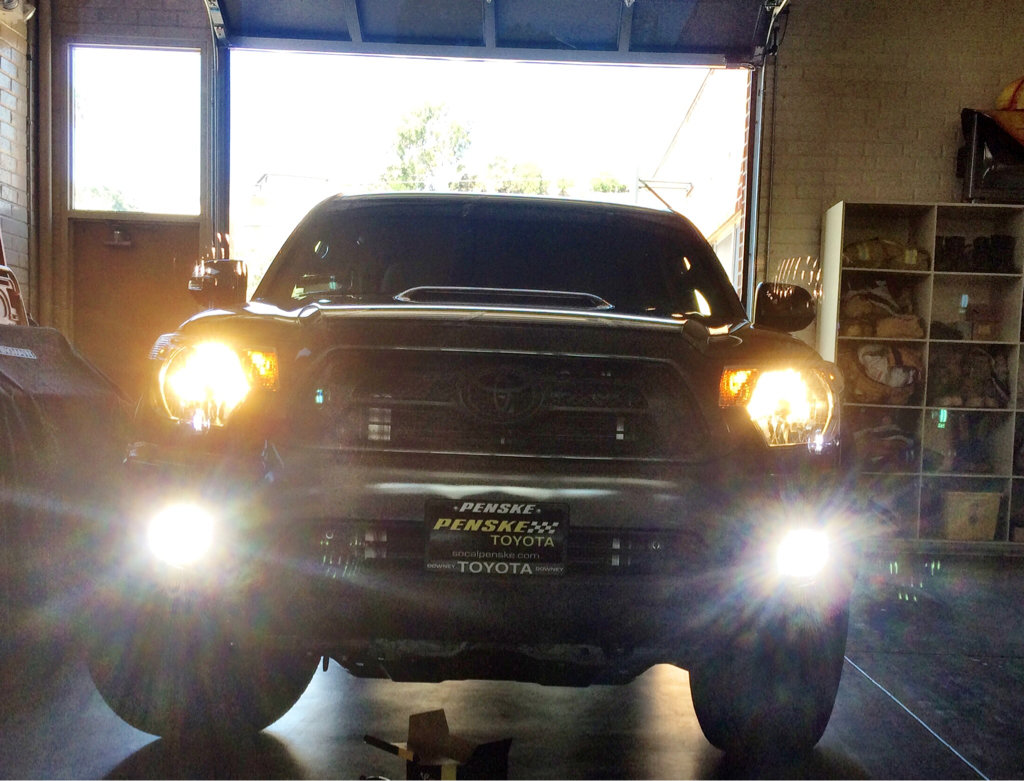

    Adding my XBs today... So easy!!!!
    (Oh yeah that's just my new Miller Elite Welding helmet that arrived when my lights did.)
    So bright... Even more so than the stock headlights! Only took about 15 minutes total install time. Not 2 hours like the box quotes you. Thanks The Retrofit Source!

    How much adjustment was required?

    Hmm, not a whole lot, but I swapped them one at a time and used the stock fogs to line the new ones up.

    Aww crap... Ok well I will do that tomorrow then. I had just swapped them without adjusting... Lol. They were pointed almost straight up.
