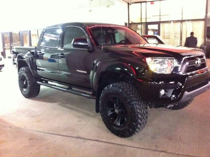

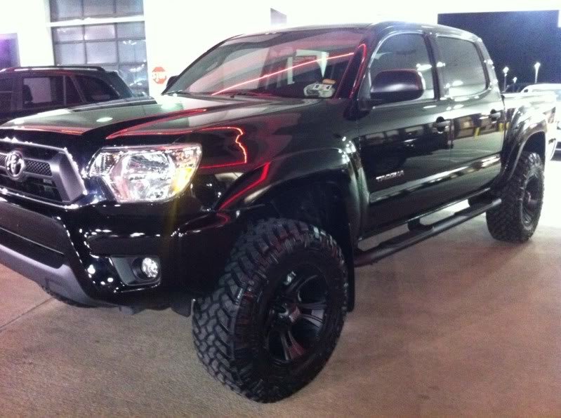

    I have 17x9 XDs and 285x70x17 Trail Grapplers and I had rub on the front plastic flap on the front bumper. You can see the small flap in the photo. It was an easy two bolt removal but made an awful sound when it rubbed on a minor turn. I still will have a slight rub on the front mud flap if I turn the wheel all the way - i will need to shave slightly. I have a 3" lift and I couldn't imagine you making any kind of a turn without a lift and those tires.

    285/70/17 =32.7"
    285/60/18 =31.46"
    OP is looking at 285/60/18
