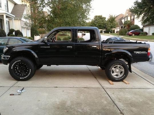

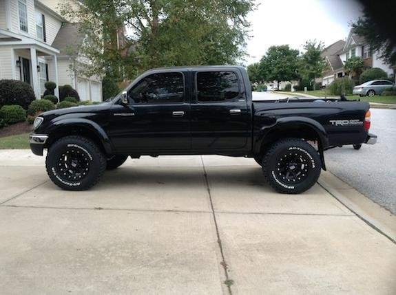

    Pulled the trigger and finally got my setup! 17x9" (-12 backspace) XD addict wheels on 275/70/17 BF Goodrich All-Terrain tires. They measure about 32" but actually look a tad small.
    I did the chevy leaf spring mod and got 3" in the back, and put the adjustable 5100's on the front with stock coils and got closer to 2" in the front. Definitely leaning way to far forward, so I've got to decide whether to bump up to 285's and get longer coils up front, or cut the chevy springs down a bit in the back and stick with the 275's.
    Threw a pic in there showing the size difference between the stock 16" wheels. Seems just a little too small...
