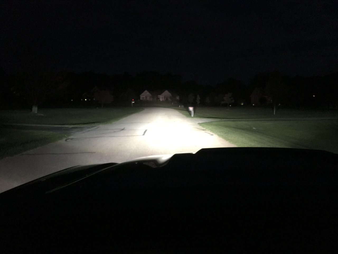

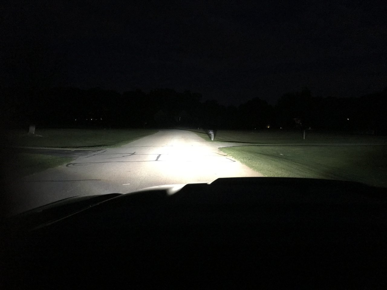

    No streetlight rural subdivision first night drive with the new XD Extreme HID kit.
    Low beam
    With stock high beam
    Add in the stock fog lights.
    Living out here this was a very well spent $160 and 75 minutes of my time.
