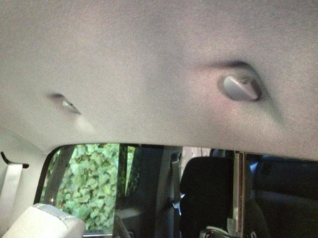

    I am not a fan of XM nor do I like the, #1. Holes in my roof caused by the XM Fin. and #2. The Look of the fin on my roof.
    I did some research to make sure the Fin was only associated with XM then:
    Turned the clothes hooks at the rear of my headlined counter clockwise to remove them.

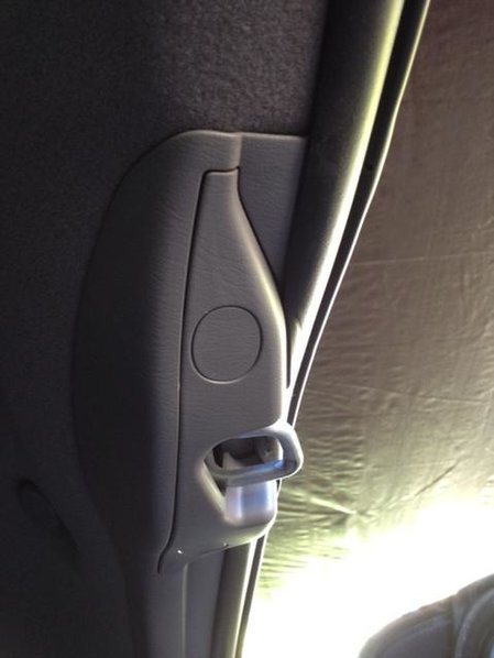

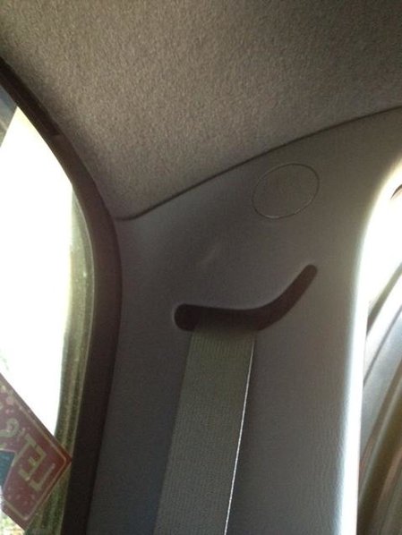

    I then removed the drivers side seat belt trim piece and rear door catch trim piece in order to get the headliner down. I appologize for not taking pics as I went.

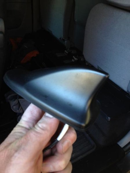

    What are you gonna do with the fin? I'll take it

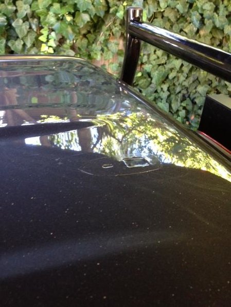

    After fin removal I applied a coulpe of layers of Clearbra materal to seal the hole. I will make a blank plate when I have the time.

    I think I had better keep it for the next owner.

    Could install the Sat antenna from a 2011, they are flat.
    I'm not a big fan of the fin and thought about doing that.

    The rounded antenna housing was changed to a sharkfin in 2012. I thought it also housed the GPS and cellular antennas (for nav and Entune)?

    I took mine off and mounted my 2/70 antenna there
