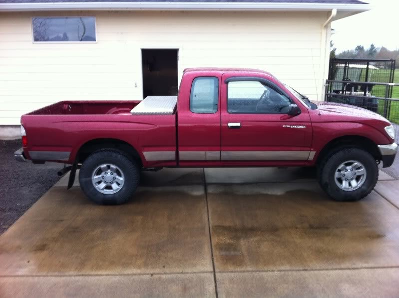

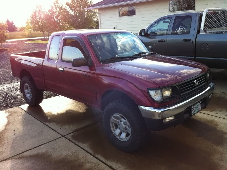

    So this is my 1996 Toyota Tacoma 3.4L V6 that I picked up on February 7, 2011. It was originally purchased to be a commuter to and from the mill I work at, but I fell in love with the darn thing and now I plan to slowly build her up.
    There isn't much done to it yet, but I plan on putting a lot of time and money into her.
    This is the first day i got it, after a fresh bath.

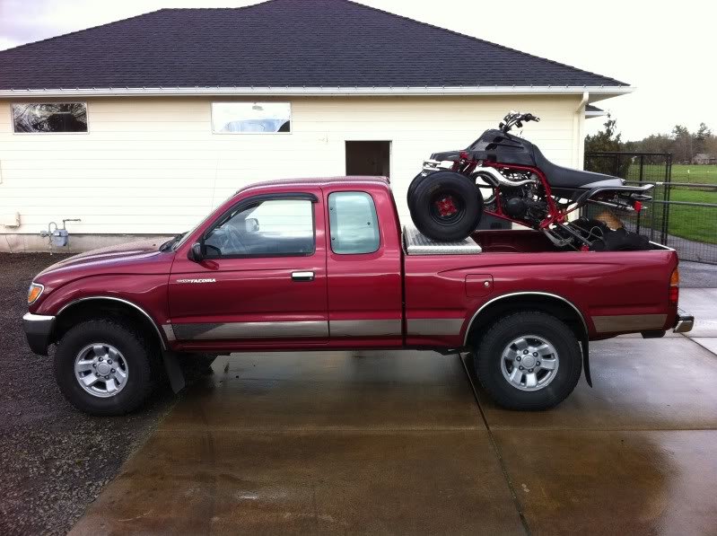

    Messin around, throwing my '04 Banshee in the back.

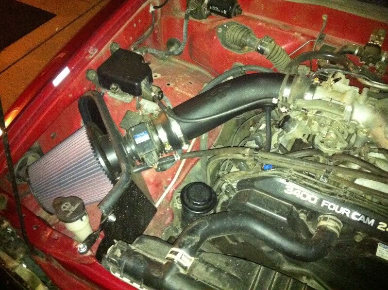

    I drove her like that for a week until my K&N Cold Air Intake came in, then I threw it on there one night after work. I love the sound of it, and you can tell it added some horsepower.

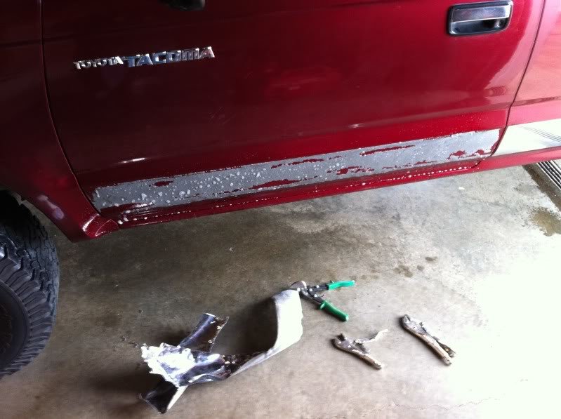

    I got sick of the chrome trim around the fender wells so i ripped that off.

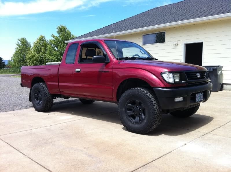

    I've been toying with the idea ever since I got it of getting black wheels on it. Well if I were to do that, those ugly ass chrome strips had to go.
    That was nothing but a pain, but came out pretty good I think.

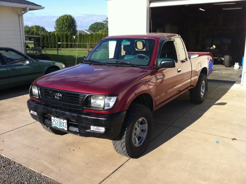

    I decided it was time for my grille to go, I am not a huge chrome fan, I'm all about the black. So I ordered a new grille and installed it, then I had to paint my Corner light frames, I love the look!
    So I got sick of my decals on the tailgate, so i peeled those off.
    Then I decided it was time to continue the process of dechroming the Yota.
    Painted it all black and put it back on.
    It turned out like crap, and now I'm really stepping up the process of finding a nice front bumper.

    i have those same chrome strips on the bottom of the body.
    how hard was it to take those off?

    The strips weren't too bad, just use a heat gun, don't be scared to heat them up, once they are warm, just peel them back. I only heated up about 6 inches at a time, you can't pull it all off at once.
    Once you pull it all off, that damn sticky stuff is gonna be there, use your heat your heat gun again, and I used a little plastic scraper to get it all off. A nice heavy duty one from NAPA. Worked great and didn't ruin my paint.

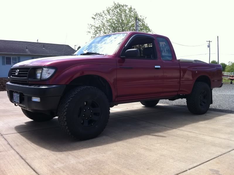

    Got the wheels back, took 'em to my local tire and shop and had them put on and balanced.
    I think they came out great!

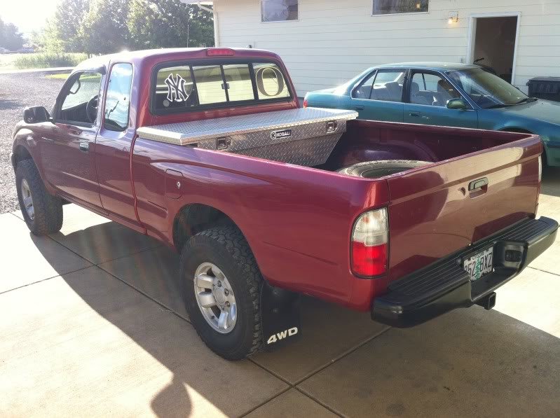

    Plasti-dipped my toolbox cuz I was sick of the chrome!
    I think it came out nice!

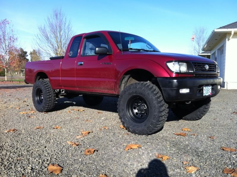

    Got me some new tires and wheels!
    Just some basic cheapo Pro Comp steelies.
    Went with 32x11.5 R15 Goodyear Wrangler MT/R Kevlars cuz I think they look sick as all hell.

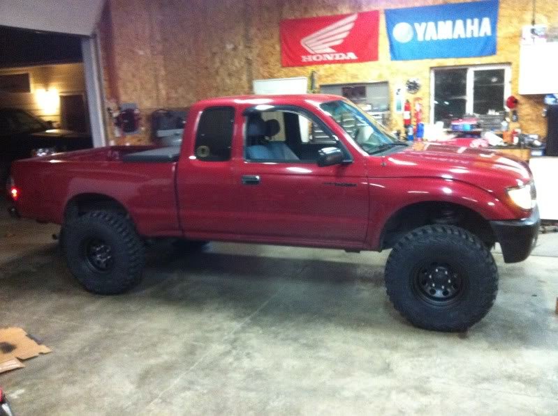

    So I finally installed my lift!
    Rear was easy as pie, had a nightmare gettin the damn billies on the front.
    I ended up putting my lower bolt in backwards, is this okay? Hope so.
    Here is my setup.
    Rear is complete!
    Debated leavin it like this, looks mean. lol
    Front done and lift is complete!
    I think it looks like a totally different truck!
