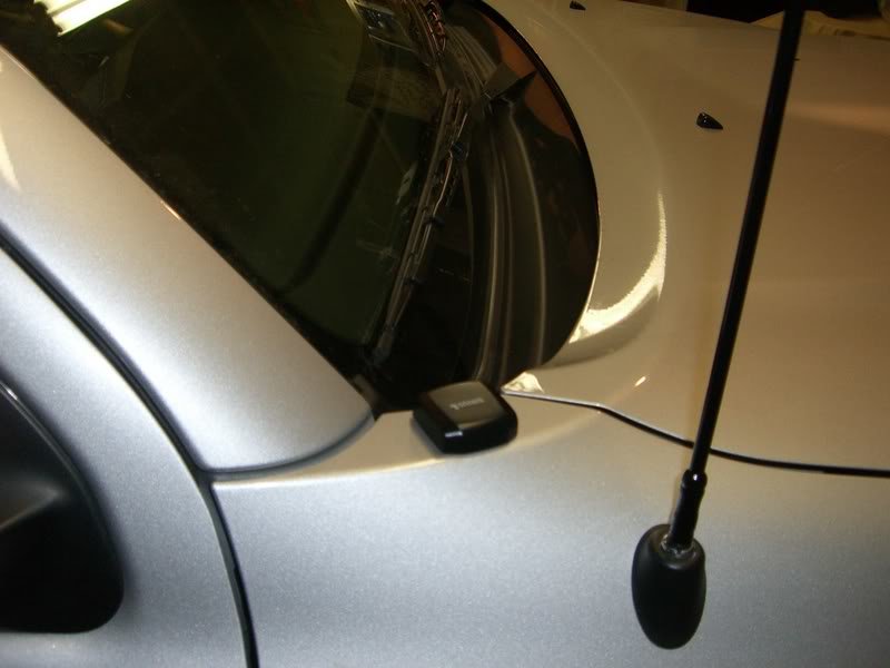

    Put mine next to the am/fm antenna. The reception is great, looks clean, less wire to run and less interior to take apart.

    Ran the wire into the engine bay and along the firewall there is a rubber small plug right behind the interior AC fan...Just push it thru there and into the cab. It's very easy once you take a look at it.

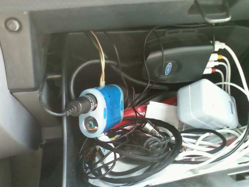

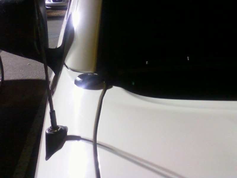

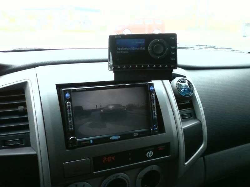

    I followed everybody's suggestion as well too. Works out much better than going through the third brake light. Here are some pics
    Here's the inside placement of the onyX. I ran the wires in between the dashboard and the dash kit behind the car mount. I have the rear camera enabled while driving since I control XM seperately.

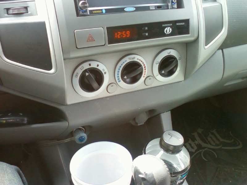

    Power hook up pic from outside, notice the blue plug in cigarette lighter on the left side. Radar detector in small pocket works great from there.
    Little messy, haven't organized wires yet but the blue 4 way cigarette adapter supplies power to my satellite receiver and radar detector

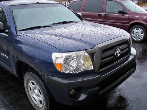

    Mine is mounted in a similar location, but (on my '02 Tacoma) it's underneath the black plastic shroud below the wipers. The antenna is a total stealth install.
    There's a single screw on either side (probably right under where your satellite antenna is). Hit that, lift the plastic, and there's a wire mesh underneath it that the antenna magnet can bond to. And it's a very tight bond, it never moves.
    There's no visible sign of my XM antenna, and the only indication that I have something going on is the coupler that has to go on the AM/FM antenna.
    I can take a picture of the location if anybody needs it.
