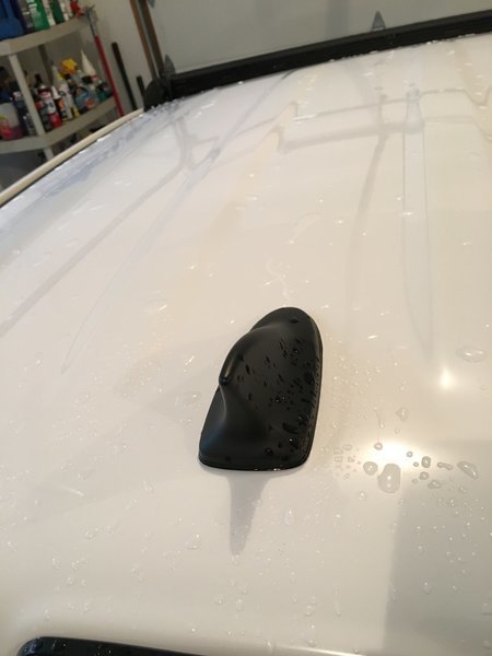

    In case you were wondering how it all came out... I know it's been like 3 months but I finally got around to replacing the antenna. Bought an OEM antenna from Toyota directly for a whopping $550 and put it on myself by pulling down the rear headliner, banging out the dent and installed the new antenna. Paint wise, I just put touch up on the roof where the paint cracked as the antenna covers it up completely...
