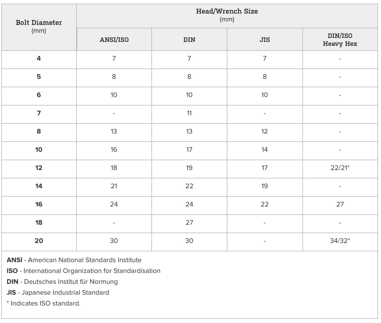

    Toyota follows JIS for their bolt sizes.
    You can make an educated guess based off the head size.
    The difference for JIS and common ANSI you’ll find in most stores is head size.
    JIS uses smaller bolt head sizes compared to ANSI.
    For instance a 8mm diameter JIS bolt will use a 12 wrench.
    Where as a 8mm diameter ANSI bolt uses a 13mm wrench.
