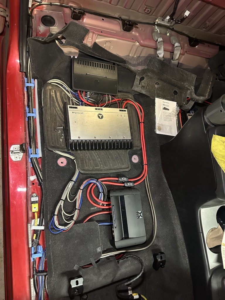

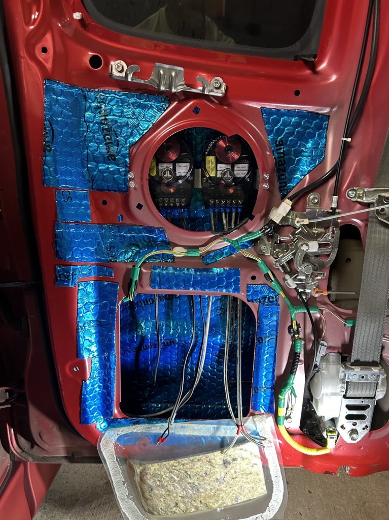

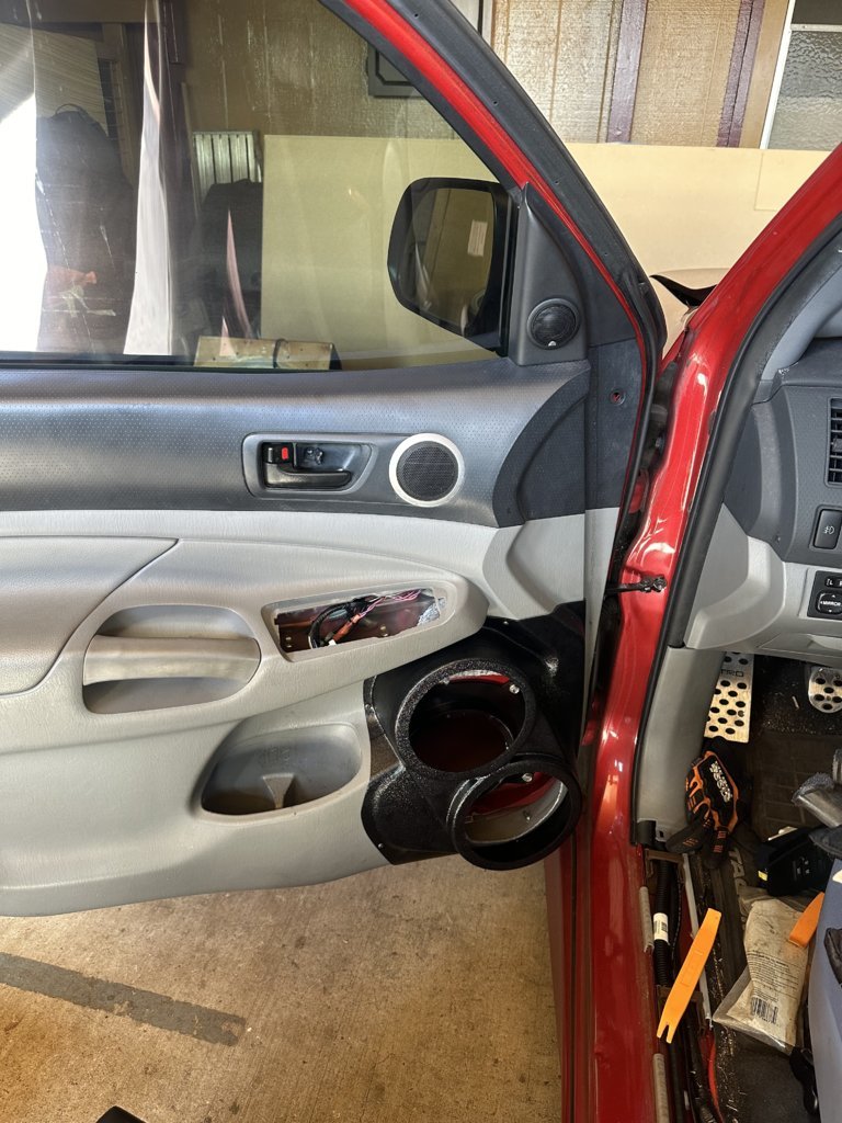

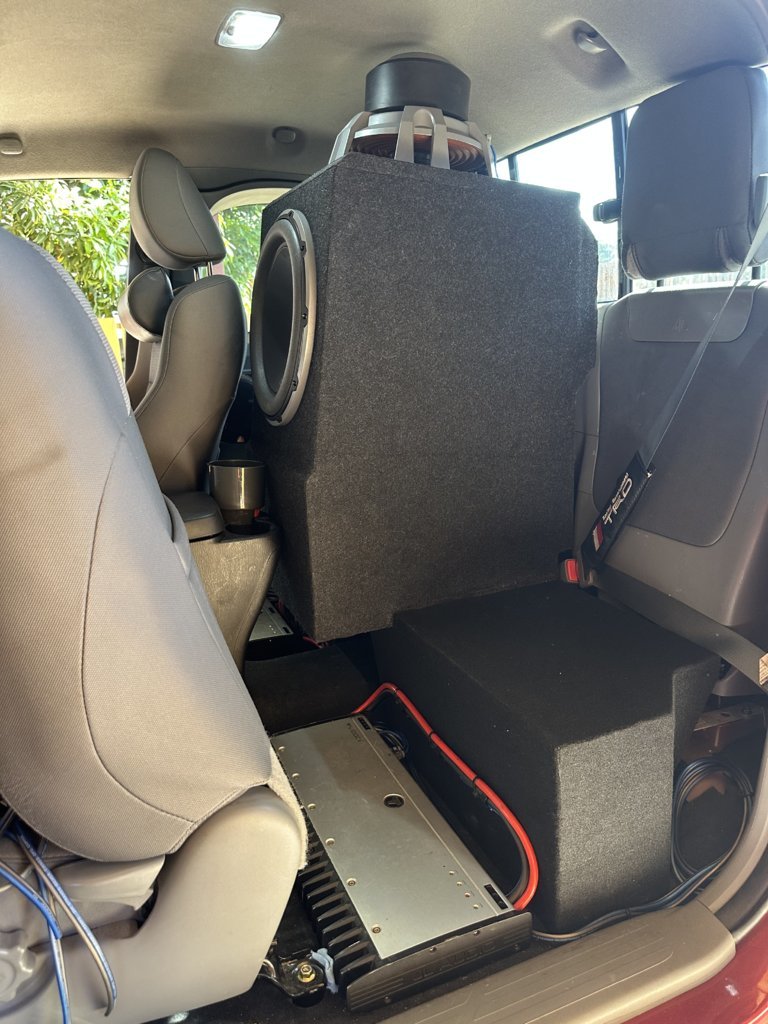

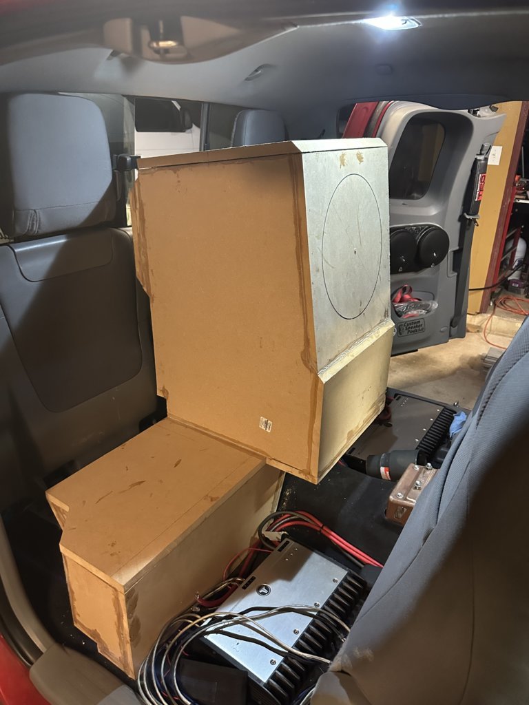

    I had on an isobaric box set up and decided to separate the subs and make a custom box. Needed the doors to keep up as well and sound deaden everything to do it right one time.
    -Sony XAV-AX8000 head unit 8.95” floating LCD screen
    -Kicker (3)KI24 RCA cables
    -JLaudio (2)13w6v2 subwoofer
    -Kicker (2)AFS fuse holders
    -(2)100amp fuses feeding both capacitors
    -NVX (2)mini anl fuse holders
    -(2)40amp fuses feeding both 4 channel amps
    -JLaudio Slash 1000/1v2 class D mono amp
    -JLaudio Slash 300/4v2 class A/B 4 channel amp
    -JLaudio RD400/4 4 channel class D amp
    -JLaudio Evo C3 6.5 (4)pairs of components

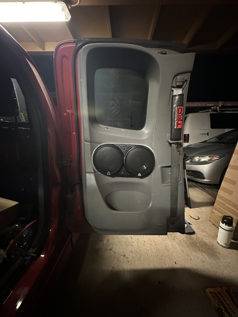

    -Custom Door Pods (2)dual 6.5 front doors
    -Custom Door Pods cut to fit (2)dual 6.5 rear doors
    -NVX (2) XCAP10H True 10 Farad Stiffening Hybrid Capacitors
    -OFC 4 gauge power and ground wires
    Electrical:
    -130amp high output alternator
    -Voltage Booster Pro SPARK (high setting 14.8v)
    -Recoil 1/0 OFC big 4 wire upgrade (alternator, engine block, body, frame)

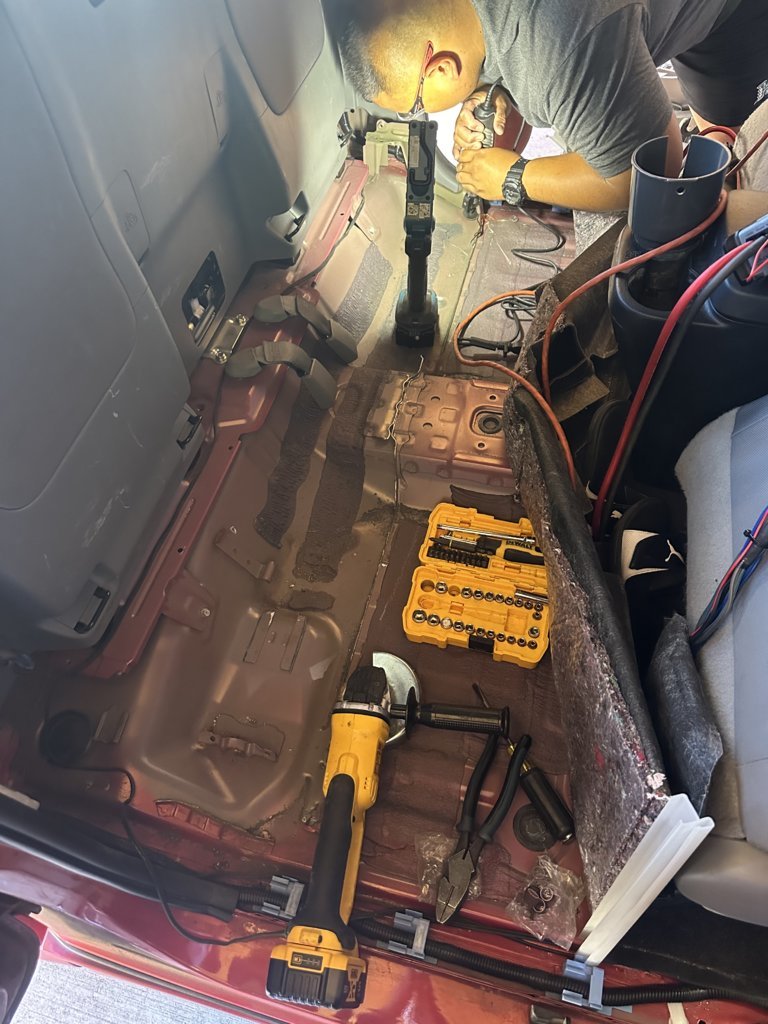

    Yea it took me 3 months to complete the entire system of course only on my free time. Designed and installed everything myself.
    I actually tried to reach out to fabricators out here but with no interest in doing the system I’ve always wanted. But it was well worth the hard ache lol

    Looks great man, was door rattle a problem at lower volumes? (Obviously when the volume is high everything rattles) I only ask because some frequencies make mine rattle and I’ve been trying to eliminate it
    Xmplry808[QUOTED][OP] likes this.
  8. Jan 20, 2025 at 4:25 PM
    Xmplry808
    Xmplry808 [OP] Well-Known Member
    May 23, 2018
    #254333
    145
    2015 BRM Tacoma xrunner
    Engine: -Doug thorely long tube headers -URD dual O2 simulator -Dual 2.5” QTP cut outs -RADS true dual piping -TRD supercharger MP90 -Custom air duct -K&N cold air intake -AFE tb adapter -AFE 76mm throttle body -URD 2.7 supercharger pulley -URD fuel pump/Aeromotive 340 upgrade -URD extension harness -URD maf calibrator w/map sensor -URD 170 thermostat -URD speed unlimiter -Cusco oil catch can -URD fuel rail tap -FPR mod -COUPE oil pan spacer w/baffle -NX wet nitrous kit 50 shot -NX 10 lb bottle -NX purge kit -ZEX rapid fire module -Greddy oil filter relocation adapter -Mishimoto oil cooler -HKS big 3 wire upgrade -Pulley wrap mod Electrical -130amp alternator -Voltage Booster Pro SPARK -Optima yellow top group 27 -1/0 wire upgrade Drivetrain: -B&M short shifter -Detroit tru trac LSD -Competition Clutch stage 4/6 puck clutch kit -Competition Clutch lighten flywheel -URD throw out bearing/sleeve kit -Sprint booster V3 -Remove clutch accumulator Suspension: -Djm front A arms -Djm welded in frame notch -DJM offset bushings -XII Performance front coilovers -XII Performance sway bars Fronts 1 3/8” Rear 1 1/16” -4" Custom Taco drop blocks -QA1 rear shocks -Air Lift air bags -Air compressor -Alignment Cam Gussets -UMI billet front sway bar mounts 1 3/8 Wheels/tires: -HRE wheels 540 step lip Front 20x10 255/35/20 Rear 20x11 305/30/20 Brakes: -Performance Brake Unlimited BBK -4 piston Tundra calipers -360mm ISF drilled brembo rotors -Stop tech stainless steel brake hoses -Brembo brake pads Exterior: -35% ceramic front window tint -Hood spacers 1" -Cut front grill -Cut hood scoop -Strictly Street RACE spec spoiler -Race front and rear tow hooks -Diode Dynamic SS3 yellow pro fogs -Race Louvers Front RSF fender trim Rear FL fender trim Interior: -Lotek dual gauge pillar pods -Ultra gauge Mx 1.3 -TRD shift knob -JunctionProduce pillow cushions (4) -Bellezza leather neck pads (2) -Innovation gauge dual wide band -Innovation boost gauge w/shift light -Air lift dual air pressure gauge -TRD racing pedals -LED lighting Sounds: -Sony XAV-AX8000 -JLaudio (2)13w6v2 subwoofer in isobaric ported box 33hz -JLaudio 1000/1 mono amp -JLaudio Evo C3 6.5 (4)co-axles -JLaudio 300/4 4 ch. amp
    The door doesn’t produce any rattling noise. I sound deaden the doors and honestly my friend pointed it out and it wasn’t my intention but I built the box so close to the doors that just adding the carpet is against the door pockets that may be helping reduce the rattling.
